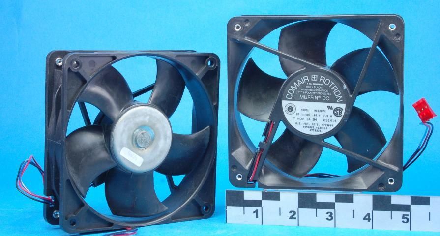

TIA. I have a great sounding Altec 9440A. The problem is the cooling fans are noisy. I can unplug the fans at the back of the amp but then it gets hot. I'd like to attenuate the speed of the fans to the minimum required for the given load. Is there a control I can install that won't introduce it's own noise into the amp?

The oem fans plug in to the switched output on the back of the amp. They are 120v. I just want to slow them down manually with a suitable attenuator. Nothing fancy. Would a 120v dimmer introduce noise?Something linear. Not Pulse Width Controlled, but plain stupid analogue.

According to the fan kit manual, these fan seem to be AC jobs, simply plugged into the amplifier's switched outlets. Not likely to be controllable very well.
I suggest going with an external 12 V supply and a set of computer DC fans of the right dimensions (looks like 120 mm). While the usual suspects do make temperature controlled fans with thermistors attached, it may be easier to use an external fan controller (for DC-controlled fans, I don't think they make them for PWM fans but might be wrong).

All that … just barely overlooking the obvious … new fans of the ultra-quiet type! Almost surprisingly, most fans come in very standard sizes. So, hunt out the ultra-quiet type.
From a 2 second Google search: https://www.amazon.com/AC-Infinity-Cooling-Ventilation-Projects/dp/B009OWVUJ0
Probably not a good fit. BUT it was a 2 second search. The words “muffin fan” are key, since they've long been generically known as that. Kind of like how nose-napkins are known as kleenex, photocopies as xeroxes, and real estate agents as realtors.

I just placed an order for the fan speed controller also listed. The one available on the .ca site comes with dual connections. Perfect. Low, Med, High. We'll see. It's worth a try at 23.00All that … just barely overlooking the obvious … new fans of the ultra-quiet type! Almost surprisingly, most fans come in very standard sizes. So, hunt out the ultra-quiet type.

Noctua, Nordic Cooling, BeSilent - all very interesting options in terms of low-noise fans.
You may also look for the Low-RPM versions of some of these products, because lower RPM at 12VDC usually means less noise during nominal operation.
And this can obviously be regulated "down" with the controller thing, which you could in plain vanilla version purchase also from the distributor of such PC fans.
I would seek the versions with a "potentiometer", and then try to replace the potentiometer with a termistor of sorts.

Okay, I received the controller, hooked it up. It has a variable speed dial with infinite control from min to max. Set to min, I can still hear the fans but very acceptably. I sit 10ft. away from the amp set between the speakers. I cannot hear them with music, even quiet passages. The heat sinks stay under 100F.All that … just barely overlooking the obvious … new fans of the ultra-quiet type! Almost surprisingly, most fans come in very standard sizes. So, hunt out the ultra-quiet type.

Just an update. I purchased a pair of muffin fans at my local surplus store for $10 each, same size, to see if I can quiet it down even more. Well these are so quiet with the control turned to min that I cannot hear them hovering right over the amp. But the heat sinks still stay at around 100F even when the amp is pushed hard. The fan shroud is an enclosure with slots top and bottom. The fins on the sinks are rather minimal and a bit short imo. This could explain why it gets hot without the fans but it seems if they would have just incorporated adequate sinks, the fans would not be needed at all. Strange.
Turning up the volume as loud as my ears can stand, I have to speed up the fans a bit but I still cannot hear them at my listening position. So this system is more than adequate. I'm using it with a pair of Acoustat Model 3 which I think have a working impedance of 4 ohms; not sure though> even when the amp is pushed hard.
