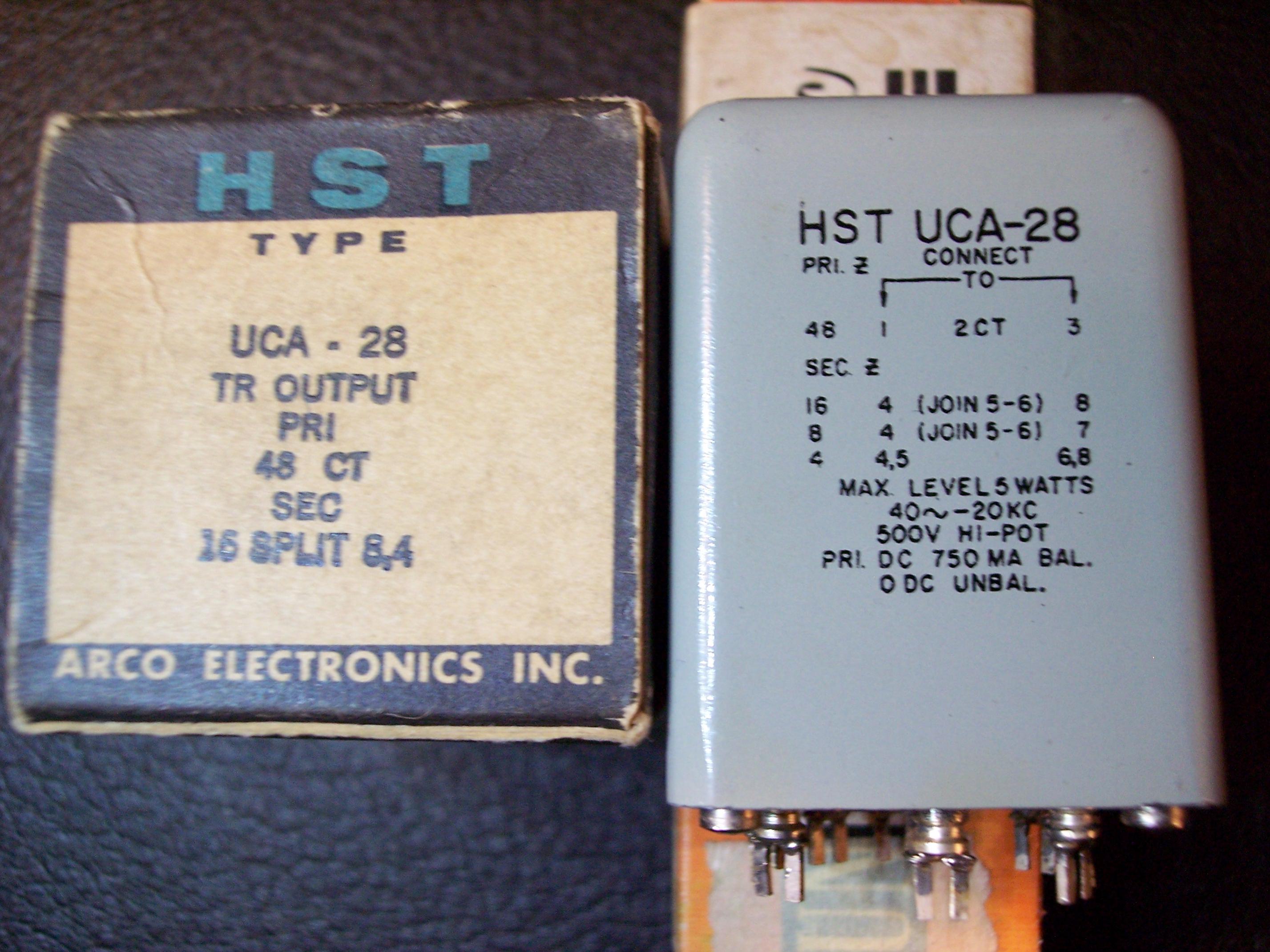

I found a pair of these HST output transformers in my junk bin. I normally build tube audio equipment, I am not as familiar with solid state designs from scratch.
Curious if anyone would know a good pair of transistors which would be a good consideration with the 48 ohm pp primary impedence of these transformers? I want to experiment with these in order to achieve 3-5 watts output.

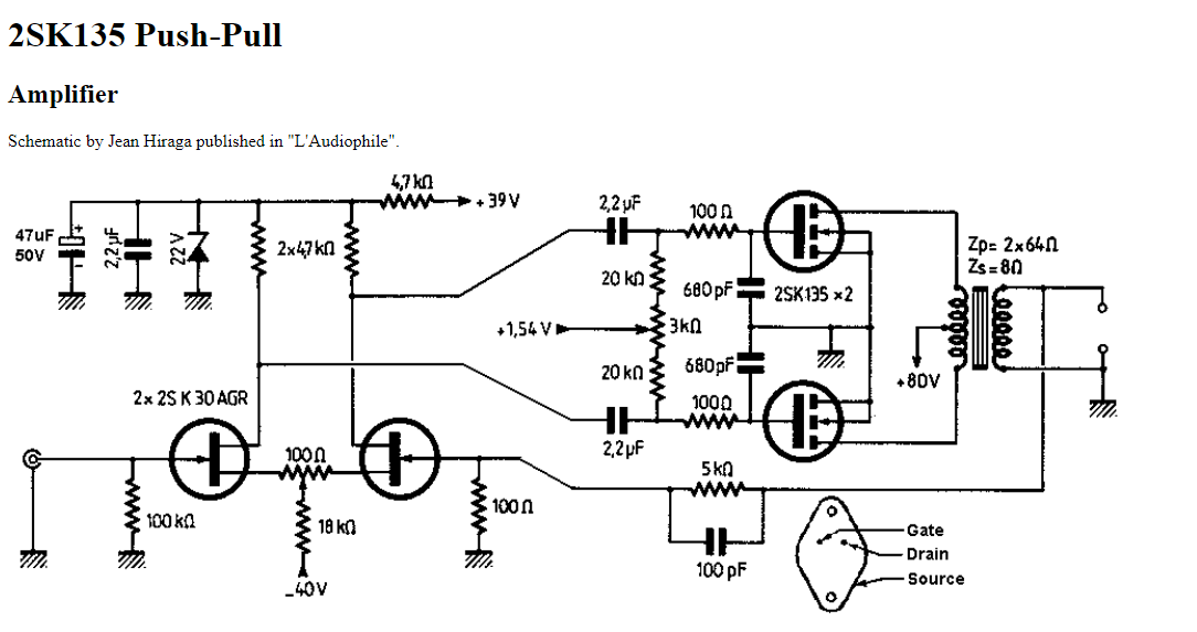

Both Nelson Pass and Jean Hiraga (L'Audiophile) had at one time transistor/FET amplifiers that used a nominally 60 ohms primary. It's an interesting exercise to design a transistor amp with a bit higher supply voltage and lower current, transformed down to 8 or 4 ohm level.
But the 5W capability is a bit limited. Maybe a headphone amp?

Can you write the stresses? 48rCT 5W? The battery will be about 12V. The peak collector voltage is 24V. Peak collector current is 0.91A. In class B the dissipation is <3W so 1.5W per device. In class A the dissipation is >10W so 5W per device.
But the pri bal DC in A is also 0.91 Amps but the can says 0.75A. I guess it could do 3W in A at 9V 0.75A supply. (In those days we "never" used two devices in A because they would run so much cooler in B.)

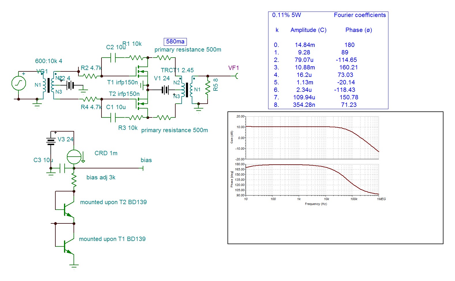

And i have heard a couple diy amps that use big triodes to drive MOSFETS (running at very high voltages) thru some custom Onetics OPTs. One of the best amps i have ever heard.

Not sure which schematics you searched, but the transformer shown SCREAMS mid 60´sWhy is that? None of the schematics for such amps I've seen had driver xformers. Although you can use them - just another design decision.

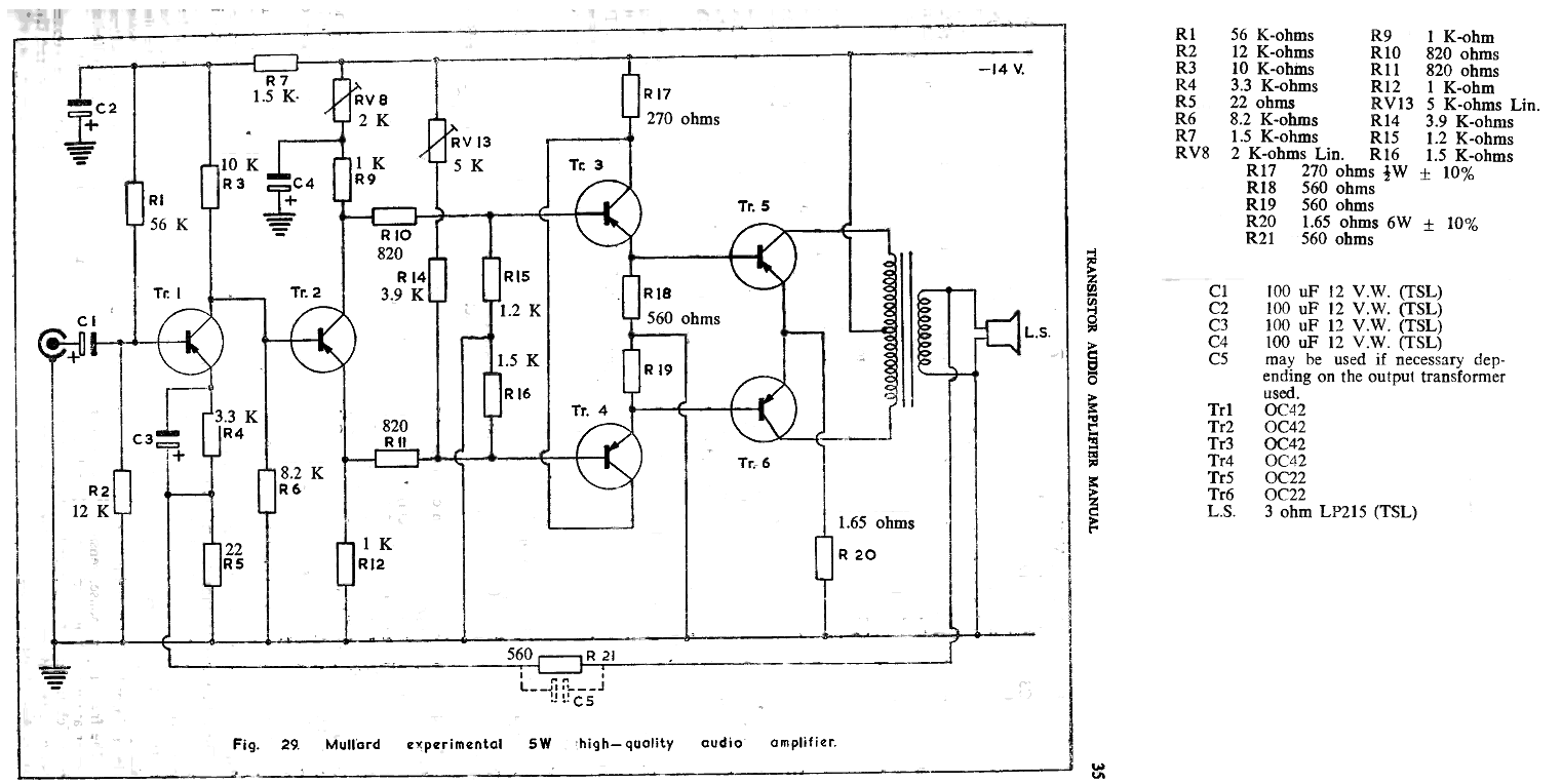

Basically this, with proper values for 48 ohm CC impedance and 5W RMS output.
Let´s do a little Math to see if it applies to my suggestion (my memory, really, I grew in that era
48 ohm CC so 12 ohm Collector load in a PP and 5W RMS mean 10W peak so:
Peak V= Sqrt(W*Z)=Sqrt(10W*12V)=Sqrt120=11,95Vpk which beautifully matches 12V supply.
So that transformer was designed in the 60´s for a 5W RMS amplifier fed from a 12V supply .... a very interesting and modern project ... way back then.
Which in the 60´s would have used PNP Germanium transistors and a driver transformer, in a basic configuration very similar to my example.
By the way it´s a Mullard example and shows the way things were done in early 60's.

Found ERA Correct Circuit...
After nearly giving up searching month after month, I finally found a circuit that exactly matched the criteria and specifications of the correct ERA for these transformers.
I was hoping for a Class A circuit and it does exist!
It is a Mullard design.

Incredible.
Not sure anybody actually made such amps, it was beyond weird , Mullard itself labels it "experimental".
Standard was way closer to what´s shown in page 39 of the same book. (a transformer driven Push Pull OT amplifier).
