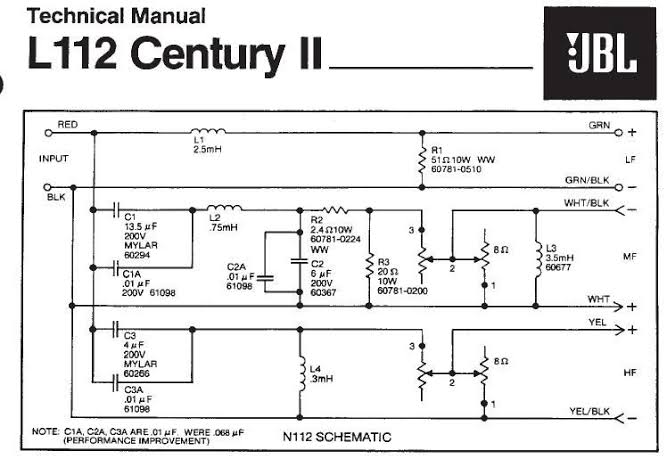

Galu
2018-04-17 6:50 pm
Briefly, a 51 ohm resistor will draw very little power from the amp compared to the parallel 4/8 ohm woofer.
You wanted to put an 8 ohm resistor in parallel with your 8 ohm in series woofers, in which case a large amount of power (half of the total) would be wasted in the resistor.
For a 100W amp, say, you would require a resistor capable of dissipating 50W of power without running hot. A suitably heat sinked resistor would be required!

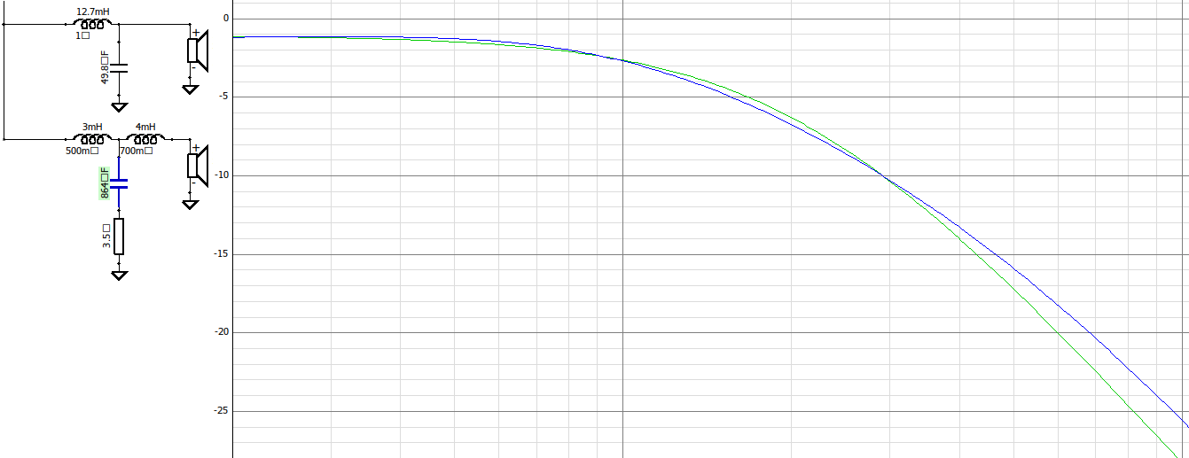

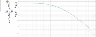

AllenB
Moderator
2008-10-18 11:31 am
Alternatives.
presscot
2010-07-27 12:24 pm
The following are the drivers to be used:
Woofer: 10” SEAS SW250; SW 250/1 L0019-04S
Mid-woofer: 6.5” SEAS H602; http://www.seas.no/images/stories/vintage/pdfdataheet/h0602_p17rexp.pdf
Midrange: 2” Visaton G-50FFL (optional); G 50 FFL - 8 Ohm | Visaton
Tweeter: 1” SEAS Millennium; E0011-06 T25CF002
At the moment, it is still in the process of deciding which way to go between 3-way and 4-way. If it is 3-way, the crossover point may be picked around 170 and 2,500 Hz. But if it was 4-way, then, the crossover point might be around 170, 800 and 4,000 Hz. Every section of the crossover would be jointed by the second order filters. That’s all my plans for now. Thank you
That particular woofer is well above 4 ohms near your crossover frequency due to high voice coil inductance. The minimum impedance above resonance is about 5 ohms at 80 Hz. That is based on the data sheet and the free air resonance will change when those woofers are put in an enclosure. By 200 Hz the impedance increases to around 8 ohms, and the impedance is ramping up rapidly. It would be best to use a Zobel across the woofers to flatten that impedance rise in order to get an accurate crossover response.
But your idea to use parallel resistance might still work good enough for your purpose.
At 170 Hz the woofer impedance appears to be under 8 ohms, perhaps about 7.5 or so. There is no mark at 170 Hz, I am estimating from the graph. A pair in series would be about 15 ohms at your crossover frequency. If you want to bring that down to 4 ohms for your crossover you need about 5.5 ohms in parallel. Four 22-ohm resistors could provide that, or six 33-ohm resistors. This has several implications. The resistors will, in total, dissipate more power than the actual woofers, and the resistance will counteract the rising impedance of the woofers, The crossover will see a predominantly resistive load, so a Zobel would not improve things very much at this point. Of course the resistors should be capable of dissipating quite a lot of power, perhaps 10 or 20 watts each. If these are difficult to source you must choose different values and divide the power up accordingly. And, if extended high power operation is expected choose according to the amplifier's capability.
