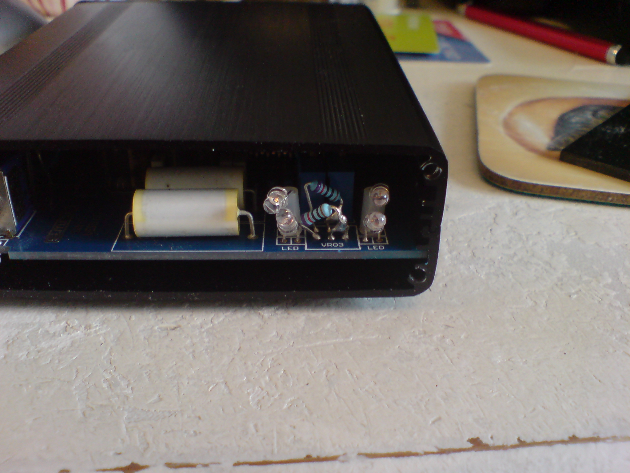

I have an SMSL SA-S1 amp on order and if all goes well I plan to use it as a power amp (with Pass B1 pre/buffer). I wolud like to remove the volume pot from the board and put a new plain fascia on front of the case, I am assuming I need to jump the channels on the board where the pot is removed and maybe add some resistance, can anyone point me in the right direction??

You will most likely end up with worse sound trying to modify the smsl, as there is no schematics available knowing what components to remove/bypass will be near impossible = you'll end up with noise and in worst case a dead TA2020.
Thanks for the replies chaps, why would I want to do it? - well I've previously used potless boards (charlize and arjen helder 2020 mkiii) and the autocostruire 2020 which requires just a jumper to bypass the pot so I thought I would try out something that was already in a case and just bypass the pot, it's cheap enough and this is diyaudio isn't it?
Usefull to know this solder blob trick! but as the pot shaft protrudes through the case fascia I'd like to remove it and put on a new fascia with just the on/off switch showing (simpler than buying just a board and casing the whole thing). Ive also read a few reported faulty pots on this amp so another reason to remove it!
Yes, I did the conversion some time ago (desoldered the pot and added the 10k R's) - all quite straight forward thanks to the previous advice. I then cut a piece of black Perspex with just the hole for the on/off switch and fitted this as a new front - a lot simpler than reboxing the whole thing!!
The attached photo shows the R's in place before fitting the new front.
Sounds great with a First Watt B1 pre/buffer. I have also tried it without a pre amp with a squeezebox using the squeezebox volume control - sounds good and in this way it no longer needs to be on show - very convenient and minimal!!
