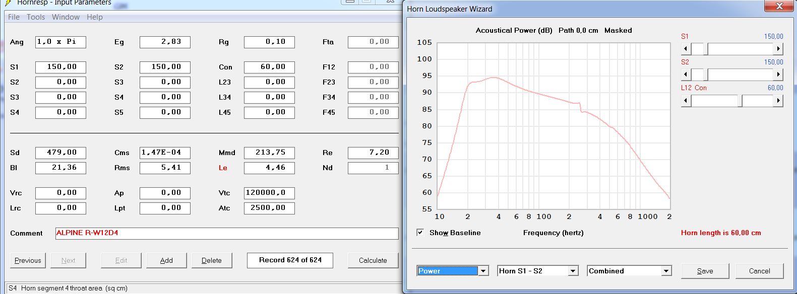

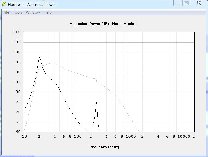

Yes, though not what's considered a good one. You need to vent the chamber over the driver and seal up the vented one unless you want 6th order.
Classic [pre -T/S] BP4 requires the new vented chamber be 1/4x new sealed chamber tuned to Fs, so at least a place to start, though expect a much longer vent and efficiency to plummet based on me trying it out in a few sims.
GM
I have a 12" DIY ported sub.
If I close the front side of the driver with another sealed chamber will it become a bandpass ???
(Assuming I estimate the front chamber volume by following regular seald sub design principles to achieve a Qtc around 0.707)
Yes, but it will be very much a "one-note" type of 4th order bandpass, which are all characterized by having a vented section that's larger than the sealed section, a
If i ask the same question differently.....
In a bandpass, can we design the front sealed chamber by following regular sealed sub design principles, and the rear ported chamber by following regular ported sub design principles ???
Nope.
Classic [pre -T/S] BP4 requires the new vented chamber be 1/4x new sealed chamber tuned to Fs..........
'Haste makes waste', 🙁 should be Fs/0.707.
