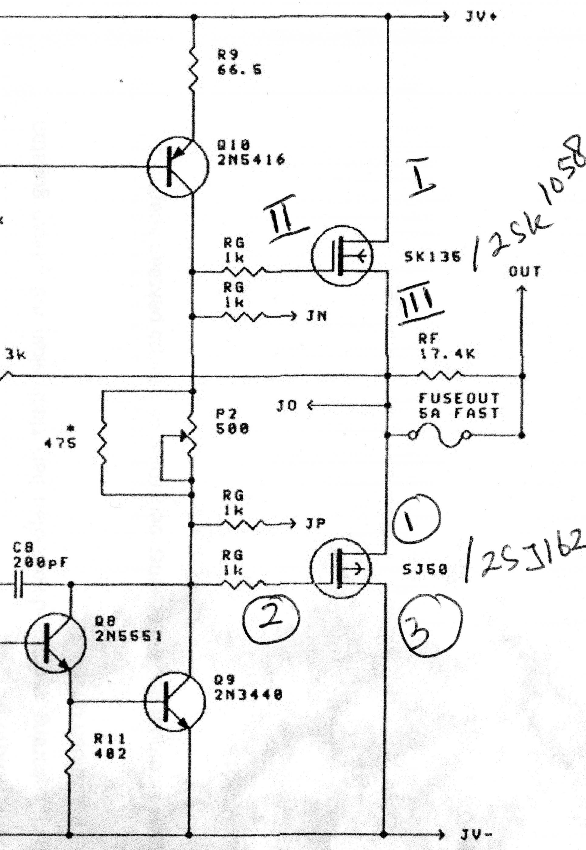

I want to convert my b&k ST-140 from TO3 to TO220
as you know that this amp use 2sj50 which is eq with 2SJ162
Also 2SK135 which also eq with 2SK1058
Please let me know if I did right or wrong on the picture attached
1 or I is gate
2 or II is source
3 or III is Drain

Why?
The stock 8A parts are still available, or 16A parts if you need to drive 4Ω.

2 and II Gate
1 and III Source
3 and I Drain
