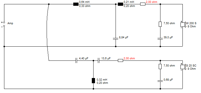

Butterworth is the filter for flat impedance and power response:

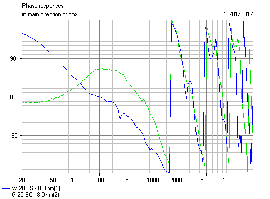

So lets build it, time-aligned here IIRC:
Terrific impedance and phase alignment:
The 3:1 ratio of components comes from the hexagonal symmetry that hides in BW3:
Having got impedance flat, there is no reason you can't apply a contour to the whole thing at the amp output.
Since this is an 8 ohm filter, 4 ohms and, say, 1mH will create 3dB bafflestep. In practise you use 6 ohms for most drivers. So 3R plus 1mH.
Graphs from Boxsim: Software | Visaton
