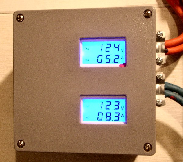

Yes. I did that at my last home and will do it here when I get bored one day. I had torridial non-contact current transformers around each leg at the breaker box, and a 6" x 6" j-box to the side where the hardware was. I used a Cirrus (CS5467 for both hots, a CS5463 for the neutral) chip for the power sensing with an AVR pulling the results and feeding a LCD display there and a wireless transmitter that fed a receiver at a PC that did logging and graphing etc. No reason for any of it other than it was a fun project and I'm a geek that likes measuring stuffHalFoster – Are you thinking of the hardware that connects at the breaker panel, and monitors usage?

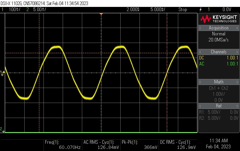

I finally got around to looking at the waveform on an oscilloscope, see attachment 1; and the distortion spectrum using REW and a Focusrite Scarlett, see attachment 2.
From my reading, clipped, or flat-topped waveforms are quite common, and indicate some form of distortion. The distortion spectrum confirms a fair bit of distortion, but I was unable to find any information on what would be considered normal. Does anyone have any guidance on this?

I took a look at some old data files and saw the THD levels to be similar to yours at about 2.5%.
I suspect it's highly regional - my data is from northern New Jersey in a light industrial neighborhood.
