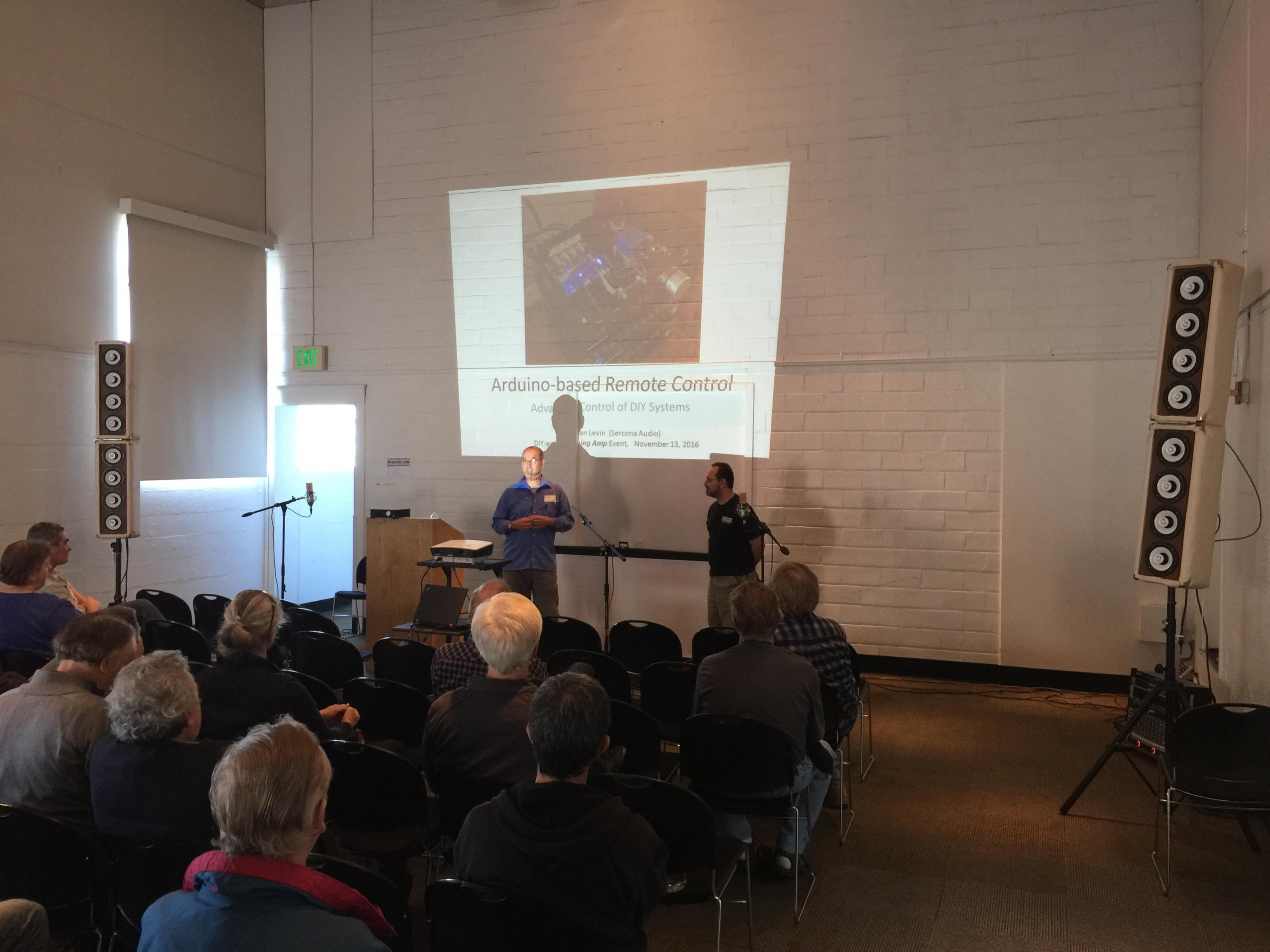

Here is my approach to PA:
https://www.facebook.com/anatoliy.lisovskiy/videos/1105599936142274/?hc_ref=PAGES_TIMELINE
People who attended BAF 2016 could see and hear it in action.
