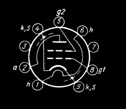

Considering this 6E5P for example, which has dual cathode+shield pins:
When the cathode is to be connected to a single other node, is using only one of the pins okay or is it better to connect both pins.
I always assumed the dual pin arrangement on each side of the socket is just for wiring convenience but I've often been proven wrong 😎
Thanks for any insights.

If they're truly just attached to the same point internally? I'd go for one connection.
Two might be better if it's a shield, for ultimate low impedance pathing. Yadaya.
But realistically? It probably is for either wiring convenience of because the pins were available and they might as well hook it up to the shield when it's there yeah?
Very possible, the tube was specified as HF amplifier, which would benefit from good shielding.Two might be better if it's a shield, for ultimate low impedance pathing
Maybe but then there's NC pins 3 and 7 unconnected to the shield...the pins were available and they might as well hook it up to the shield
As this was a soviet military part I suspect the pin arrangement was very application-specific, to allow close-by circuit connections be made on the NC pins instead of an external tag board. That's what I do with NC pins when possible.
Well, are those (3/7) as close to the ends of the shield as the other ones are? 😅Maybe but then there's NC pins 3 and 7 unconnected to the shield...
I always connecting such pins (4 and 9) together with short wire under the socket.
In Jurassic times, tubes often had multiple pins for important electrodes to reduce inductance internally for high frequencies.
The two cathode connections indicate this is an RF type. The idea is that one cathode connection is for the cathode bias resistor/bypass capacitor while the other one received the ground end of screen and plate bypass capacitors. This keeps the voltage developed across the cathode return from appearing in series with the grid return. This keeps the effective AC resistance of the grid high to prevent loss of gain/selectivity.Hello friends,

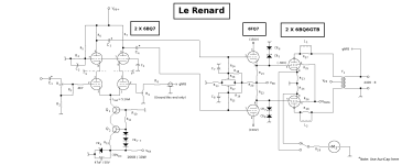

For any design, it depends. For this design (attached) plate decoupling wasn't necessary. Since the cascode LTP is balanced, there is no current change on the DC rail since as one half is increasing, the other is decreasing by the same amount (enforced by active tail loading) and the LTP is the only gain stage there. Besides, I needed all the available voltage.I have an tubed MM phono preamp project in the works that uses a high gain cascode input stage, I'll keep this trick in mind.
Depending on your MM preamp design, then plate decoupling will probably be necessary as the cascode is a high gain design, comparable to a small signal pentode (where the name comes from: "cascade" + "tetrode", minus the screen current "kinks") in regards to voltage gain, CMiller and high frequency performance. Unbalanced, multi-stage designs are more susceptible to instability.
