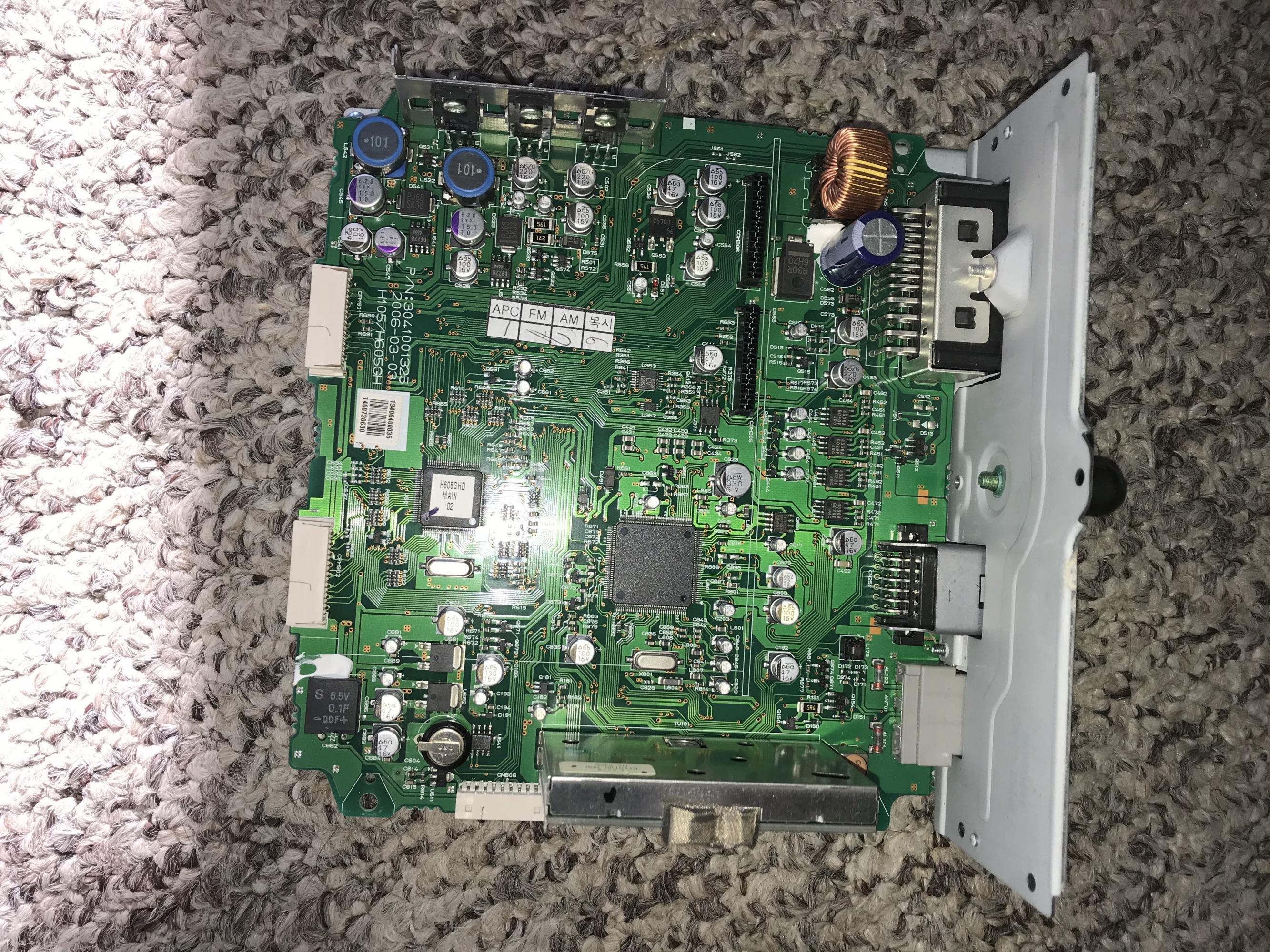

Sorry if this is in the wrong section, and also apologies for my lack of knowledge in the subject. Anyway, I have a project I want to do with an OEM Infinity head unit out of a 2007 Kia Amanti. For the record, I understand this is most likely pointless, I've just wanted to do something like this for a long time.
The end goal is to have the head unit function as a CD player (and a the FM radio?) and be able to hook it up to my home stereo receiver with RCA cables. Ive seen how to power the head unit outside of a car all over the internet, I just couldn't get a straight answer on how or if I could use the head unit as a sort of source component.
So the main question is, is it possible to potentially get RCA cable modded into the head unit to then plug into the RCA input on my receiver? Secondly, is there a better/more efficient way to do such a thing?

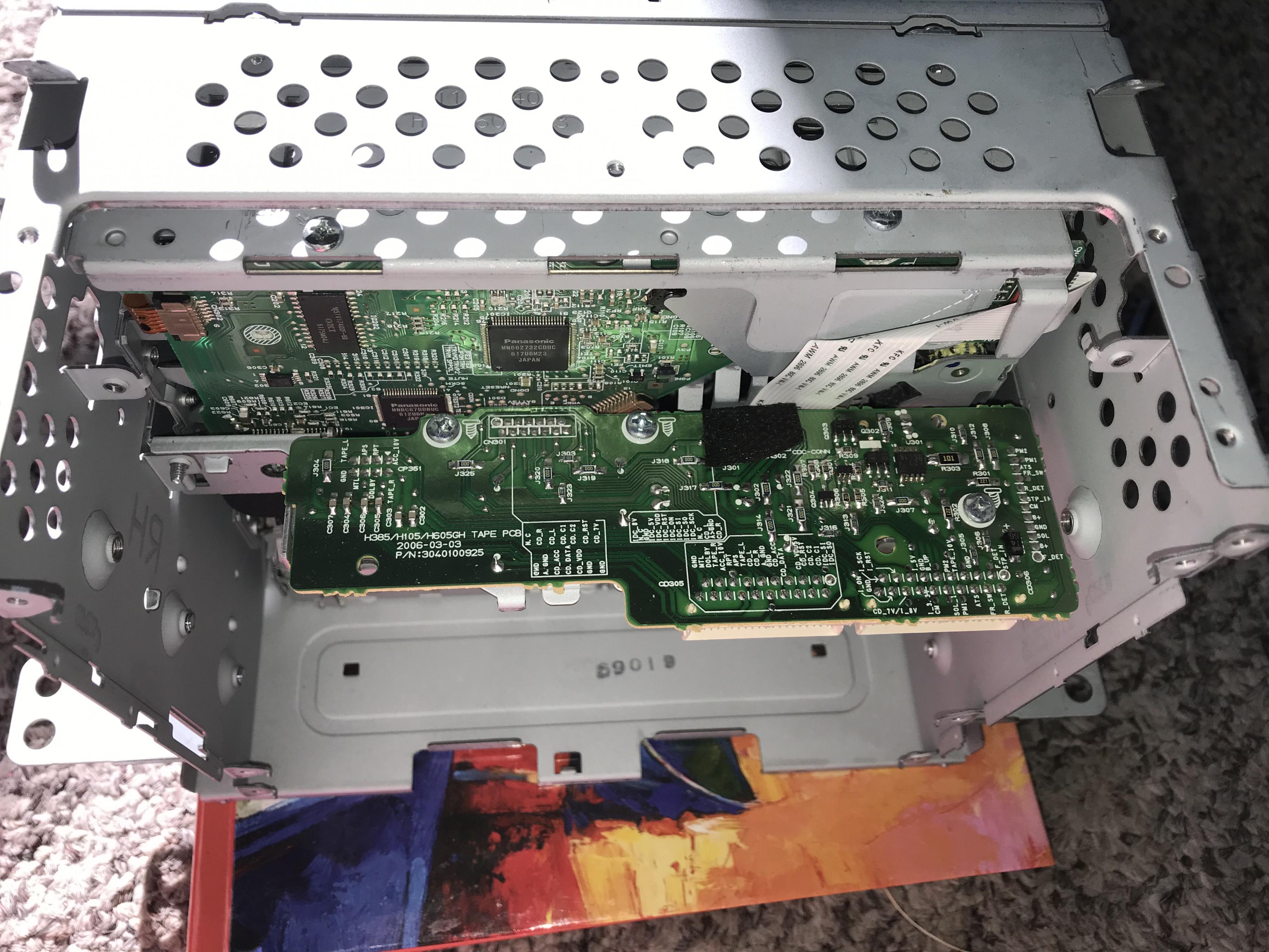

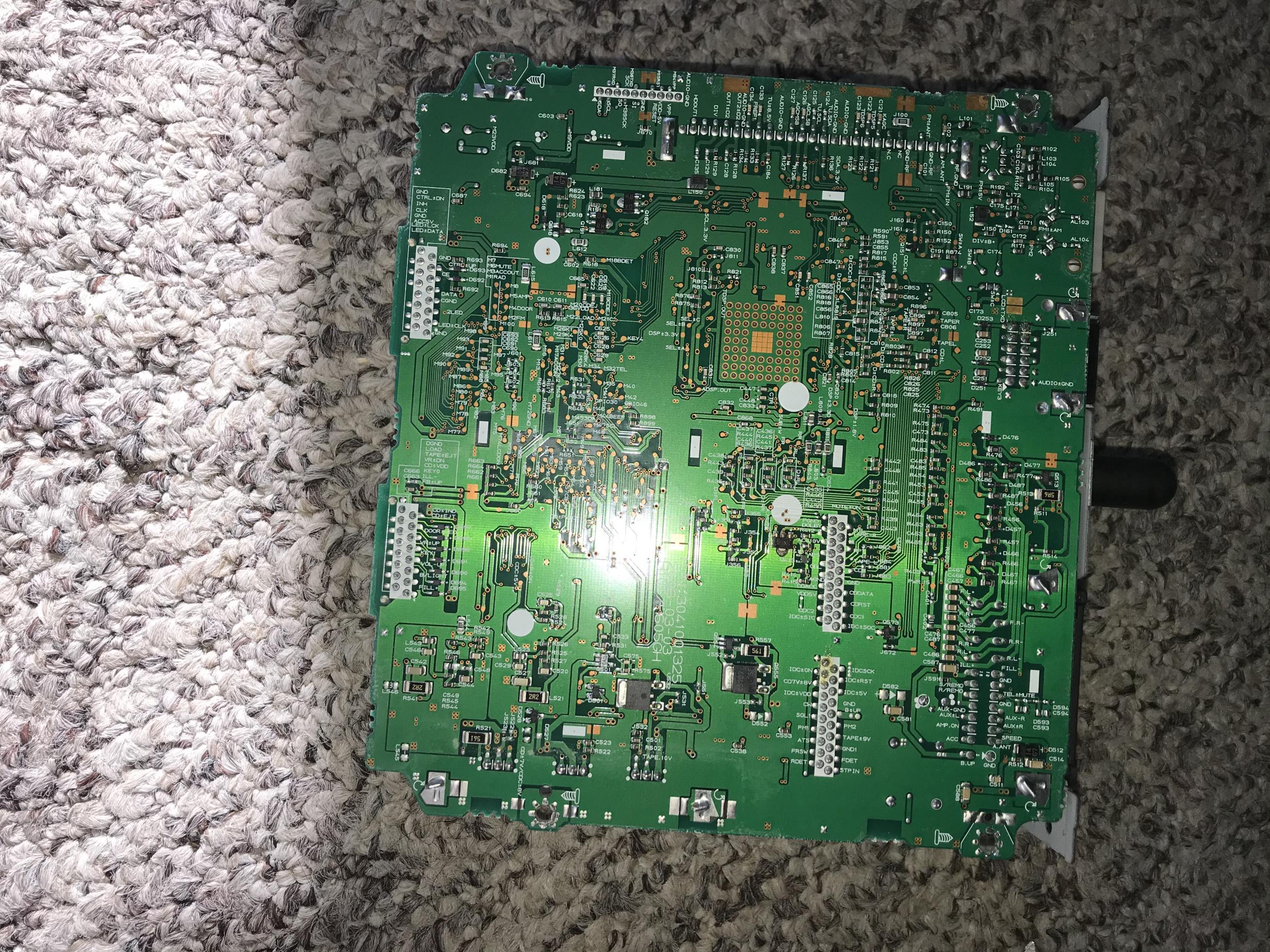

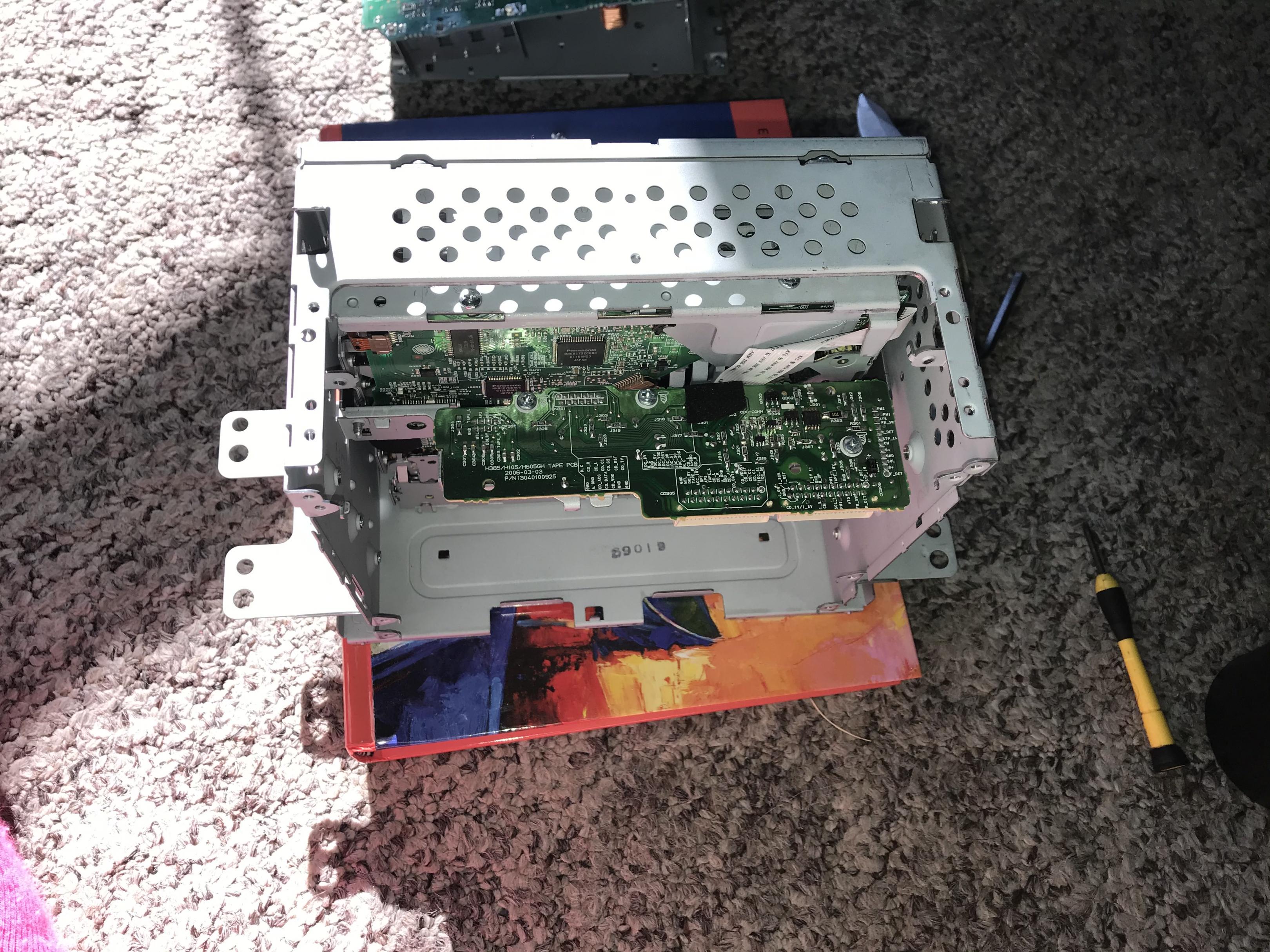

I opened the head unit with hopes to see an easy solution, lol.
Pics for reference below if needed;
Thanks in advance!
Jimmy

I don't see a heatsink anywhere in the head unit so it may be preamp only. The connections to a speaker level head unit vs a preamp only will likely be different. You will likely need to block DC on both. A Line Output Converter will do it on speaker level.

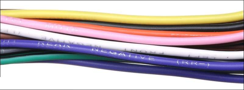

As was previously stated, a car audio shop will have adapters plugs (may be difficult to find to plug into the head unit). The markings on the wires will be something like the ones in the attached image.

You have to know if it's preamp or speaker level to know which converter you need. Some drop the level, others may not.
It's likely that all of the output wires will have 6v of DC voltage on them and you cannot use that to connect to the receiver or amplifiers. At the very least, you will need capacitors to block the DC.
You can splice RCAs into preamp signal lines (with proper DC blocking and grounding).
The head unit could have individual outputs for lows/mids/highs. If so, that greatly complicates things.
