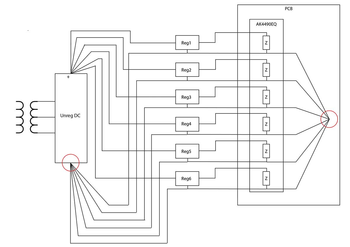

I have a question about wiring power supply grounds for a DAC chip.
I'm building a DAC using the AK4490EQ chip. This chip has 6 different power supply inputs, each of which has separate pins for both supply voltage and supply common. The AK4490 evaluation board (actually the daughter board) layout is a 2 layer board. It retains the separation with separate ground pours for each of the supply common conductors from the board edge to the chip. But, except for the reference supply grounds, all of the ground pours are connected together on the bottom layer under the DAC chip in a small area. I guess this is a star ground for all the supply common conductors.
I tried to replicate this daughter board, and I have in my hands some actual PCBs.
I plan to use 6 different voltage regulators (5 of them to be PFM fleas) to supply the power to the board, but I'd like to power these regulators from one unregulated DC supply, or maybe two...one for analog and one for digital.
I'm confused about how to connect the commons or grounds together. It seems to me (a non-engineer) that if I wire each of the voltage regulator grounds directly to the unregulated supply ground in a star fashion, I would be creating ground loops. I'd have one star point at the unregulated supply and a second star point on the PCB under the DAC chip. There would be multiple paths for return currents to flow.
Is this bad? What is the right way to do this?
You are right that at one point or another, those grounds have to get together.
The point is that you want to avoid that the ground current of one supply goes through the ground run of another or they may impact each other.
I think the best way is to return all grounds to a common point that is also the reference point of the input supply. Think of the input supply as a battery with a + and - (or, the output cap of the supply). You would then run each ground (and each input too) back to that common battery or output cap.
Makes sense?

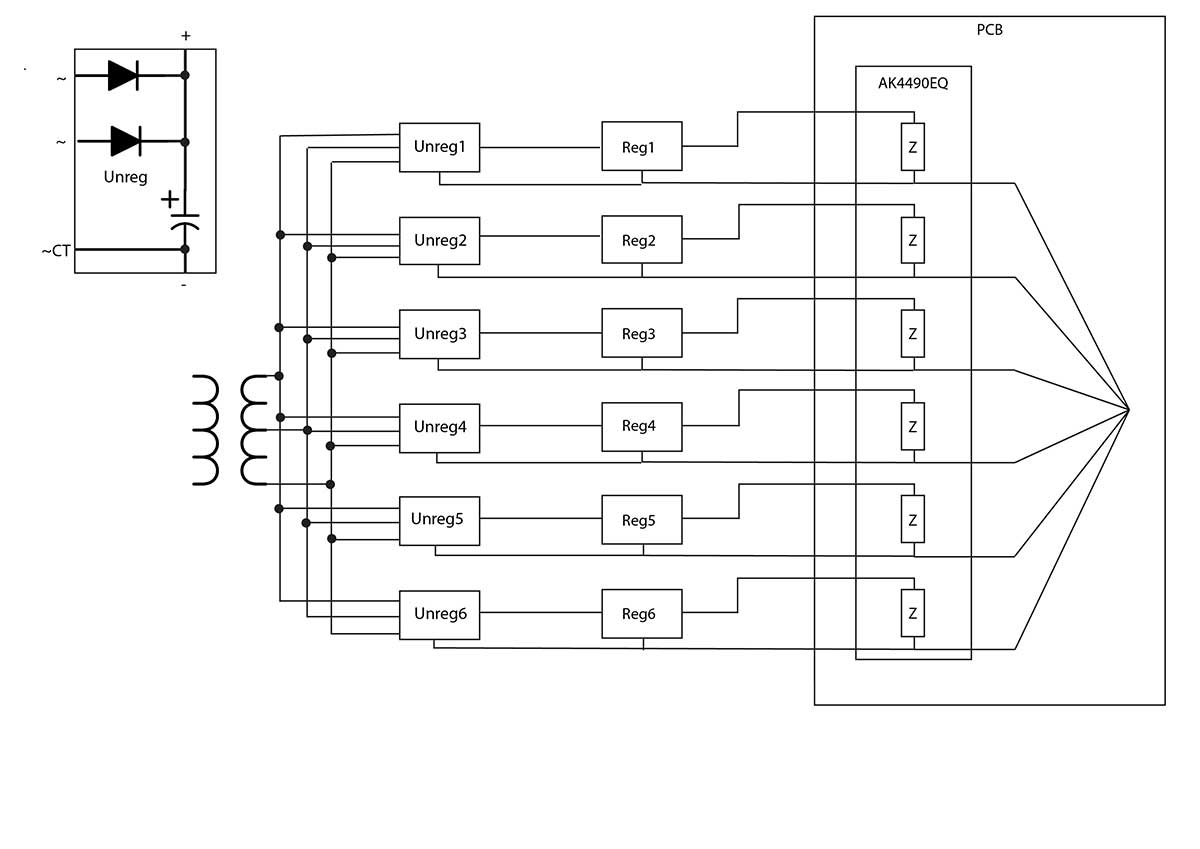

Thanks much for your reply, Jan.
I think the first block diagram below illustrates the problem. A star ground inside the red circle on the left, and another one inside the red circle on the right. I think you're suggesting that I eliminate the star on the right. Unfortunately, that is etched into the PCB, and eliminating it would require a bit of cutting, slicing, and dicing on the PCB. I also think there must be a reason the engineer who designed the evaluation board must have had good reasons to join the grounds like this under the chip. Maybe he had completely independent supplies with no connections to each other, and he decided that this was the best location to join the grounds.
I have a spare PCB, so I could try it.
But I wonder if I can solve the problem in the way shown in the second block diagram below. I could use 6 unregulated supplies powered by a single transformer. Do you think this would work?
Dave Halbakken
Dave Halbakken
Yes ideally, you really don't need the star in the right of the diagram.
What you would want to do is place the reg as close as possible to the DAC chip.
The right diagram is not clear to me. All the reg grounds come together but they do not seem to connect to the center tap/cap ground of the raw supply. Unless I miss something.
What I would do is run a single thick wire from the center tap/cap ground to that star.
Then at least all levels are OK and none of the reg local grounds are mixed up with others.
Jan

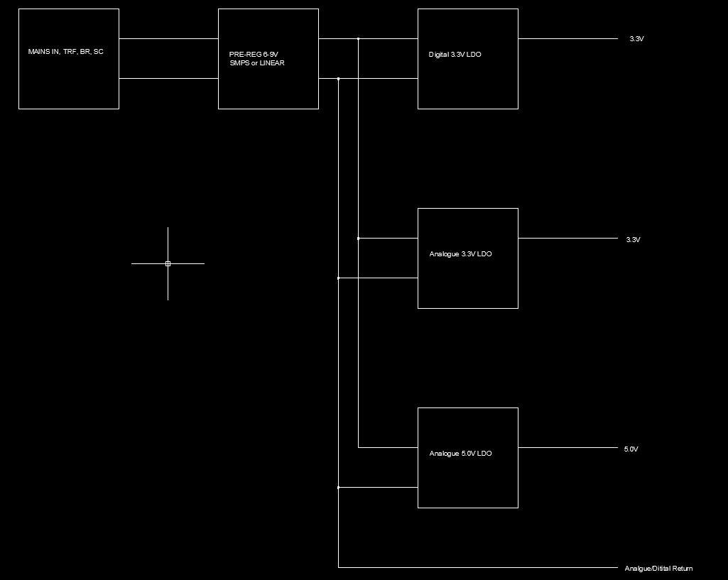

I'd do it like this...
Main regulator to take the voltage down to make an easy load for the LDOs, done on loads of designs and is common practice when multiple voltages are required.
Though as said you can have say 1 3V3 and isolate digital and analogue with a PI filter. just doing a complex ADC/DAC board now, not audio but the same problems, making things to complex can increase the noise or create a difference between the various grounds so your resolution can go downhill.
I also concur on the layer stack from DMILLS...

Many thanks for all the comments!
Marce - thanks for pointing out that "AVSS, DVSS, VSSL and VSSR must be connected to the same analog ground plane" per the datasheet. That's a pretty convincing argument that the motherboard has a continuous ground plane underneath the daughterboard.
Looking at the layout of the motherboard at 100% in the pdf viewer makes it look as if there is a continuous ground plane underneath the daughterboard. But zooming in with the pdf viewer, it no longer looks so clear-cut. That's one thing I'm confused about. With higher zooming it looks as if a separate ground area might exist for each supply. It is unclear whether this is just an artifact of the pdf output from the pcb layout software, or whether there should actually be gaps between these areas.
Also, thanks for the reference to Henry Ott. I read him a few months ago, but I could not remember his name. Now I can go back and review his notes about grounding and mixed signals.
My intention is to use 4 of these DAC daughterboards in an 8 channel DAC. If I were to use 6 LDOs for each daughterboard, I'd end up with 24 of them. Or fewer if I were to supply left and right channels from the same LDO per your diagram. The least expensive, low-noise, DIY friendly LDO that I've found is the ADM7150, which for so many pieces would be pretty costly. Also I'd like to run the analog stages (VDDR/L and reference voltages) at 6.8 - 7.0 V to squeeze a bit more performance from the chip. I don't see an ADM7150 that produces more than 5V.
Besides, this DAC does not require much current (22 mA typical - 35 mA max on each VDD pin), so I thought the PFM flea regulator might be a likely candidate instead of LDOs. I've breadboarded a flea with an NE5534; it seems to work fine at 30 mA, but I do not yet have a way to measure the noise.
Maybe a super-regulator (Jung or other) supplying higher current, along with pi filters for separation before feeding the pins on the board edge would be better. I don't know, and I'm unsure how to decide.
dmills - I'm sure you're right that a solid ground pour and 4 layers is best. But I don't trust my pcb layout skills to get everything right. That's why I replicated the daughterboard of the evaluation kit. I figured AK must know what they're doing, and perhaps that is the layout they used to do their published measurements.
So, for the moment I'm stuck with 6 copies of that daughterboard manufactured by OSH Park. I'd like to make them work.
You mentioned that the reason for separating pins for analog and digital has "everything to do with eliminating common impedance coupling due to the impedance of the bond wires and pins." Is that also true of separating pins for left versus right channel supplies? I'm not sure how to decide whether supplying left and right channels from separate regulators or just a single regulator is best.
Jan - yes perhaps a big wire to the star ground built into the pcb is the way to go. Or maybe mount the daughterboard above a ground plane and connect that star ground to the ground plane. That doesn't seem very easy mechanically, though. Please ignore my second diagram. It will not solve my problem, which was to avoid multiple ground paths.
I'm still confused why AK engineers created that star (the right-hand star in my diagram) on the daughterboard, and also seem to have connected all the grounds on the daughterboard pcb edges to a single ground plane undeneath. This seems to create multiple ground paths.
Dave Halbakken
Dave Halbakken
It isn't a star as such, it is slots in the ground plane to control current paths, you have a two layer board so you do NOT have a ground plane, you have ground pours that have numerous slots in them (again Henry Ott and others will tell you how bad this is) so the design is already compromised from a signal integrity and EMC point of view. Looking at the data rates this chip has to handle I would not go less than 4 layers and on a complete product with supplies and any interface IC's would probably look at 6 to 8 with multiple ground layers. It is an evaluation board and not the best example of a low noise high resolution DAC layout. So the slots are to cater for to some extent the lack of a true ground plane...
having looked at the data sheets I have formed a basic picture of how I would lay out this device and its supplies...
