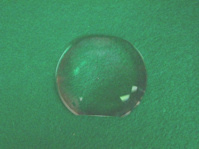

especially on a 16:9 ratio lcd, here is a pic of the shape my condenser is,(same shape different one), although not fully rectangular it is more rectangular then round and works great, i have about 1/2 inch of over lap all of the way around the back of the lcd of light so not much is wasted and what is wasted will go back through from the far ends of the pyramid with the mylar reflecting it.
Trev
P.S. this isnt the same lens but similar, the one i have is abit more rectangular
