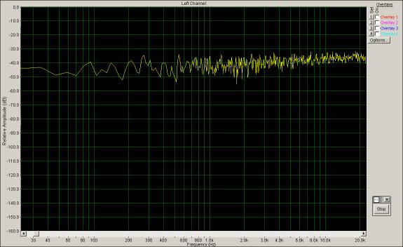

I'm trying to make some bandwidth measurements, but the white noise generator software I'm using is far from optimal.
For the moment, it's spectralab build in signal generator, but the spectrum is far from a straight line :(
Does anyone have a good white noise generator? The attached picture is what I get from spectralab, directly recorded from the wave device (so 100% software, it's not line in shorted to line out) with a 2x averaging

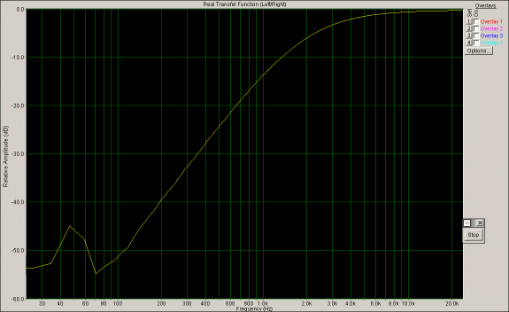

What kind of details to you want? A basic setup configuration for testing line-level gear?
Use either the left or right line output from your soundcard and "Y" it....one leg back to one of the line inputs and the other leg to your DUT. The output of your DUT goes to the other line input. Select "real transfer function" from the dual-channel processing box in the options menu and activate the white or pink noise generator. Increase the averaging setting so you get nice smooth curve results.
A similar setup will work for close-miked speaker measurements if you incorporate a microphone and preamp into setup.
Davey.

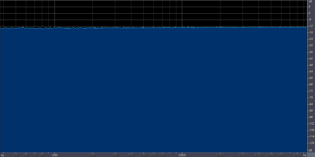

Mr Evil: your white noise is -12dB, while mine (from spectralab) is -40dB. I thought this was normal, since a white noise is a signal containing every frequency. So a 0dB 100Hz, plus a 0dB 1kHz, plus a 0dB 359kHz .... would lead in something over 0dB (over full scale, not possible for a soundcard)
But now that I saw your attached file, all my theory seems wrong :bawling:
