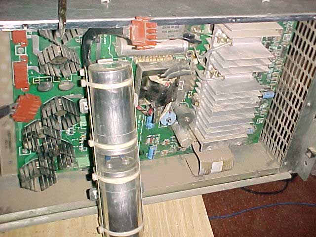

Is this what you are talkin' about?
I guess if today PC PSU used big dadies like this one they wouldn't crack up so often ( like mine, a week ago

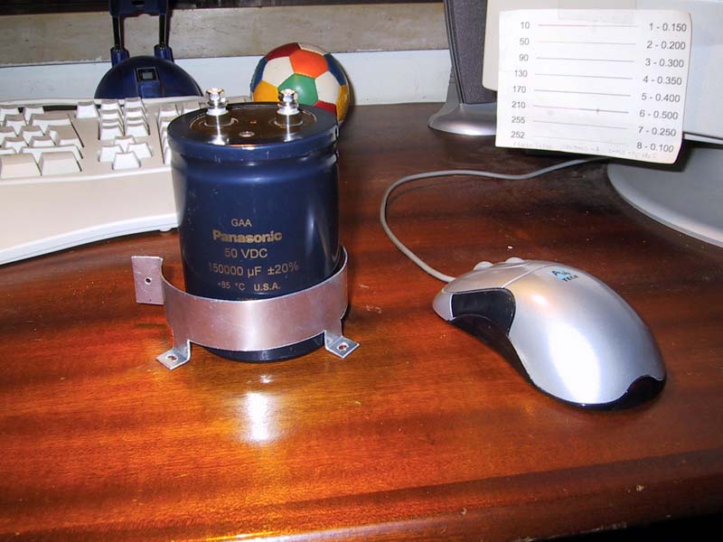

Computer Grade Caps
I see your picture; and the differance to think about is the
size. The older the date code the larger they will be.
I suspect your 30,000uf 75V cap is 3" Dia and about
5" high. My 26,000uf 75V are only 2" dia and 4 1/8" high
And there still making them smaller. Technology changes.
Steve
Apex Jr
Steve
Apex Jr
