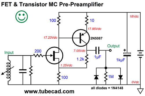

These principle of circuits might be of interest as a MC stepup.
Low powered, low but linear distortion in both active stages and a Zout low enough to easily drive 47kohm and usual capacitive load.
High feedback reduce noise pickup. High Zin.
"High feedback reduce noise pickup. High Zin."
Very questionable statements. About half of MC carts are happy to work into 0ohm loads and max load resistance does not exceed 1k. One place with really no need for NFB is the MC stepup.
@analog_sa
I understand why you think so since I didn't told the full concept, but high linear impedance from the circuit input is what you want to be able to have a pure resistive load on the cartridge when loading it with recommended resistor. The circuit itself should load the cartridge as little as possible.
I think it is of interest since Zin of the circuit is high enough to compete with a jfet, but with the potential to pick up less noise.
Will test it in my system in the future and see how it performs.
The one from posts 45 and 46 has a far lower noise floor.
Yes, very likely. But sometimes you can select very low noise jfet. Out of few hundred there is few.
I personally use ortofon and audiotechnica step up transformers.
But since i do have complementary pair 2n4401/2n4403, i will make eventually common base circuit. Just out of curiosity. But not now, too many other projects unfinished.
