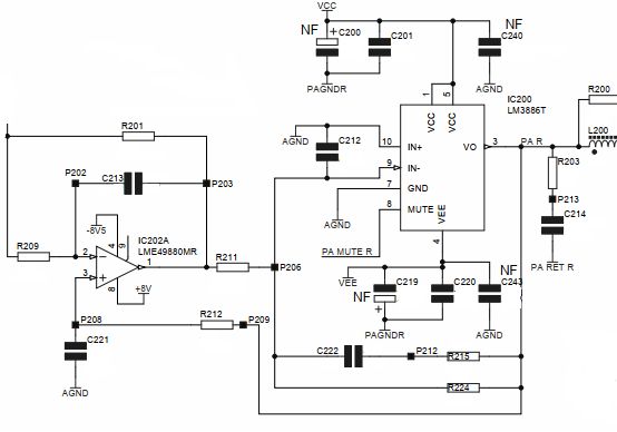

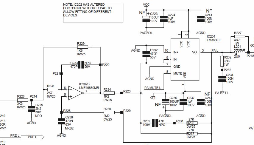

Arcam FMJ A19 to me looks like a composite from the schematic (no values included in the pic). Comes up well in reviews and IIRC got amp of the year 2 years running at What HiFi. I still use one here.
I'd say the newer Arcam SA10 would use a similar circuit I imagine.
No, it's not. It's more similar to the simplified version of the super gainclone published by Cordell. C221/R212 are just there for DC feedback and offset control, the opamp doesn't correct the audio frequencies.

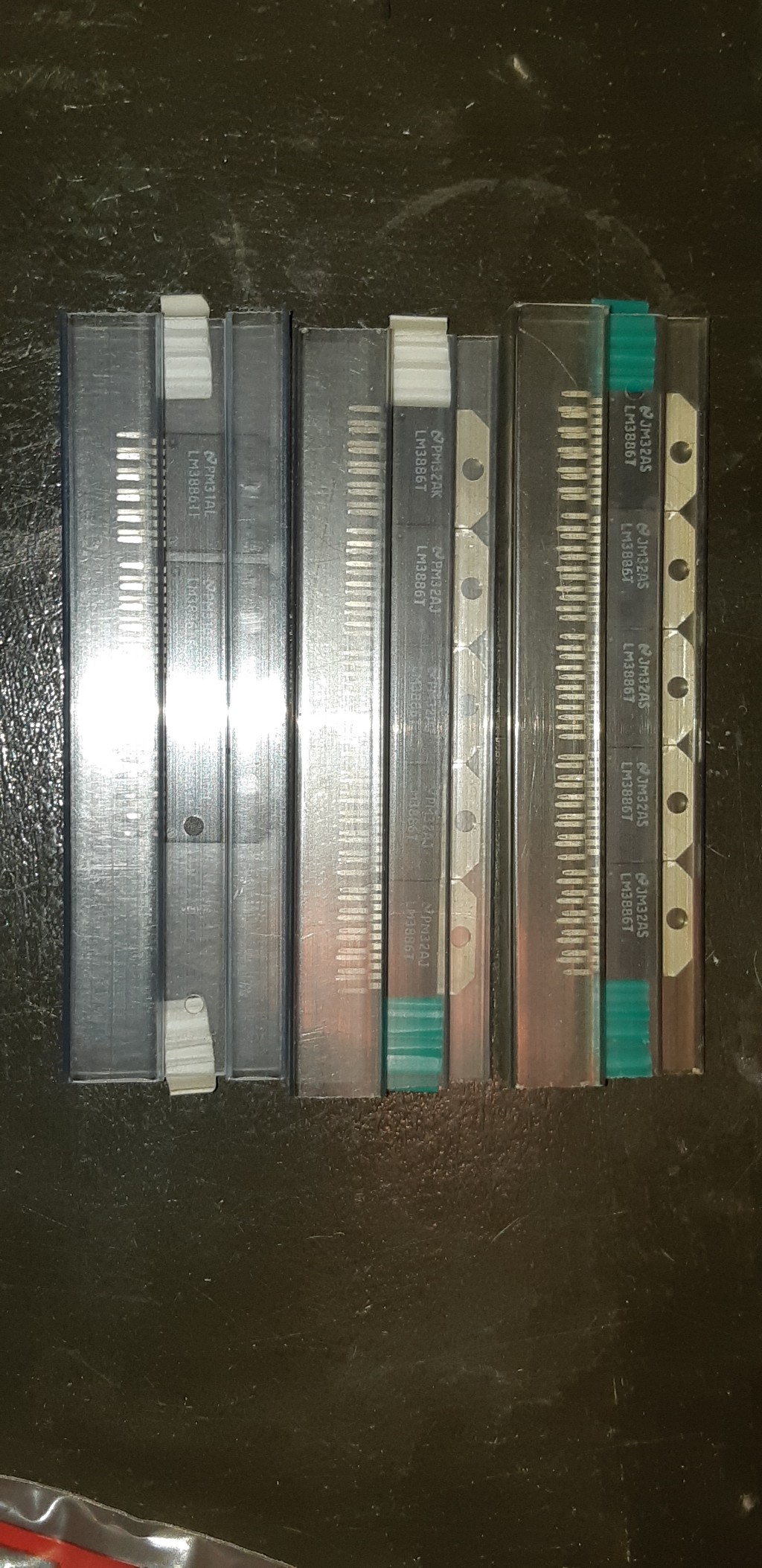

I just found these, I ordered then from national semiconductor back in 2002, with big dreams of building a btl parallel amp per the data sheet. I have the power transformer too, and power supply capacitors and heat sinks, but I never made boards. I ended up using the chassis to build a JLH Class A amp, which sounded good but eventually melted down and I never rebuilt it.
I'm thinking that a pair of composite boards would suit my needs a lot better now than the monster amp I wanted to build originally, and the oversized power transformer couldn't be bad. That article about high levels of negative feedback has got me thinking.
