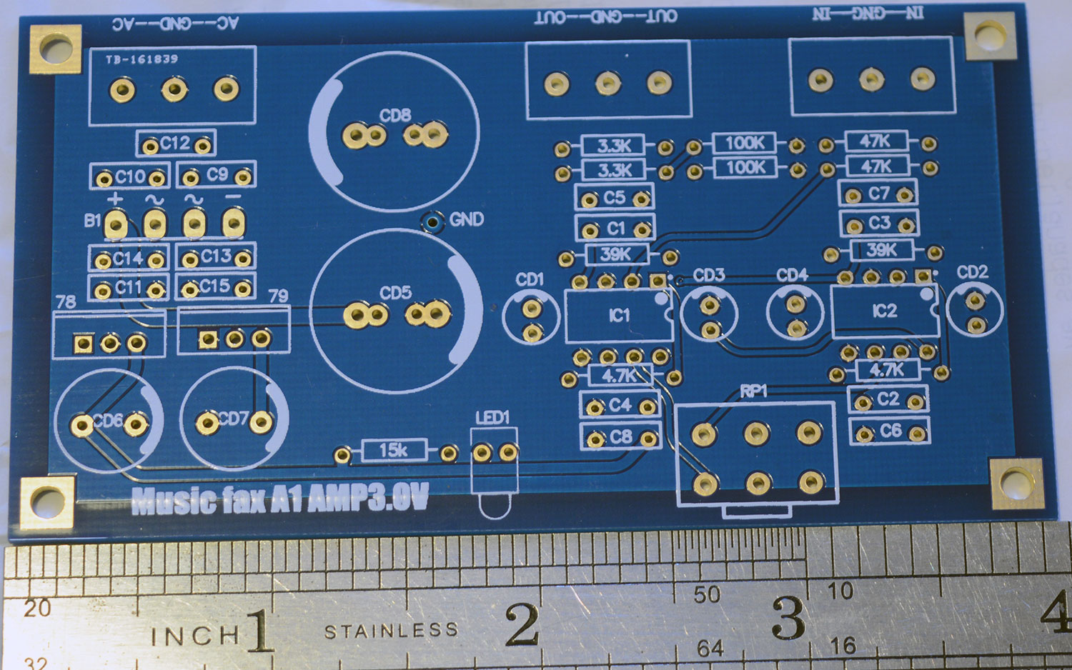

I figured I'd ask here before I get to work on this simple pre-amp.
What compontent/s would I need to change or add to make this circuit work with LME47720NA? For OPA1632 I wouldn't need to change much if anything from my, very limited understanding.

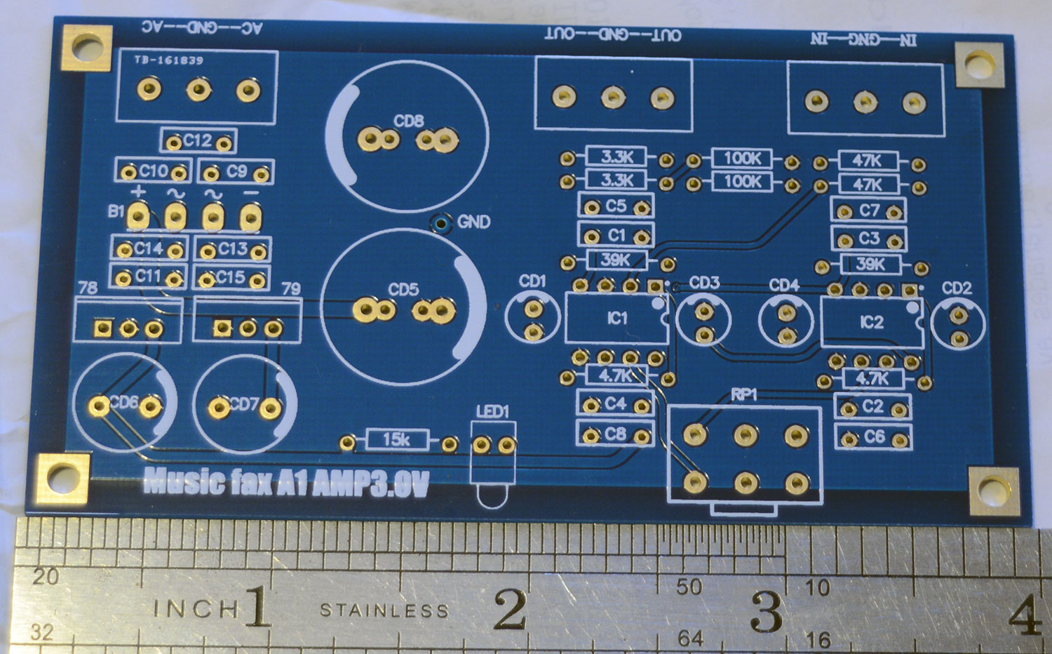

Resistor values are marked on the PCB.
C5,C6,C7 and C8 looks to be 220nF (0.22) from pics of populated boards.
C1,C2,C3 and C4 looks to be 10nF (0.01) from pics of populated boards.
The caps around the rectifying bridge and voltage regulators I assume are 100nF.
The two big lytics seem to be 2200uF, the smaller after the 7x12's I can't see, but should be easy enough to find out from the datasheets.
If anyone has the schematic, I'd be grateful if I could get it. I've contacted the seller twice about it now(most recently in the last 5 minutes).

Do you mean LME49720NA ? If so then that would probably (but never 100% guaranteed) be OK. It would help to see the actual circuit though.

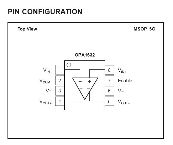

The OPA1632 is not suitable as its a totally different type of device, a full differential input and output.

The OPA1632 is nothing like a 5532. For one thing its a single opamp and as you can see here, its a different type of device altogether with a differential output (two outputs, a + and a -)

I presume whoever recommended that was thinking of OPA1642 or 1652 or similar, which are regular dual opamps. 1632 is the "odd one out", so to speak.
Yes, I probably got them mixed up.
No harm though as I think the OPA1632's might be used as a gain stage before a transformer output on a Vout DAC?

Its a Musical Fidelity X-A1 clone
very simple circuit

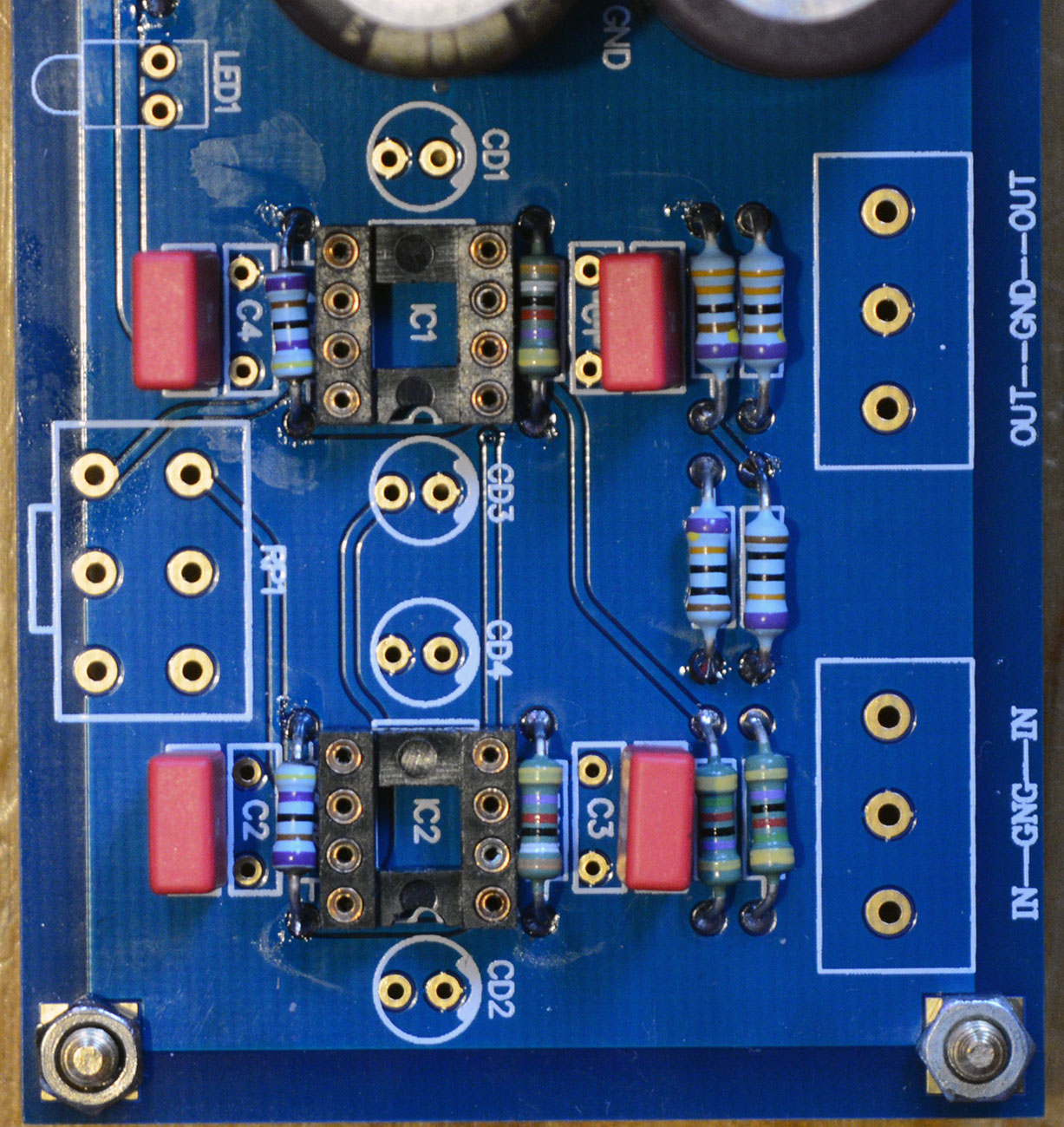

There seem to be some more spots for caps on my PCB though.
I've not figured out the values for the small lytics close to the opamps yet.
The filmcaps fitted are Wima MKS2 220nF and the empty spots next to them will be 10nF MKT's. Those values determined from looking at ready made listings of this on ebay as well as kits.

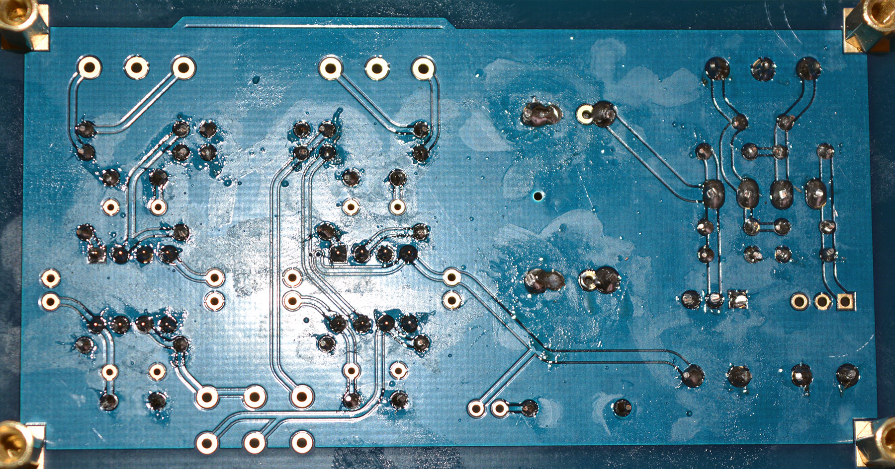

The backside is a mess I know, I will clean that all with IPA when all parts are populated.
They are all on the PSU lines to the opamps.
The diagram only shows C5 and C6 where C1-C8 on the PCB.
i.e.
C8 & C4 are on the + supply to pin8 IC1
C2 & C6 are on the + supply to pin8 IC2
C1 & C5 are on the - supply to pin4 IC1
C3 & C7 are on the - supply to pin 4 IC2
They are all PSU caps meaning the actual circuit is correct albeit the PSU is simplified in the diagram. All irrelevant for the opamp rolling.
