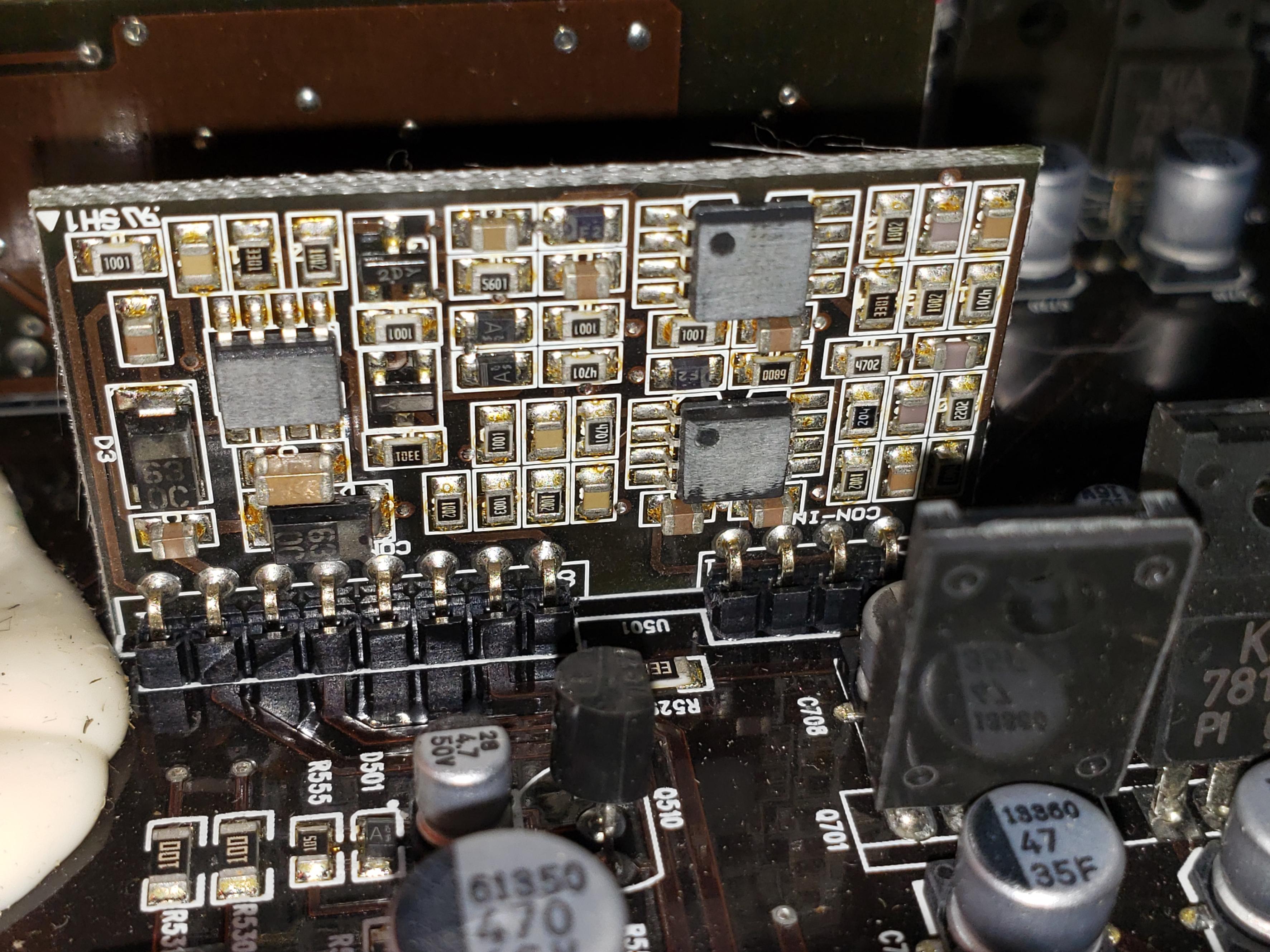

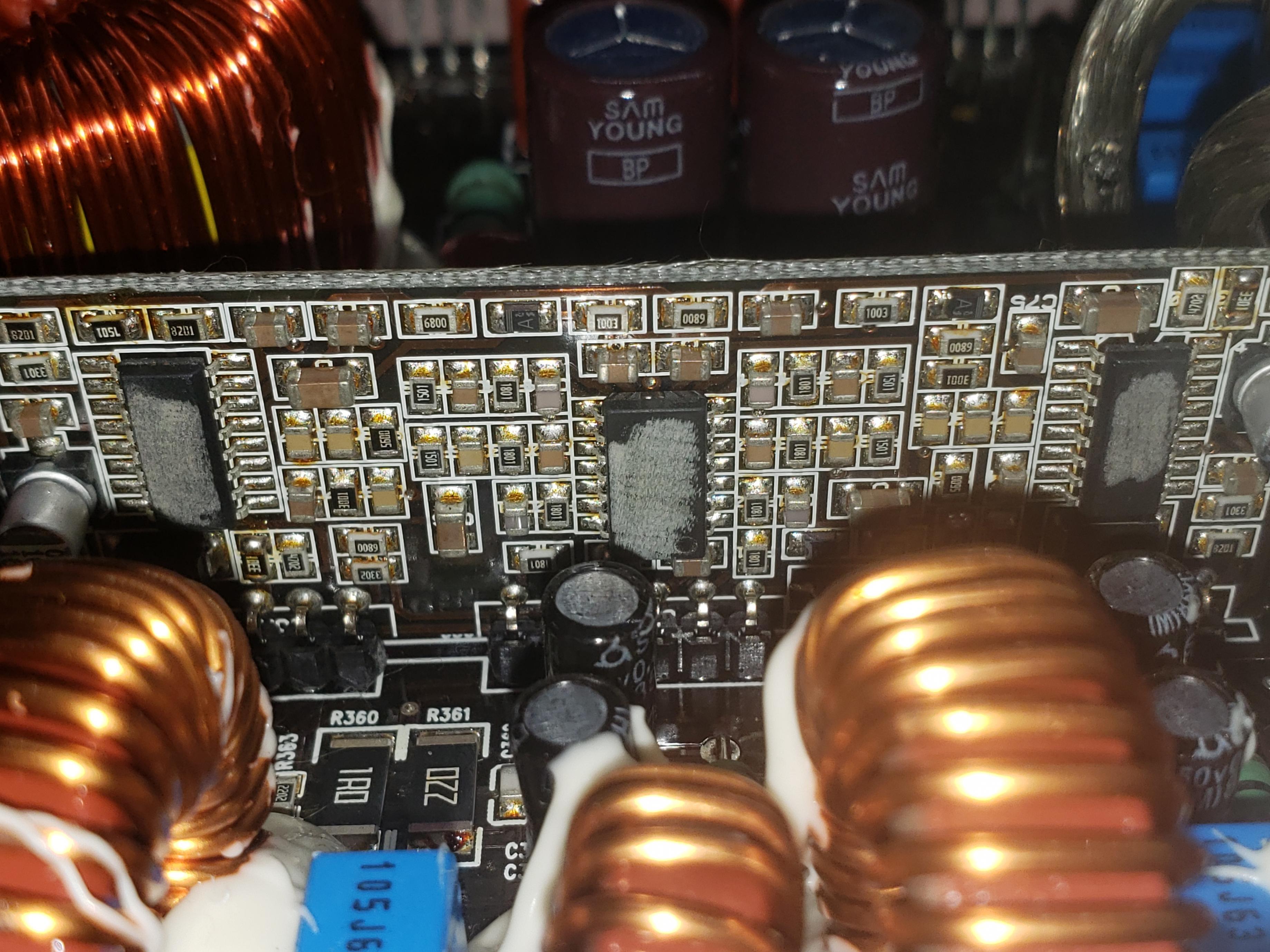

Two TL072s and an IRS2184S
The outer ICs are IR21844S/IRS21844S.
The center may be an LM219 (wait for confirmation, this may not even be close).

Virtually every large car amp uses the IR21844 IC. IF you need real power abouve about 2KW, you don't have many options.
These amps are decent but can be difficult to make reliable after they fail, generally due to intermittent problems and that's mostly intermittent shorts in the inductors.
If you think this is sneaky, you haven't seen the ICs that are marked with legitimate part numbers that are for a different IC. The marking look 100% legit, not a re-mark like NTE or other IC markings where they black the original marks out and re-print. They even mix up the IC manufacturer for markings. They include original logos and date codes. They do it on ICs and other smaller semis. It's pointless, for the most part.

does the ir21844s come in a 16 pin package? the 2 outer ic's have 16 pins on them.
My mistake. I don't know what they are. Look up the pin configurations for the various 16 pin driver ICs and see what matches. Do the same for the LM319 to see if it matches the center IC.
