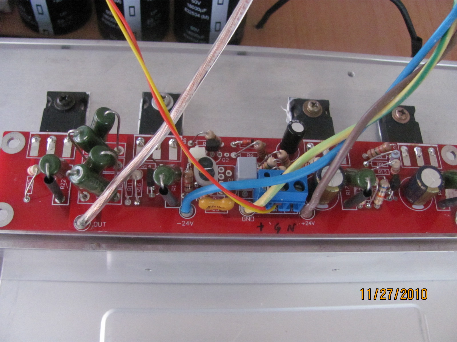

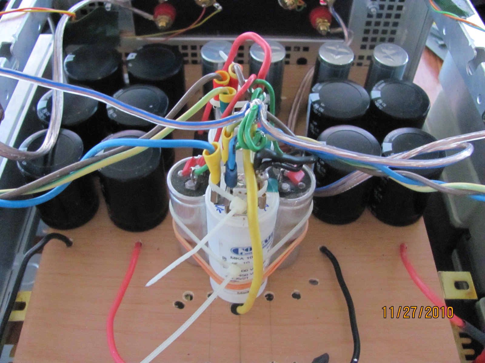

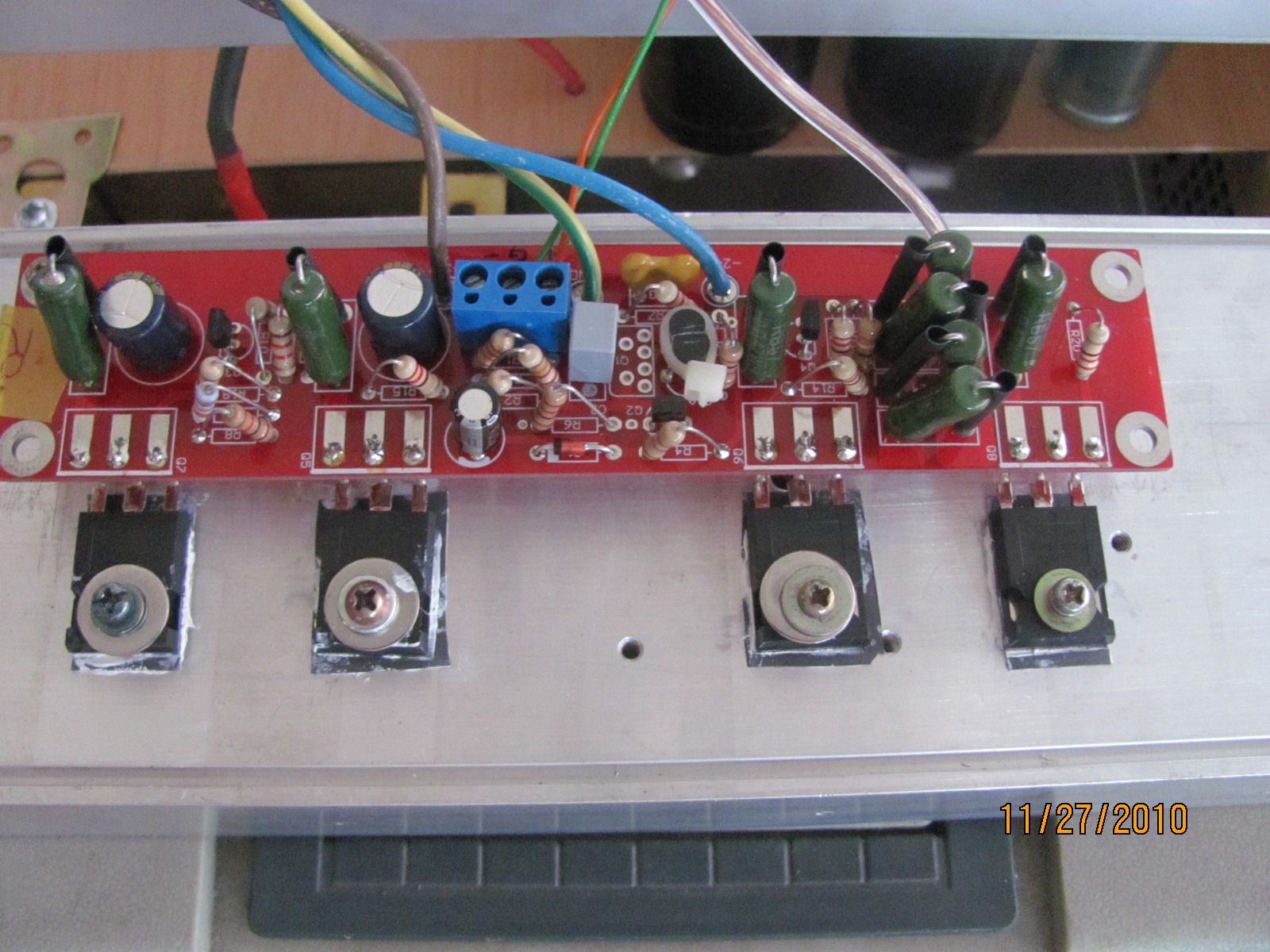

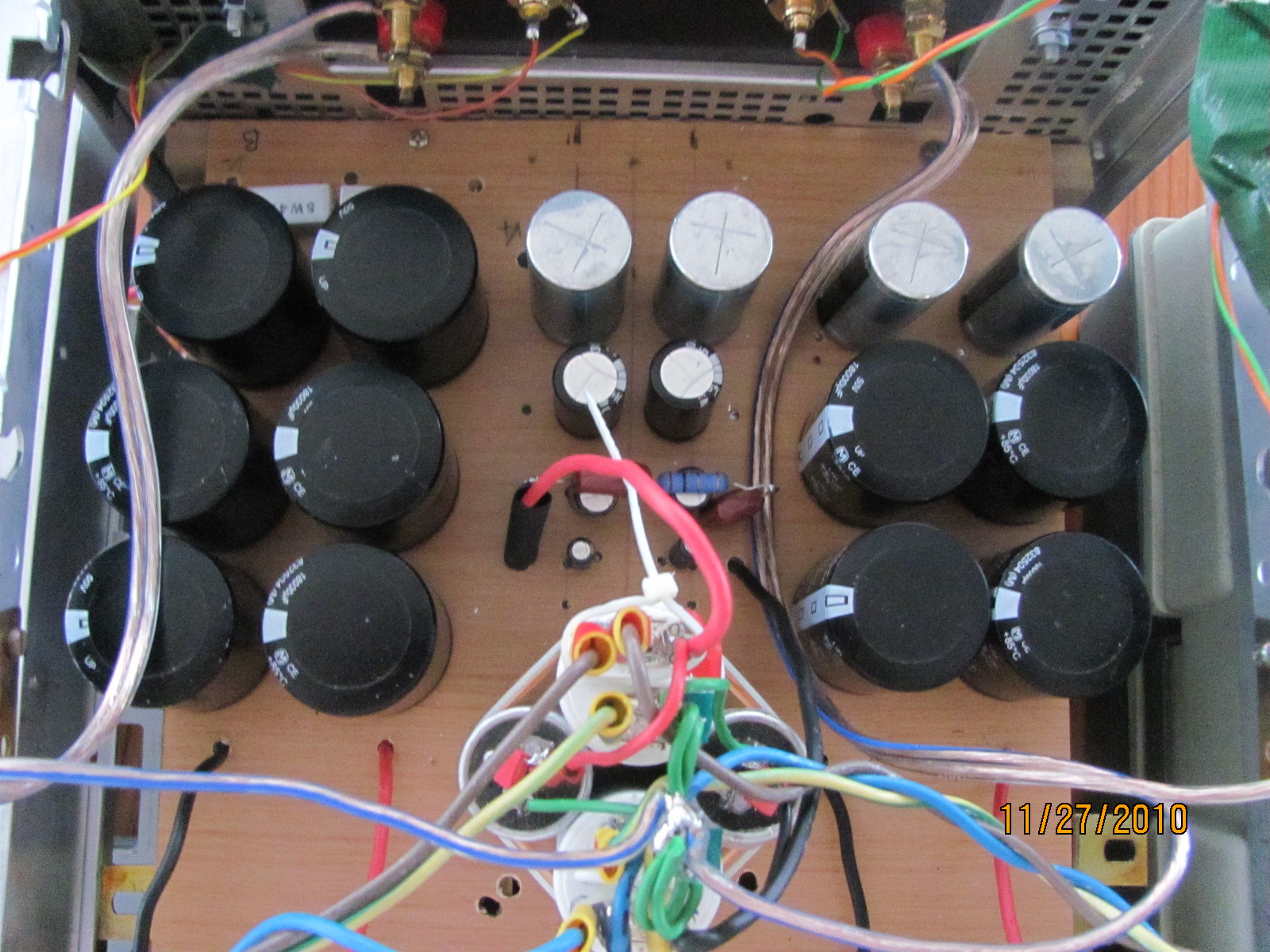

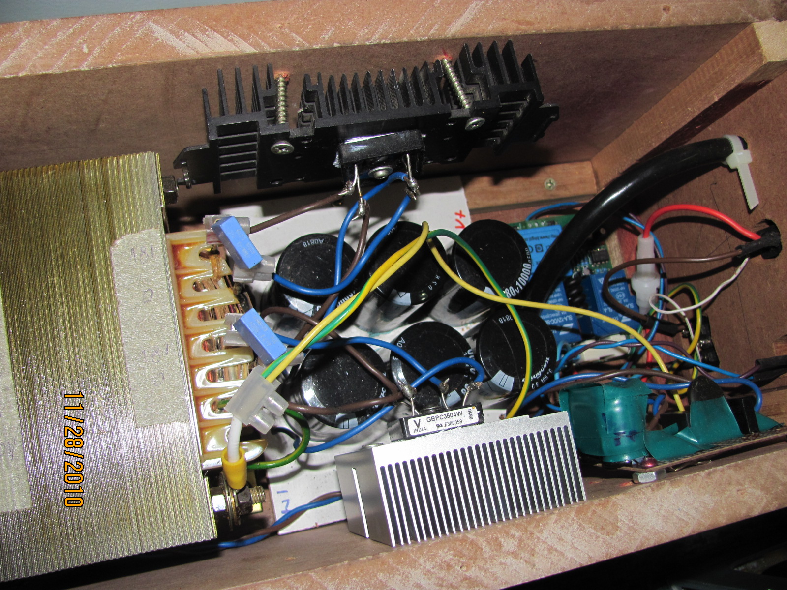

These are some pictures of the aleph j that I build.
The transformer is in another box.
The pre is J310 and Lightspeed clone as the attenuator.
hope i can find some pointers in troubleshooting this problem.

power supply for aleph J
Hi Zen Mod,
There is a slow start board and CL 60 before the 500W 18 0 18 0 V ac transformer.
One transformer for both channels.
C L C filtering. The trans and first C is shared with another amp---F5. There is no such problem with F5.
The L( inductor ) and C is recently diyed for the AlephJ. I have one L for the +Ve and one L for the -Ve. The + and- ve rails are shared with both channels.
The amp sees 21 V dc on load and measure the same for both channels.
many thanks
kp93300
Joined 2004
Don't most Alephs do that? There were various discussions on that in the past. I believe it has something to do with the +/- rails not draining equally fast when the power is cut. Maybe different value bleeder resistors can minimize the effect. I didn't bother with my Mini Aleph though since my speakers seemingly are okay with it.
