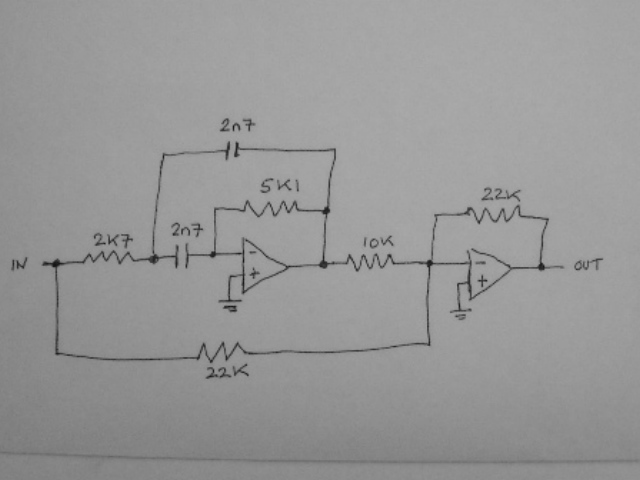

compenstation cap for 2nd order allpass delay circuit
2 questions regarding this circuit.
Does it need a stabilitly cap to stop hf oscillations?
How is the input impedance calculated?
It needs a cap only across the feedback resistor of the second OPA. With the aid of a square wave generator (at 10KHz) and a scope connected in output,try values between 22pF to 220pF to find where the overshoot of square is eliminated.
