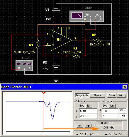

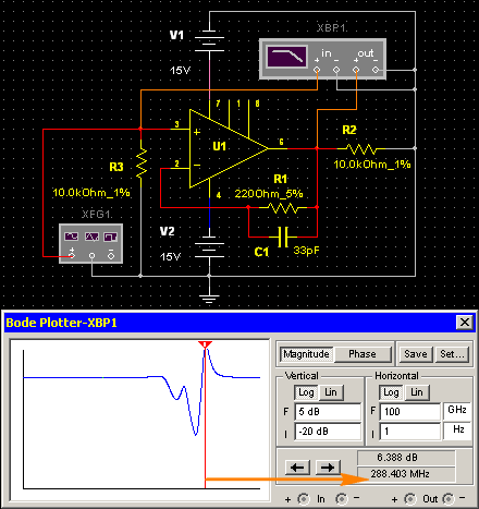

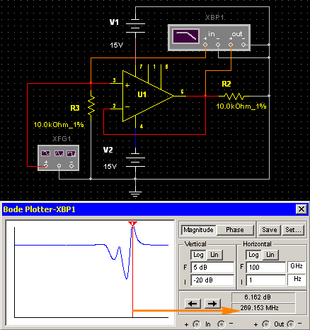

Over the past few days i've been designing some new audio circuits. I decided to experiment with different values/types of compensation, instead of the usually quoted/shown ones. In this instance these are buffers.
For years in Numerous articles etc etc, for the feedback i've seen either, a direct link, a resistor, or resistor & capacitor.
I was surprised to see the differences between them ! I discovered that a solitory resistor was best ;)
I realise the peaks are @ Very high f's, & it's a buffer, but i'm wondering if this discovery "might" affect the performance of other circuits in some way/s, positive, or negative, when other factors are taken into consideration, such as other means of compensation etc are included ?
