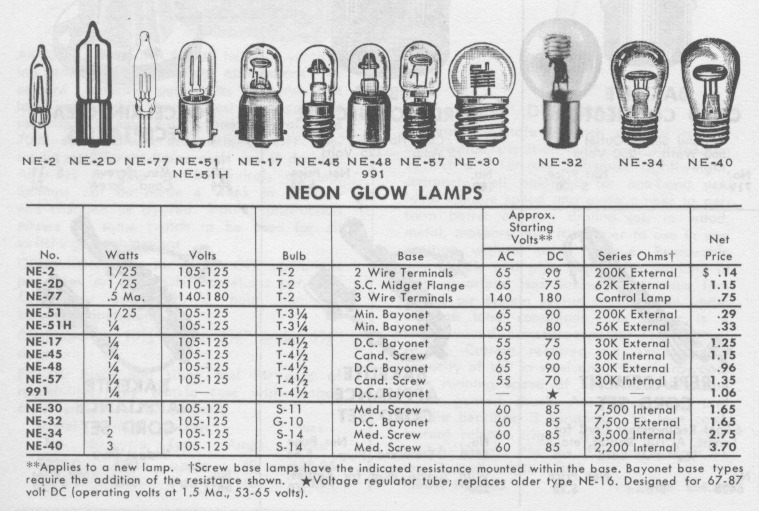

For the adventurist & curious why not try some neon bulbs from the past?
And add color & flashing lights to your project,
The list of prices is from a 1960 catalogue The pdf is a 'how to' document.
Many odd circuits are possible,
There was a 3-terminal device that looked like an NE2 but I've not been able to find any data,
Logic circuits were possible, one of the guys in the lab built a small running demo circa 1960.😆

A more complete 'how to' manual by General Electric is at
https://ia803107.us.archive.org/17/items/GE_Glow_Lamp_Manual/GE_Glow_Lamp_Manual_text.pdf

I disagree with the suggestion of simple neon bulbs like NE2 etc. The almost constant voltage over a wide current range results from the large cathode area of VR tubes, which neon bulbs don't feature.
