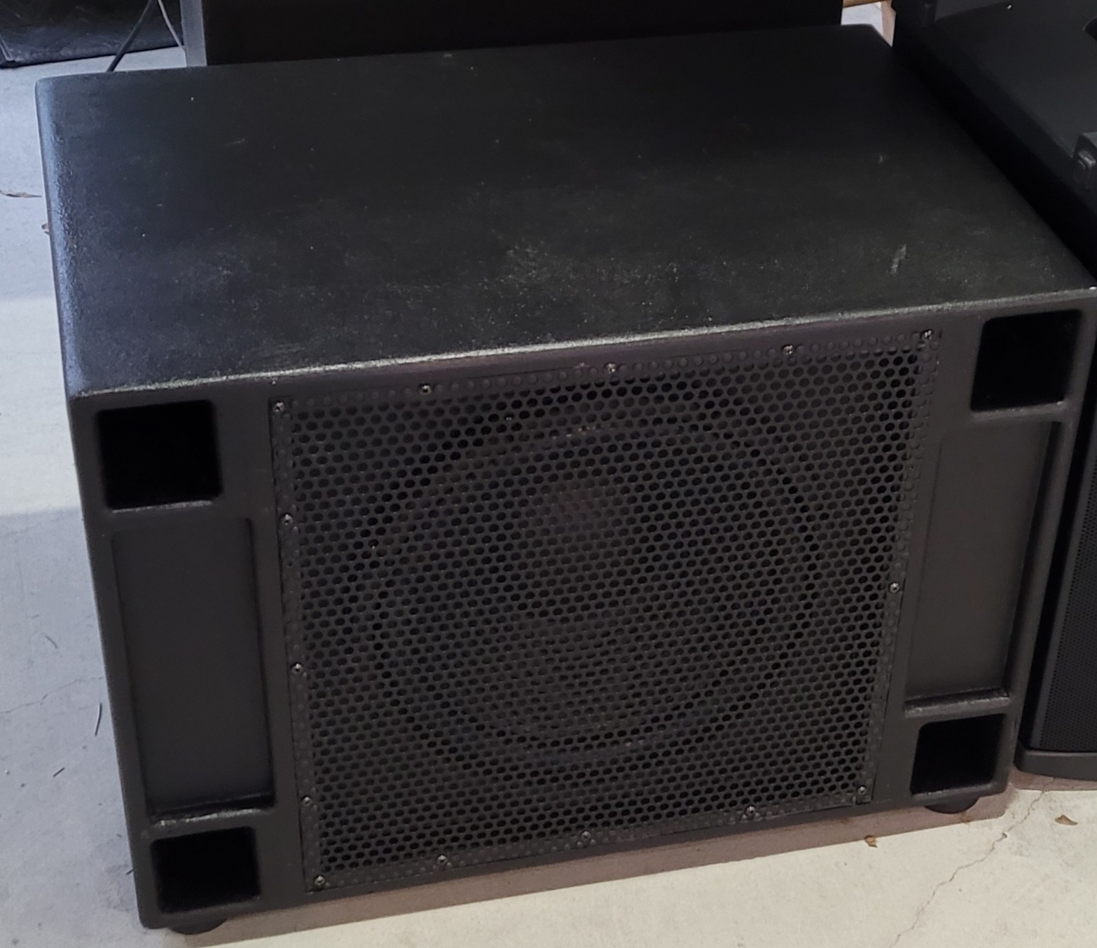

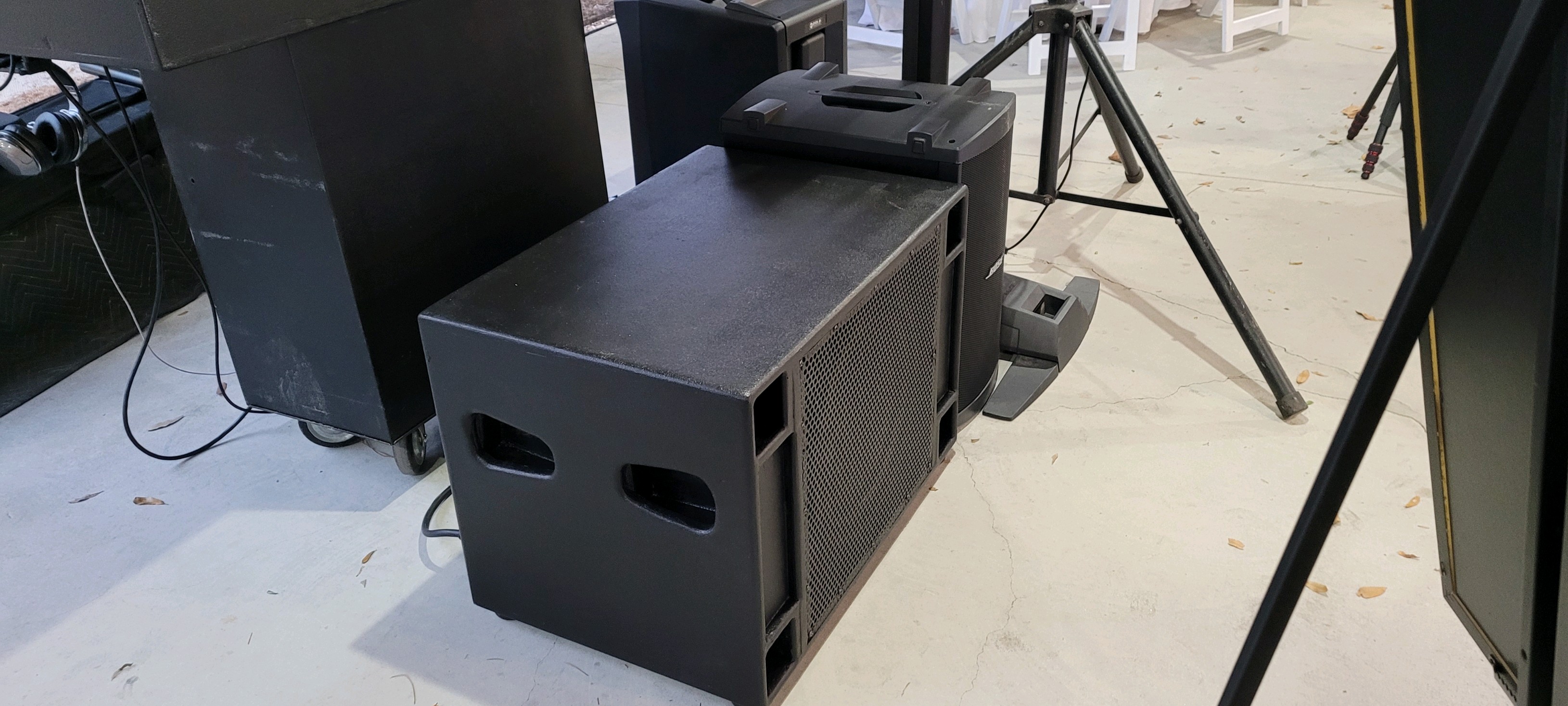

OK ---so here is a follow up
I built the reflex box (5.5 ft3) in the style of a Bass Boss SSP118 simply because I like the look. Box is tuned to 32hz using the above mentioned Ciare 15.00 SW-4
It worked out really well. I used it at a gig (Nov. 6th) along side a single Bose L1 Model 2 with B2 bass module. I used the "Sub out" of the Bose amplifier since it limits the B2 to act more like a traditional 2way top - it adjust the processing when it detects a connection from the port.
The event was around 150 guest and I had really good sound on the dance floor and across the venue.

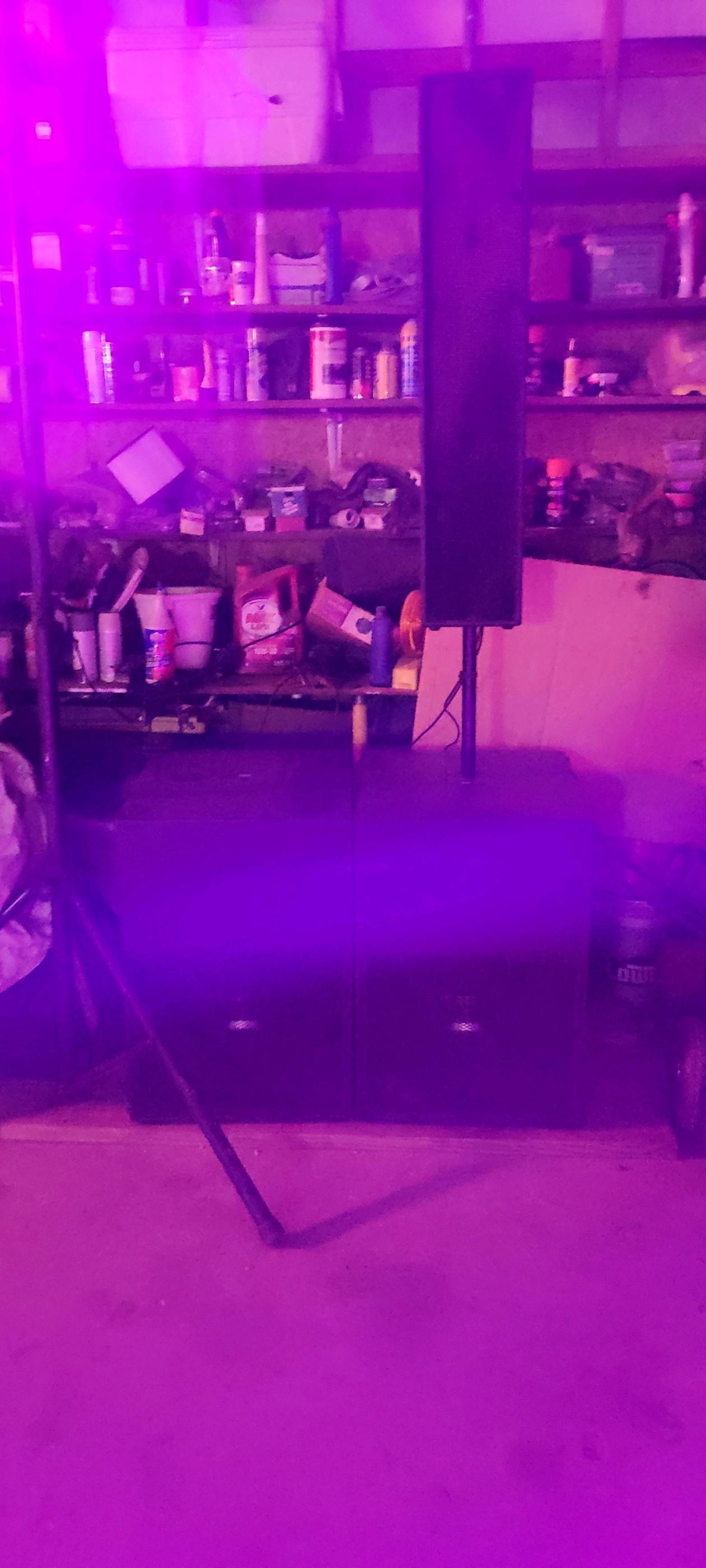

Flash forward, this past weekend (Nov 13th) I used my 2 JBell SS15s along with my2 - NXL24 copies and was still blown away with the output. I had my amplifier limited pretty much about the same for the 2 SS15s as I did for the single reflex 15 the weekend before. Since the response of the SS15s was more pleasing to me it leads me to believe that the performance below 40hz is not as important (to me) as mentioned in the earlier post in this thread.
This left me still curious about building a smaller TH, Hybrid, or Paraflex using the Ciare 15.00 SW-4 to get more output.
So this morning I did some more reading.
Here is what i am considering trying:
-Cubo 15 Extra Extended (single sheet ply) (620x620x620)
-THAM 15 (single sheet ply) (500x680x550)
-Paraflex Alt-Con 1x15 (2 sheets ply) (446x915x765)
What are your thoughts?
Please keep in mind I am not great at planning out these horned boxes, but I am good at building them so I PREFER a box that already has readily available plans (as these 3 above do)
Also- excuse the mess in the SS picture, I cant help what the "host" workshop (100'x60') looks like.
