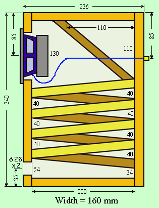

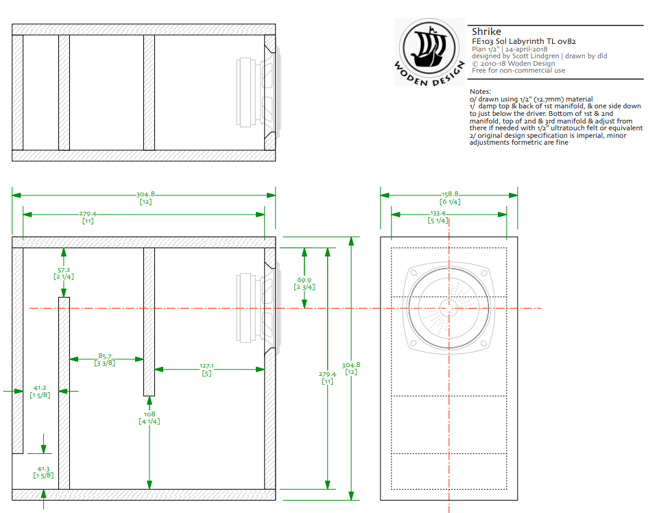

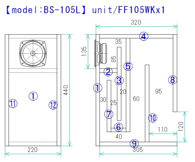

Compact Horn FE103
Non of these are horns as in that that the mouth area loads the driver close to the lower cutof frequency
1. is a resonance pipe (of quarter wave lenght) Positive flare (increase resonance frequency) Constriction Decrease frequency
2. is a resonance pipe (of quarter wave lenght) Positive flare (increase resonance frequency) the most "horn like"
3. is a resonance pipe (of quarter wave lenght) no flare AFAIK
I would go for a Voigt pipe of similar size or really go for a large real horn that will be way bigger.
Okay, now I have another enclosure, the Wodendesign Shrike, that's a good fit in terms of size. Would it work with the FE103—it's designed for the FE103SOL?And the most important question: which of the four enclosures would be the best?
I definitely need bookshelf speakers!
Thank you

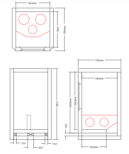

You are right, with the Fostex FExxx struggle to do bass, needing aid wifrom cabinet (horn) and amplifier with high Rout. The FFxx5wk are happy in a reflex box, best one IMO, is the 3” FF85wk. Boxes are “tiny” (2 litre), here with the older FF85KeN. The newer driver fits the same, and a slightly larger box (2.5 litre).
The FF105wk is exactlynthe same basket as the FE103, it doesn’t extend as far down as one would hope for the increase in driver size.
How big a box is acceptable?
Most potential for bass extention with a 4” driver that i have tried is the Markaudio P7HD. Optimum miniOnken is 9 litre but it can fit 5 litre. These are examples of the box (as was with the old FE127e). We have fit a surprising number of drivers into this box, with only changes to the vent spacer (and driver mounting details).
But if you want a "bass monster” and can live with 10 litres, i think i can fit CHN-110 into that size box. This is Pluvia 11 (same size) in a 9 litre CGR for reference.
