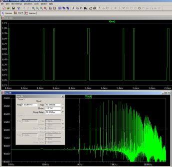

Thanks for your contributions, but I want to generate a binary sequence, not a succession of digital words.
And I would preferably like to use some form of theoretical reasoning. I'll take an example:
I want a spectrum similar to that of a Dirac pulse, thus I start with a short pulse having a repetition rate of 1KHz. The pulse has to be short enough to obtain a flat spectrum up to the 10th or 20th order; this is no problem.
The problem is to remove the fundamental; I can do that by adding an identical pulse having a 180° shift. If I use an identical pulse however, I will remove not only the fundamental, but also all odd-ordered harmonics.
This means that the added pulse must have the same fundamental contents, but also a spectrum that adds energy to the existing harmonics, to keep the spectrum flat.
This can be done by splitting the pulse into two shorter pulses, symetrical about the 180° mark: see picture.
There is still a fundamental leakage, but this is no real problem: I could fine-tune the small pulses to remove it completely.
What is more troublesome is the disturbance to the amplitude of the harmonics: they are all present, but not equal anymore, and trying to fix it by trial and error seems an impossible task: if I "repair" one part of the spectrum, I'll damage another.
So I would like to take my reasoning further and find a clever, deterministic way to place additional transitions at the right instants, but at the moment, that's where I'm stuck.

Yes, exactly, and that's the reason why the additional pulse is split into two narrower pulses, as you can see on the sim (sorry for the quality, that's all the forum would accept). This leaves the odd ordered harmonics, but the amplitudes are not correct, because I picked the pulses width and timing more or less randomly.wakibaki said:

The waveform shown in the sim is not overly complicated, and yet it nearly fits the bill. I could easily improve it by a trial and error method, but I find it preferable to use a direct, mathematical method. If I have no other choice however, I will revert to the blind method.
