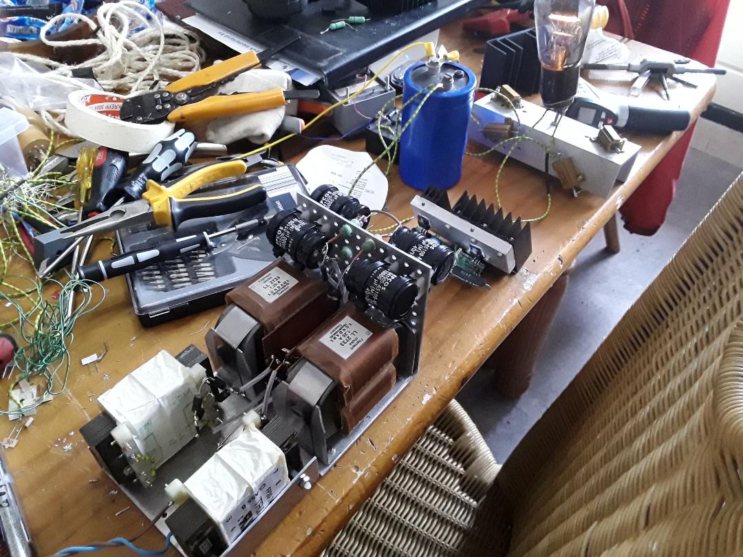

See my Vt25A 7,5 V 1,25 A supply. i used triad split bobbin and a choke input with lundahl LL2733. greetings, eduard
P.s as you can see they need a decent cooling.

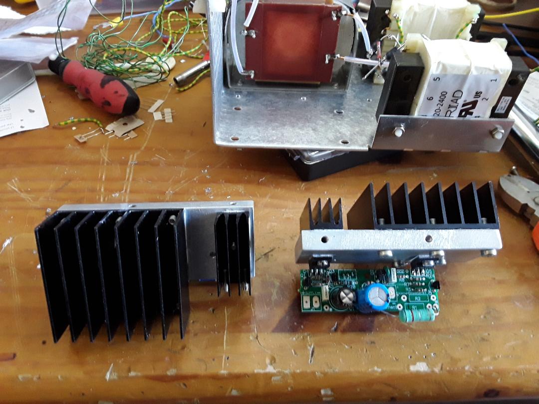

Nice craftsmanship eduard! Is that a solid chunk of aluminum spreading the heat below the black heatsinks?
For what I'm thinking of doing heatsink-wise... do you think the TO220 devices can be connected to the board with a short 2 inch umbilical instead of being a soldered part on the board itself? If this is ok to do, this will give me more flexibility on positioning the heatsink on the chassis because it would not have to physically carry the whole board too. Freeing the TO220 device from the board makes heatsinking through a chassis top pretty easy because parts are separated. I was thinking of using CREE round LED heatsinks because they look cool on a chassis top, I sand, polish and anodize these myself. Using caustic soda, RIT clothing dye, and a car battery charger and acid.

It is indeed a solid chunk of aluminium but the temperature was on the higher side so i ordered two cheap heatsinks at mouser to lower the temperature considerably.

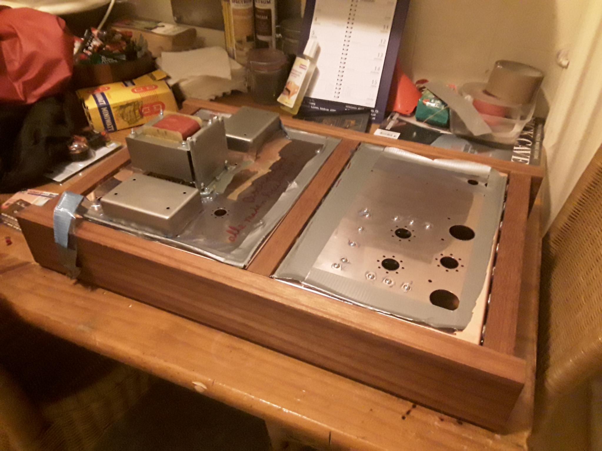

The aluminium was thrown away at work so just had to cut it to the right length, add some holes and two threaded holes to mount it on the inside of my future chassis which will look like my last line amp in the attachment.
With the way i constructed the Coleman it can be moved easily because it needs just 2 M4 holes to be attached to the top plate.
The other aluminium metal construction holds two transformers, two input chokes and the caps that will feed the two Colemans which will be mounted right under the tube.
