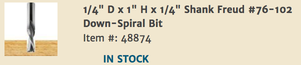

If you use "down spiral" router bits almost all the sawdust goes straight down. With a shop vacuum and a funnel (can be made from cardboard and taped on the hose) below the hole, clean up can really be minimized.
I need to get some more down spiral bits, they were out of them the last time I went to the wood worker's store that carried them, so have been again putting up with the dust cloud from straight bits on the few projects done lately. Should have ordered them online instead of settling for straight bits, but needed some non-smoking bits right away...
Art
that is ironic. I started out with a down spiral bit but all the sawdust jammed the slot I was carving and it didn't work well so I switched to an up spiral bit, which did indeed spread the dust all around. My DeWalt router exhausts dust up through the tool but its only 50% effective so I need to fab a transparent shield for the opening in front of the bit and then find a way to keep the vacuum hose from tangling as the tool traces the circle.

The jig maker recommends an up spiral bit. I think the person recommending a down cut was assuming we could make the full cut in one pass. Then that makes more sense. 🙂
I have found though that the dust is controllable with a few sheets of cardboard strategically placed.
