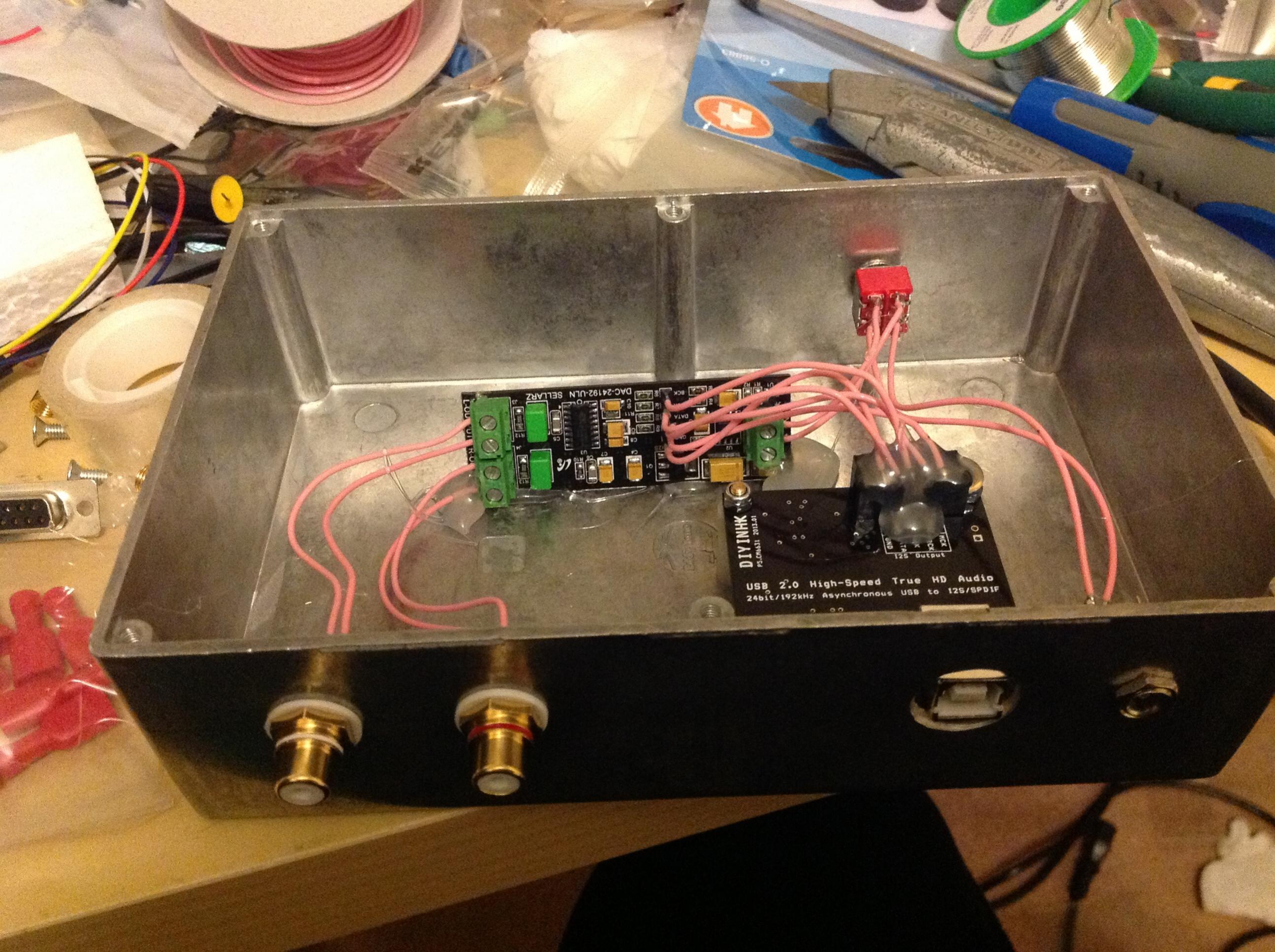

I ended up buying these pcbs.....
24bit 192kHz USB to I2S / SPDIF PCB CM6631 with ultralow noise 6.5uV regulator | eBay
DAC-24192-ULN, 24Bit/192KHz DAC, I2S Input, Ultra Low Noise Regulator Circuit | eBay
I downloaded the diyinhk cm6631a drivers but had glitches at all sampling rates on two windows 7 64bit laptops (not normal laptop noise, actual interruptions to the stream). Rebooting into Ubuntu has solved the problem completely, and the Dac sounds nice - quite solid sounding yet open and clean.
Photo below....
Sharpi31 - good project.
Can I suggest ?
It is good to twist audio wires into a twisted pair. Your wires have not any twist. Twist power/ground together. Twist signal/ground together.
It is good for digital to have one ground wire for every signal wire. You can use flat cable or twisted pair. All short as possible.
ES9023 can sound better with asynch mclk - 50Mhz SAW from Epson use as mclk into DAC. Maybe you want to try ? You change quite easy and it is not expensive.
Also to try, if you want, is output cap (green Wima ?). Relcap RTE must sound good. Mundorf also. But this not so cheap.
