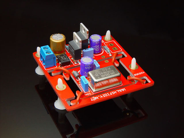

I see another site http://diykits.com.hk/ with low jitter clocks for $20 but no specs given. These clocks seem to have a screw suggesting some form of adjustment! What would this be used for?
In both of the sites they seem to use the same PCB with double 317 regulator board & a clock board suspended by bands!
