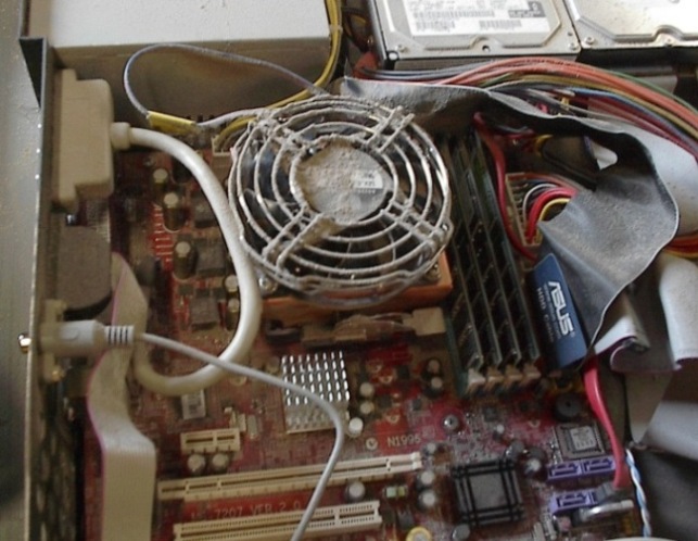

Conrad Hoffman said:I really need to blow the dust out of my computer before it cooks. The operation usually results in a giant dust cloud that drifts slowly across the road.
Mine, before cleaning with my compressor.
On old electronics I've used automotive brake cleaner. It leaves no residue.
I agree, that works great for a computer. I use my compressor on it about every six months, and it really gets the dust out of it. the fans pull it in quite easily.
