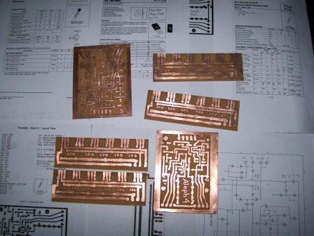

Hai Mr Pass
I am would like to ask about Aleph Power Ampliifer
Now I am during prepare spare parts of Aleph Power Amplifier
I need 150 Watts rms Power out put.
How many Mosfets per channel ?
How many micro farad of Capacitor?
How many Ampere ( VA ) of Toroid Transformer ?
I am all ready make PCB Aleph 4 but at there just for 12 Mosfets ( 100watts )
Thank you
regards
Agus

Agus,
Just follow Aleph 4 or 2 circuit as is and you are assured you will enjoy what you have built. 🙂

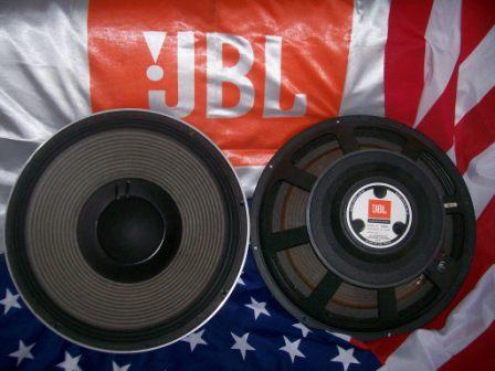

Actualy i need Aleph with power out put 150watts.. because my speaker double 10" woofer (DIY) and usualy i am use for liestening my favorite music JAZZ Fusion ( Four Play ) now iam runing with my diy bipolar power amplifier 300watt. and for liestening JAZZ vocal music i am use JBL S26 . and for the future i am have planing to drive my JBL woofer 2226G VGC with Aleph Power Amplifier. please your advice! Thank you!

Agus,
2226G...for jazz😱 I'd personnaly advise 2235 or 2234
they are more commonly used in Hi fi applications...the 2226 is a PA woofer not really for hifi applications ...unless you consider changing the spyder and suspension for softer ones...,
I tried it already...a pass 30w will drive it easily, the problem doesn't lie there...this speaker has a heavy cone, with cone breaks quite high around 1K2, making the mid range a bit hard to cross-over...as well it can be fitted in small volumes, but with low output under 70HZ...

Yups...! Mr Bob,
thank for your advise and 100% You rigth! JBL 2234 is driver wofeer for JBL 4435 LR . I am just had on hand stock JBL driver wofeer 2226G.

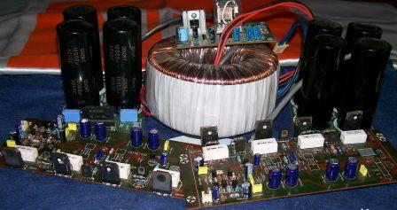

Mr zionrider soory actualy i don't have Schematic of my gong power amplifier.. because the my pcb" ex" from the other power amplifier ( giving from my friend )i am just remove all parts and put the new parts and better parts..
