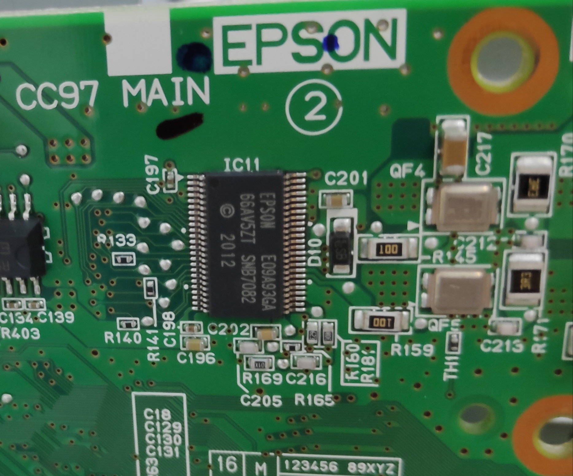

Looks very much like you are trying to recreate the drain waveform on a single/two switch forward/flyback convertor?
It is for piezo actuator use.
I know that waveform. It's from a piezoelectric printhead
The original design actually switches up to 5MHz.

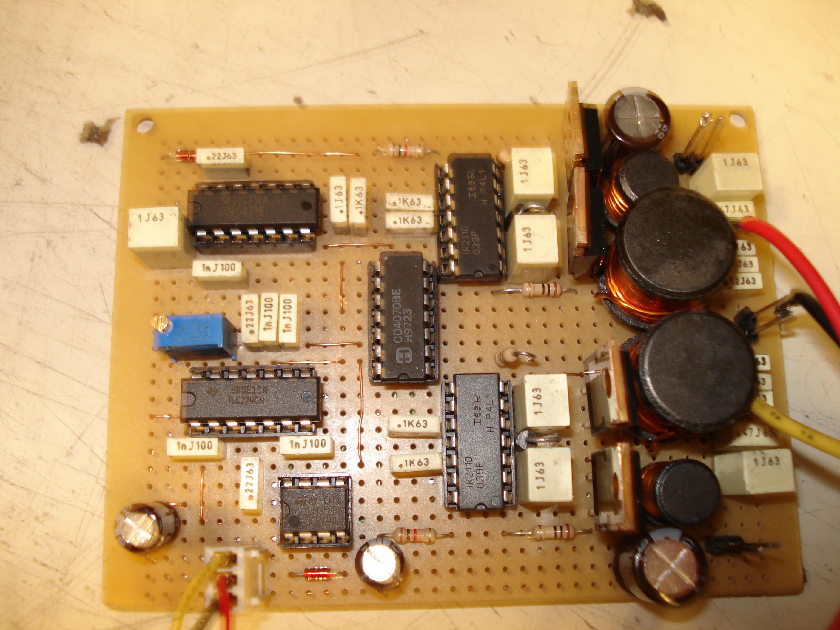

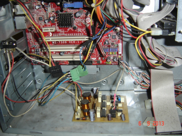

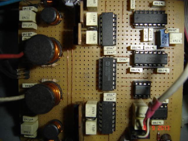

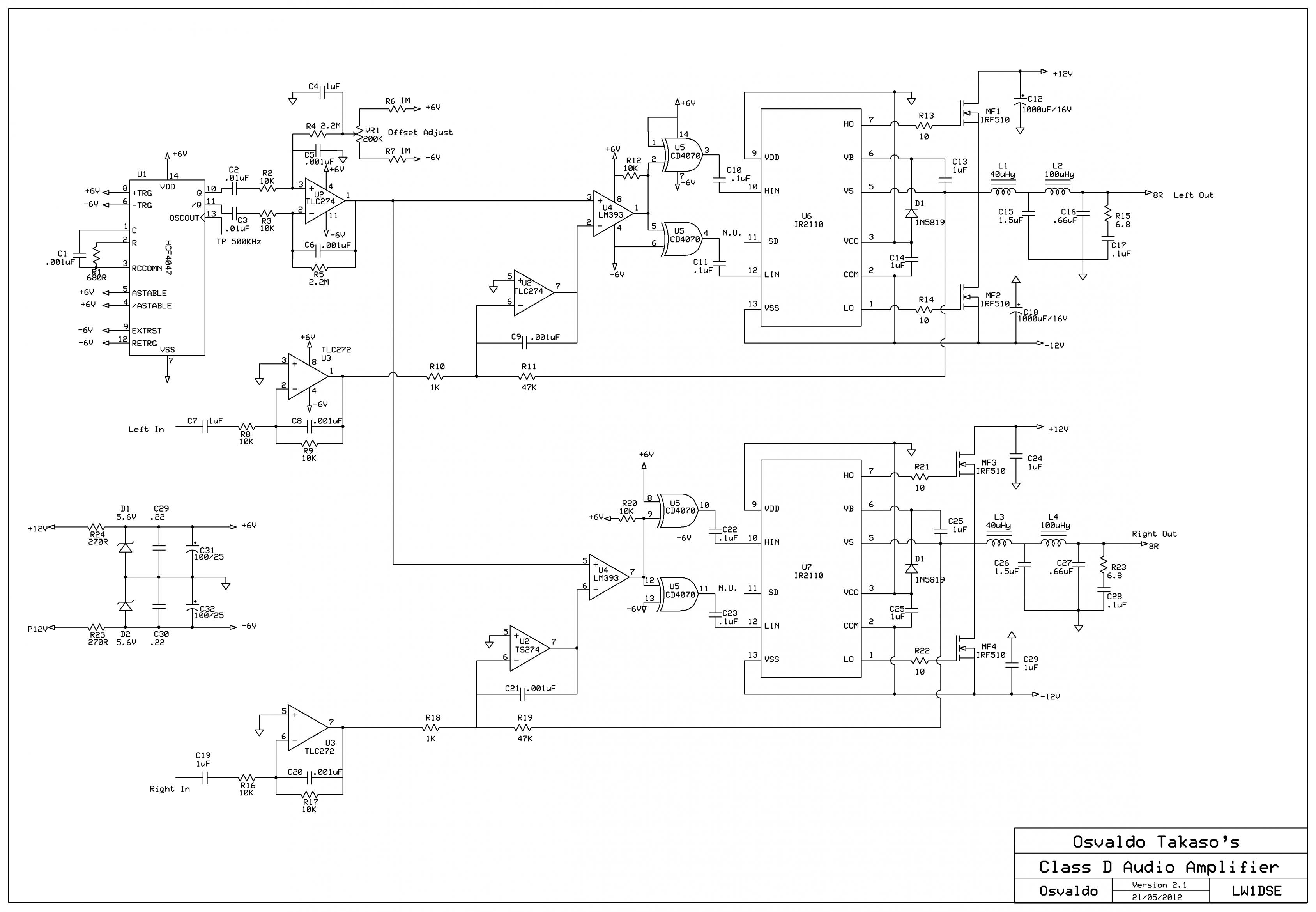

I have used ganfet with some success to replicated the waveform, but I do not have time to debug everything. Class AB with heatsink and some airflow work fine for us.
