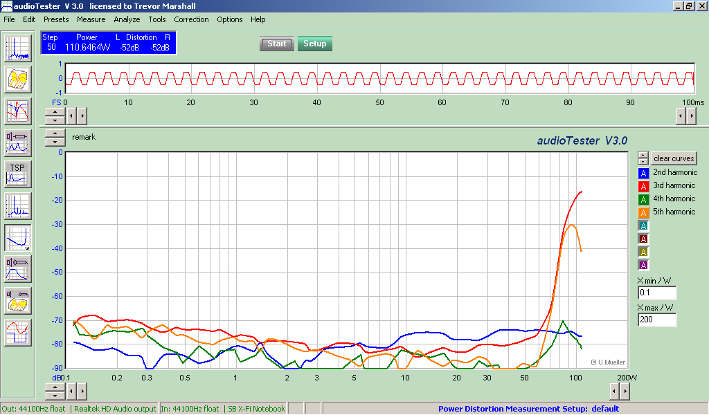

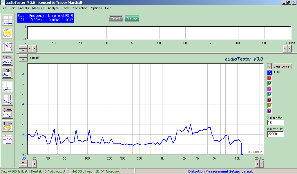

I started by reducing the SURE board's distortion at high frequencies by ten times. From 3% to 0.3%. By changing just two components on the board. But you can see on the photo below the full set of changes I made to the SURE assemblies before I was happy with them
The result has been to make my SURE TDA7498 assemblies into top-notch (IMO), clean, powerful audio amplifiers. More than adequate for the compact HiFi speakers they are intended to match.

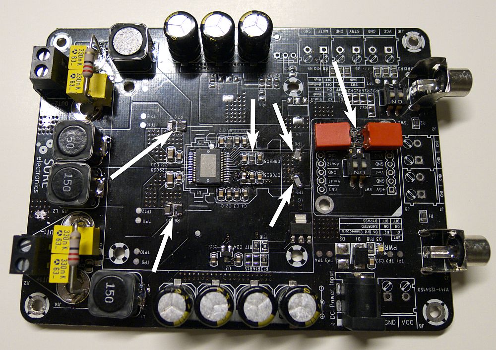

The leftmost attachment is the (final) modded board (without the heatsink) with the measured 8 ohm THD vs frequency curve next to it, followed by the distortion vs power-out curve. Note that I have separated the second, third, fourth and fifth harmonic distortions on the power-out curve to make it easier to see the interplay between even and odd harmonics.
The complete tutorial is on my website at Trevor Marshall - Class D Audio Amplifier Design - TDA7498 Output filters
This output filter topology will work equally well with most of the new >50W bridged amp chips now in the market.

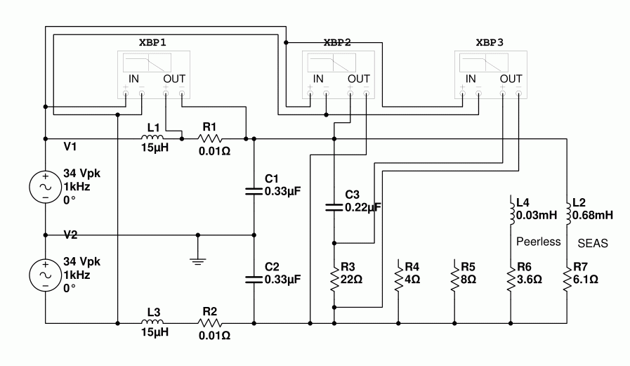

Glad you found it useful. I have now updated my webpage with the MultiSim simulation file, so you can replicate my results, and explore the design issues in more detail. The schematic is attached below.
I have placed 0.01 ohm resistors in series with the inductors to allow me to plot the inductor (and FET switch) currents. There are three Bode plotting instruments, XBP1 for the inductor current, XBP2 for the output voltage vs frequency response, and XBP3 to show the voltage across the damping resistance, and hence allow its power dissipation to be calculated. A compromise has to be struck between power dissipated in this resistor at high frequencies, and the damping applied at the filter resonance. In this case, I decided to ensure that the peak current was just within the capabilities of the FET switches in a good TDA7498 (7 amps typ.)

You may be able to keep the class-d board inductor and let the cutoff freq change by changing the capacitor to match your speakers. If the inductor looks pretty good.
I did a rough approx in Excel and it looks like the freq won't change enough to be a problem. And I am confident that getting the Output filter to match your speakers will make a much greater difference than changing the cutoff frequency, as long as the frequency stays significantly above 20,000Hz (i.e. 35,000 Hz or so).
To get the capacitor value to match your speakers, first solve:
f=1000*(0.2251*Rs)/Lf
This gives the new cutoff frequency using the actual value of the on board inductor. Remember to change the value of the inductor from uH to mH for the equation then change it back to get the final value. If the cutoff freq is more than 35,000Hz you can keep the inductor.
Then solve for C:
Cse=1000000*(0.1125/(Rs*f))
This will give you the capacitor for the output filter (not the zobel, don't confuse the two).
You can then unsolder one lead from the on board output filter capacitor (or capacitors if the output is BTL) to disable it. And, Disable the on board zobel by unsoldering one lead on the zobel capacitor or resistor. Now you can add an outboard output capacitor(s) and zobel on the outputs with test leads and play with the values. Don't worry about the stray capacitance and inductance of the test leads. Just keep the leads fairly straight.
If your output is BTL, the capacitors you should use are:And since the T2 output is BTL:

You do realize that I used a SPICE emulation to understand and optimize my design? Have you read what I actually did before making your suggestions about using Excel?

If you download the evaluation version of the MultiSim software I used then I posted the file which is already set-up to emulate the filter at:
http://trevormarshall.com/class-d-tutorial/Trevmar_output_filter.ms11
All you have to do is flip the toggle switch on the GUI to start the emulation running
I have set up the current and voltage plots
The info is near the bottom of my detailed info page at:
When the MultiSim evaluation period runs out, there is a student version of the MultiSim software available for $40-$60, and the simulation runs just fine on that.

Trevor,
I'm trying to get a handle on all of the specific things you did to improve this amplifier. I'm actually considering getting the 6 ch. version of this and modding it as per your findings, and using three of them for a multi-channel amplifier build. I have attached Sure's schematic for their 6 channel version, and I have attempted to enumerate where your mods would be on the 6 channel version, so all component numbers below refer to the attached 6 channel schematic, with the exception of the added damping circuit which refers to your component names in your SPICE schematic. I have only listed the component numbers for the first TDA7498 chip, as I would duplicate on the other channels.
Could you go through this list and confirm that this is what you did and answer some questions?
Thanks!
Input section:
May: Replace Input Capacitors: MKS polyester (1uF)
C5, C11
How Important? Add 1nF bypass capacitors from signal input to ground:
Since Test Points are now on the input side of the input coupling capacitors (C5, C11) What is the optimal location of this? Does it need to go from ground to between C11 and INPA (pin 22), and from ground to between C5 and INPB (pin 32)?
Also, the reference design has the same configuration (1uF coupling, 1nF bypass) on pins 23 and 33. This is unnecessary since the - input is always tied to ground, right?
May: Decrease Clock Frequency:
R8 (33K) Replace with 30K
Why? Does this make a big difference, or affect the output filter for some reason?
Snubber circuit:
R14 / C41, R15 / C45
You say 'add' the snubber circuit, but it looks like it's already in the schematic at the listed component locations. Did you just swap the 0.1uF caps for 0.33uF caps that are the value recommended by ST, or am I missing something?
Output Filter:
Must: Replace Output Capacitor: MKS polyester (1uF)
C42, C46
Must: Replace Inductors: Bourns SRF1280-150M (15uH)
L1, L2, L3, L4
Must: Replace Existing Output Capacitors:
C43, C44, C47, C48
with MKS polyester 330nF/63V caps, soldered to banana plug pads and ground plane vias
Must: Add Damping Circuit:
On your SPICE circuit: C5 (220nF), R9 (22 Ohms, 5W)
from out+ to out- on binding post pads

Replacing the input capacitors is explained in the application note which I linked on Ceramic input capacitors. It reduces low-frequency distortion, but loudspeaker distortion is always going to be dominant in this region. Makes the amplifier specs look better, though
Hope that helps,
Trevor
It provides a high-frequency ground. I saw no change from doing this, I did it to match the reference design, and because I already had the capacitors lying around...How Important? Add 1nF bypass capacitors from signal input to ground:
Since Test Points are now on the input side of the input coupling capacitors (C5, C11) What is the optimal location of this? Does it need to go from ground to between C11 and INPA (pin 22), and from ground to between C5 and INPB (pin 32)? Also, the reference design has the same configuration (1uF coupling, 1nF bypass) on pins 23 and 33. This is unnecessary since the - input is always tied to ground, right?
Again, my goal was to get the best performance I could out of the TDA7498, and raising the clock frequency measurably reduced the distortion.May: Decrease Clock Frequency: R8 (33K) Replace with 30K
Why?
It is on the SURE schematic, but the parts are not on the boards they ship. And SURE's changing a 100,000pf capacitor to a 330pF is a very big deal indeed at that point in the circuit.Snubber circuit: R14 / C41, R15 / C45
Again, refer to the application note on distortion in ceramic capacitors. This made a huge difference to the distortion in the mid and high frequency ranges.Output Filter: Must: Replace Output Capacitor: MKS polyester (1uF)
C42, C46
C43, C44, C47, C48
This is particularly important at higher supply voltages (above 24V) and to provide a stable peak out currentMust: Replace Inductors: Bourns SRF1280-150M (15uH)
L1, L2, L3, L4
This also provides damping to stabilize the feedback loop and reduce the peak current from the TDA7498 output switches to values less than their 6-8 amps maximum rating.Must: Add Damping Circuit: On your SPICE circuit: C5 (220nF), R9 (22 Ohms, 5W) from out+ to out- on binding post pads
Hope that helps,
Trevor

Snubber circuit:
Output Filter:
C42, C46
L1, L2, L3, L4
C43, C44, C47, C48
I just received my 6x100 board and am experiencing the same problems. I would like to perform the "Must" upgrades you listed. Have you performed them and how did they turn out? Also, where did you get the parts?
Biggest problem is my board cuts out at 3/4 volume. I'm sure the distortion is there as well.
Any advice appreciated.
Thanks.
If you have a pre-filter NFB topology, as with these amps, the load impedance variation can play havoc with the FR above 15kHz or so. The simple solution is to raise the switching frequency to above 500kHz, so that the -3dB point of the output LP filter can be up at 50kHz or so, which means that normal speaker impedance variations have little effect up to 20kHz. I believe that these old Tripath controller and modulator chips self-oscillate at around these frequencies, compared with post-filter NFB topologies such as ucD which often are running at 300kHz or so.(I realise that the TDA7498 isn't a Tripath self-oscillating topology, but is a pre-filter NFB design)
As has been mentioned earlier: don't use ceramic X7R surface-mount caps (even lots in parallel) in the output filter. I did this years ago, and found (even with a post-filter NFB design) that the distortion was still approx 3X as high as with through-hole film capacitors. With pre-filter NFB, the distortion change may be even more.
