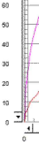

What do you mean you don't see low power specs? You can read the graph down to about 1W,
Just read what I wrote! Max. 100 mW.
where their efficiencies are about equal. Why would you bother calculating efficiency below a watt for a power amp? The most power that will be wasted below 1W output will clearly be less than a watt.
Of course not. On figure6 you can see definitely less then 50% efficiency at 1W output, so wasted power must be higher then 1W. On figure5 you can see ~2W loss at 0W output power, while loss of ClassB (red curve) reaches near zero! Don't guestimate, when you have relevant data!
My point was that there's no need to be concerned with efficiency at 100mW or less with a power amplifier. Class d is less than 50% efficient at 1W but class ab is even worse.
In the attachment is a portion of the efficiency vs power output graph from my previous link. The visible tick mark on the x axis is 2.5W output, the next line I added is about 1.125W output, and the next is about 0.5625W output. At 1.125W the class d amp is about 25% efficient while the class ab is around 7% efficient. Around 0.5626W both amps are clearly under 5% efficient and the power dissipation mainly depends on idle losses in the amplifier.
Then don't say untrue things about an amp, only say that you just can't hear the sound what is the highest room volume for me!
