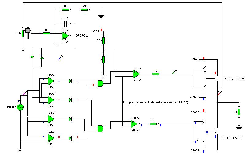

This is a design of a self oscillating amp with no need for a ouput filter if you dont mind a bit of EMI being splashed around the room. Any suggestions of how to improve this circuit would be more than welcome as i plan to build it or something similar in a week. Sorry for the croc clips but its SO easy.
The ouput trannies are actualy fets.
Any suggestions / comments?

hi because the lm311 is not a linear device, and the output is either 1 or 0. There is not a slew rate that can be measured accuratly. Therefore the response time is what is used. This is the time it takes for it to go from one state to the other, 200ns is fine for this amplifier.
This schematic is just a concept and has not been tried or simulated in anything more accurate than crocclips, therefore i cannot assure you that it is correct.
I would suggest that you get swCAD III and build it on that.
As for the +-50v supply, A voltage level shifter would need to be added to allow the fets to switch, Dead time would need to be added because otherwise it would turn in to a mosfet killing machine.
I suggest you start off on a 10w - 20w amplfier first and then move on to more powerfull ones, because the difficulty level realy steps up when trying to use higher voltage rails than the op-amp output.
Rember that when using a voltage compairitor you need a resitor from +vcc to the output in order to get a voltage at the output!
The operational amplifier in the intergraitor needs to be quite fast as it needs to slew 0.7v for every oscillation. a voltage comp CAN NOT be used here.
As for the and gates, they are essential to the working of the circuit and cannot be removed.
You can only replace a opamp with a voltage comp if the opamp is open loop.
