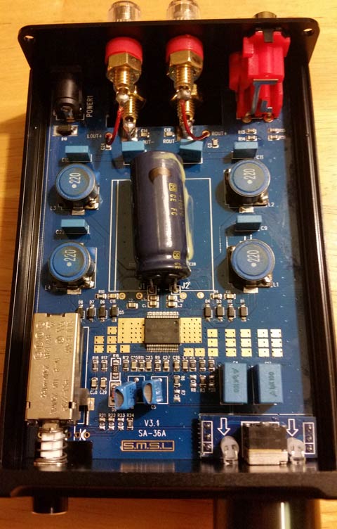

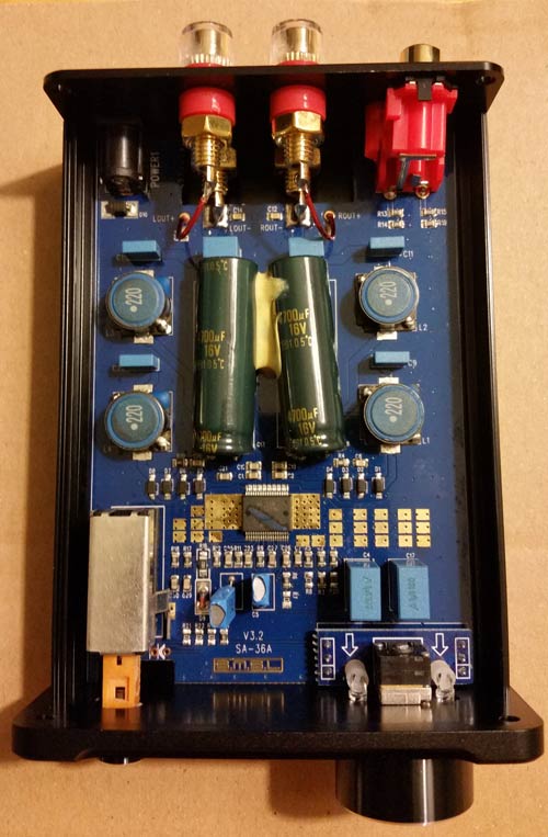

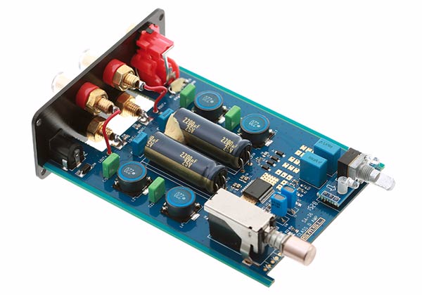

Hi all, a couple questions that I'm hoping to get clarified. I'm a total novice who's done a little reading so bare with me.
When upgrading or choosing electrolytic power caps, I see a lot of variety in the capacitance recommended, or actually installed on stock amp units. For instance, on a few units of a SMSL pre-built amp, 16v caps whether single or multiples in parallel, there's a total of 4400uF one (2 in parallel), on another it's 5600uF (single), and on another its 9400uF (2 in parallel). This is on a stmicro tda7492p board. Here are some pictures:
1. Assuming the same quality low impedence-ESR line of caps, why choose one amount of capacitance over another? Taking for granted there is a lower limit, isn't there also an upper limit - with capacitance discharge at larger values starting to affect rate of discharge and thus affecting peak signal timing/distortion? Maybe I'm completely misunderstanding this.
2. Are there any acoustic properties at a set input level that would be affected by the capacitance you choose? I've seen reference to larger capacitance for more bass response or certain size of speaker driver...
3. Are there ways to calculate what a recommended range would be?
4. When combining large wet and small polymer caps (popular oscons), if I understand it this is done to take advantage of the polymer treatment of high frequencies?
5. Since polymers cycle much faster than wet and typically have lower capacitance, is there a calculation or ratio to determine equivalent capacitance between the 2, like 220uf polymer = 660uf wet? Or this a bad comparison because 1uF = 1uF; its the performance characteristics that are different. Is this important in a mixed parallel arrangement, or what if you want to replace a wet with a polymer?
Thanks, lots of great info on this forum!

Also, since that amp you have pictured is so simple, you might consider installing higher quality resistors with really tight tolerances. Will it drastically improve the sound? Who knows. But for $5 and little time, it might be worth finding out. Though I strongly suggest reading up on resistors before touching them as they need to be able to handle the wattage, etc.

Yes, lets do the math for your TDA7492 based amp. We will take the data from datasheet.
Po = 50W
RL = 6R
Vpeak = sqrt(Po * Rl) = sqrt(50W * 6R) = 17.32V
Ipeak = Vpeak / RL = 17.32V / 6R = 2.88A
Cbulk(min) = (Ipeak * Td * Dmax) / (Vripple)
with Td = 1/fsw (switching frequency) - lets take worst case minimum fs from DS = 250kHz
Dmax = maximum duty cycle, unknown so we assume 0.95
Vripple = dV = maximum voltage drop allowed at Ipeak, we assume 0.1V (even 1V wouldnt be an issue)
So:
Cbulk(min) = (2.88A * 1/250kHz * 0.95) / (0.1V) = 110uF
As we have two channels, we'll need at minimum 2x110uF = 220uF.
ESRmax = Vripple/Ipeak = 0.1V / 2.88A = 34.7mR
So either we have 2 caps with C = 110uF, ESR = 34.7mR or 1 cap with C = 220uF, ESR = 17.35mR.
This will be the minimum specs your bulk decoupling should have. When going for 400kHz its even less.
As the caps derate/ages with time, you'll choose your capacitance way higher, like twice so a 470uF <= 17.35mR would do.
The point for having those "big" capacitance values actually in place is, that the cap needs to handle Ipeak as ripple current while having that low ESR. As bigger capacitance usually have higher current handling and lower ESR those are choosen. But they wouldn't need that much capacitance.
