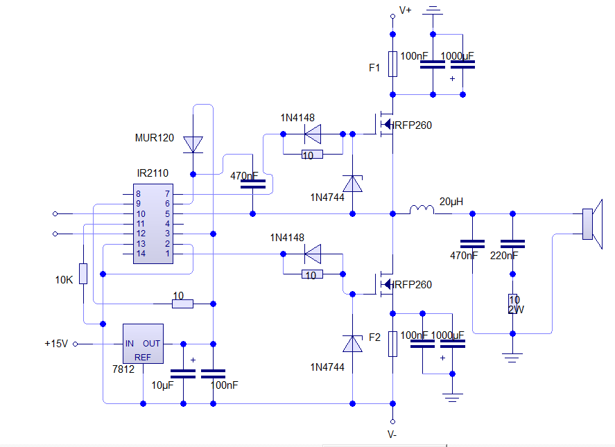

Look this, I was created few minutes ago. I want IR2110 and IRFP460 or IRFP260 because I already have this IC and power mosfets..
I looked the datasheets and examples of other people for IR2110 and I think that shematic is corect, can you chack this?
I dont have an idea for comparator (pin 10 and 12 of IR2110)!? I have shematic with TL071 and LT1016, but this LT is very expensive in my town, have you some other proposition, something simple and good?
I cretade PCB only for this what i have, it's small. Capacitors od 1000uF and 100nF of power rails are very close to power mosefets. everuthing is very close, but nice deployed and i think will be functionally.
which voltage do I need for 300 350W, i think +-60-65V, is this corect (like AB class or diferent)

You need to bootstrap the 330nF cap from V+ through a resistor and diode during start up.

12V and 5V must be referenced to negative power supply rail! 12V must be decoupled by a good capacitor (for example 1 uF X7R), 5V is not really sensitive (there is almost no current). 100 ohm is toooo much for Rg. Forget IRFP460! IRFP260 is not a very good choice either, but can work.
GND pin of gate driver must be connected directly to source of low side FET!

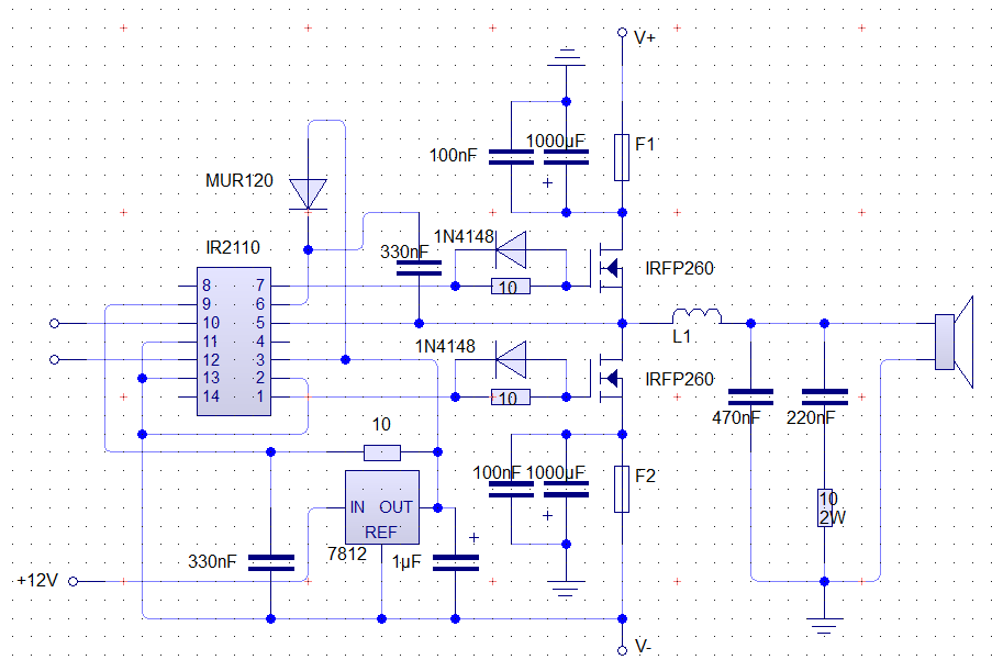

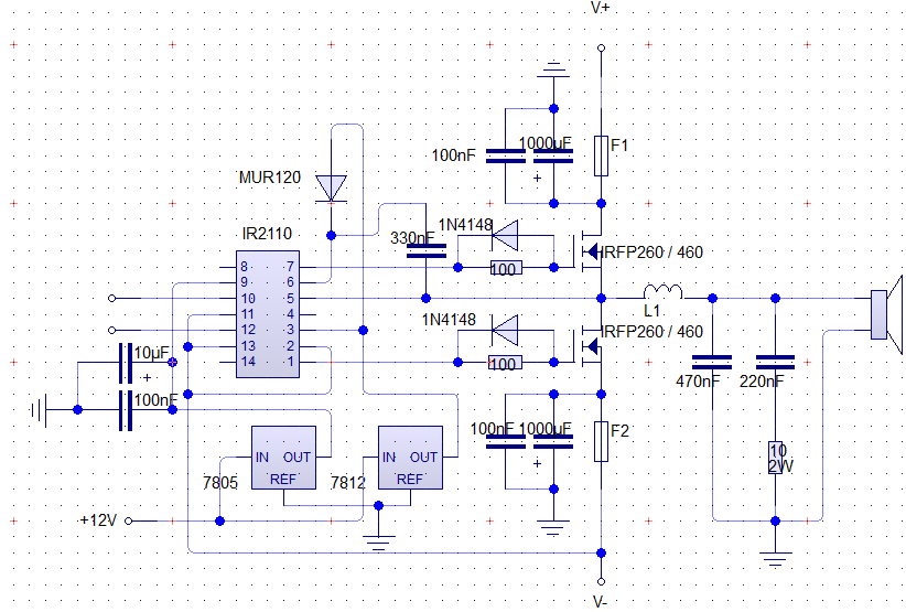

I changed some elements, but i don't understand all because my english is very bad 🙁 (only classes in high school)
I removed 5V, pin 9 is also on +12V referenced to negativ supplay. I will add didoes between gate and out befor L for positive transistor and diode between gate and negativ rail for negativ transistor (1n4744). I dont understand that about bootsrap capacitor 330n, resistor and diode and gnd directly to what 🙂??? Sorry again
Wich transitor and voltage can use
Can anyone draw corect schematic for changes, sugestions on my schematic because i dont understand what sholud i do, I would be very grateful!

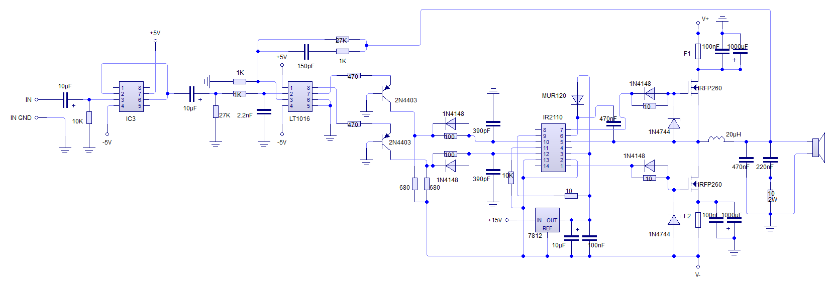

Here I have done all the fixes that you told me
I atached two schematics, first is only IR2110 and second is total schematic of amplifier with LT1016 and TL071 (I can cope with 4070 very well, if someone have better solutions, I'd love to hear)
Please tell me is this corect,if it will work and what i must to change.
the most important is part of IR2110, I hope is coret now, because tomorow I will start PCB and I must know is all coret.
If someone thinks diferent, I would be grateful to coretct my schematic directly on it

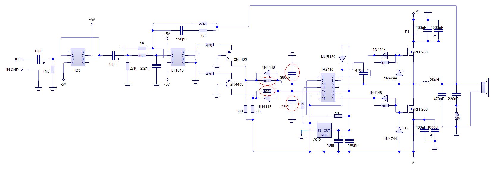

F2 is still not on the correct position. Level shifter must be dimensioned for higher amplification, and you must use much higher R and lower C for dead time.
IC3 does almost nothing.
Soory, can you explane me beeter, i dont understand you, what c and what r??
If I removed F1 and F2 it will be better, or not?
Others on schematic is corect or not? Can it work for 300 350W?
R and C mentioned above are for dead time ( for start use 2K7 and 100pF ).
