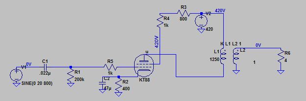

Here is the LTspice models:
I did not put in voltage and power ratings yet.
The transformer was modeled using inductors, it should give a turns ratio of about 1:27. I am modelling an Edcor CXSE25-43k.
https://edcorusa.com/cxse25-4-3k

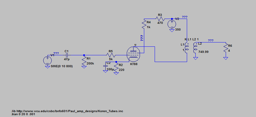

Can you post your circuit in pspice. I could try to simulate it and see if I can make heads or tails of it.
Posted the spice model hopefully you can make sense of it.

Sorry it took so long. I lost the ability to do this at home somehow, so i had to wait to come back to work and do it on lunch hour. I was able to simulate your circuit just fine, except for a couple of errors. Your transformer impedance ratio is backwards. You created a step-up transformer, not a step down. In Pspice you specify the inductance, and the datasheet says 41H for the primary, s I set the secondary to 55mH which is the 750:1 ratio. The other issue is your coupling cap of 47pF is way too small for a 220K load on the other side. I made it a 0.22uF and it works just fine. I also added the 70 ohms DC resistance he transformer datasheet says it has, but it may not matter. When things don't converge in Pspice I add small resistors or caps and try not to have pure inductors and capacitors. there is always some small amount of parasitic stuff in real circuits, and in fact in the semiconductors as well, which are usually the things that cause the non-convergence issues.
So I guess make those changes and see if your circuit starts working, or at least converging.
Multisim seemed to be the one having problems. It wants leakage inductance and magnetizing inductance as parameters for the transformer, which I don't have data for, and the circuit seemed very sensitive to. I have since updated my design in ltspice and it seems to work more accurately. According to my rough loadline calcs and simulations, I should be getting close to a grid voltage input at about 10-15 volts peak before clipping. Does this seem correct?

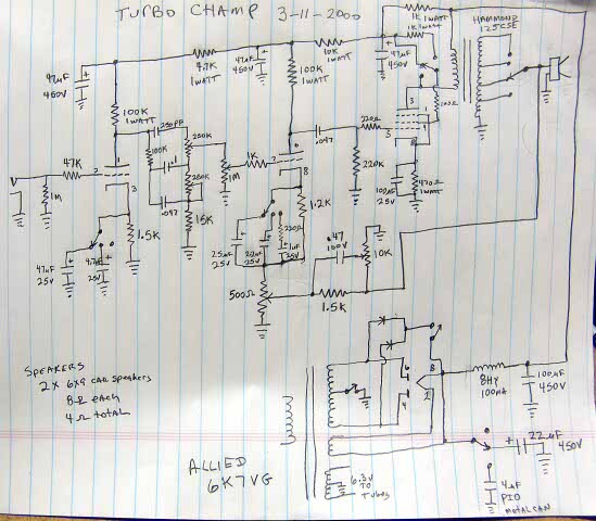

Turbo Champ schematic, how did your decide your value of 2K ohm + 100ohm for the maximum grid resistance?
I assume that you are referring to the screen grid, it's 100 ohm resistor, and two 1K resistors on a switch. If so these were all determined by trial and error. The resistor choices depend on which output tube is being used. I have built "Champ" like amps since the 60's with all kinds of output tubes including TV sweep tubes. For this discussion we will assume commonly used output tubes.
Most of my Turbo Champs during the late 90's used early Chinese or Sovtek KT88's or 6550's. These will work with any resistor value above 100 ohms, and of course the power will go down, and distortion go up as the resistance increases. Some of the early Chinese KT88's would blow up, often violently on a B+ over 400 volts, but these are all dead by now. The resistors should be at least 2 watts.
I also used EL34's. These tubes can all be different, since the quality control as far as grid alignment is concerned varies from batch to batch. A well made EL 34 wants a 1K or higher resistor. Mis-aligned EL34's draw more screen current, and may distort too much with a 1K ,but some will melt down with smaller resistors. Don't go below 470 ohms if your B+ is over 450 volts.
Good 6L6GC's and most crummy ones will work with any resistor over 100 ohms. Chose the tone you like.

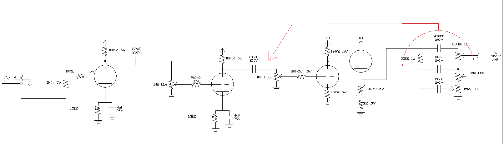

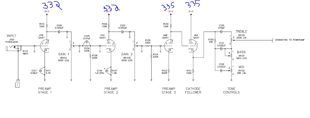

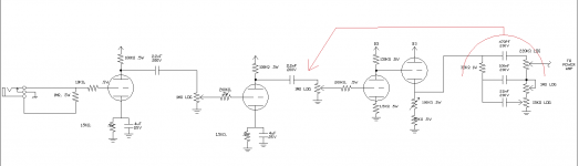

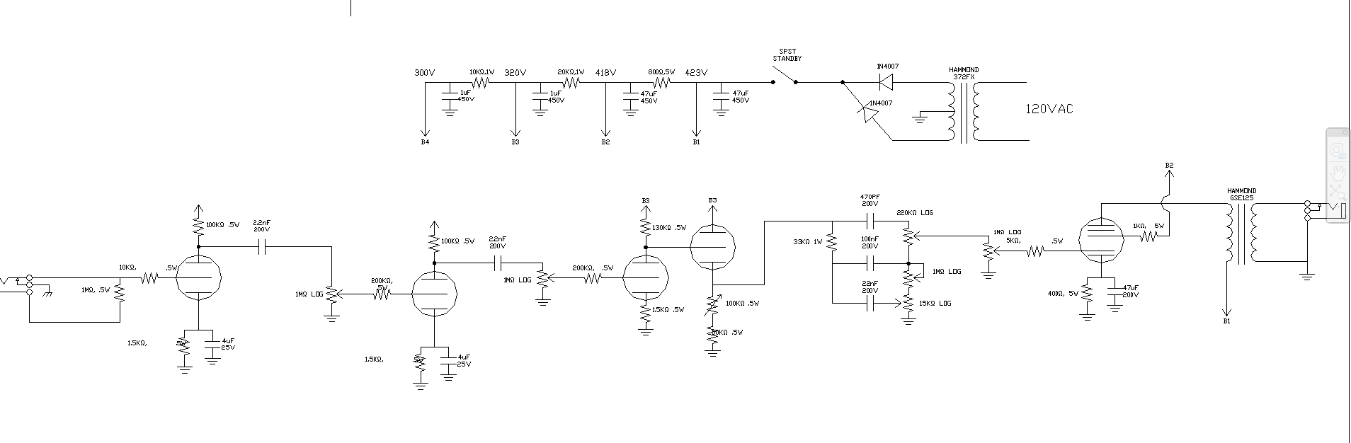

Update To Design, Question on Tone Stack
attached is my preamp design. The preamp is somewhere between an AX84 Lead Preamp, and a Medium/High Gain circuit from "Designing Valve Preamps for Guitar and Bass" by Merlin Blencowe. Tone stack is voiced as a Marshall. My question is to why they have their tone stacks at the end of the of the preamp rather than in the middle like a Champ style amp. I have various 100V poly caps I would like to use where possible.

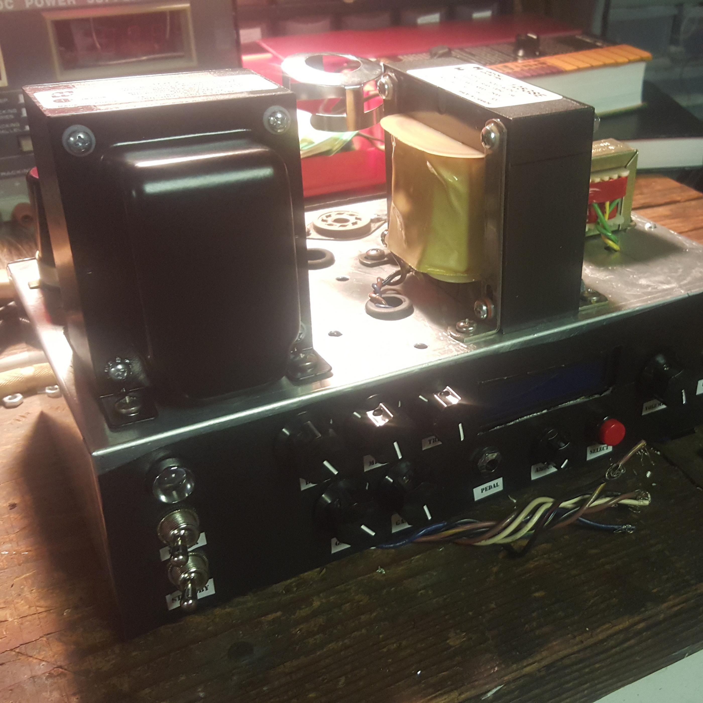

Also attached is the complete tube circuit, and a picture of the chassis build. This amp will be microcontroller integrated for DSP effects. Bifet preamp boosts and clamps to 2.5volts bias for ADC microcontroller input. Also has 5.1 zeners for protection (although this may cause aliasing and I may just reduce the gain a bit and remove them, havent tested yet) Also a Bifet mixer for microcontroller DAC output and guitar signal, Bypass controllable via a 5V signal relay. Will upload digital schematics if anyone is interested.
Thanks!
Thanks!
