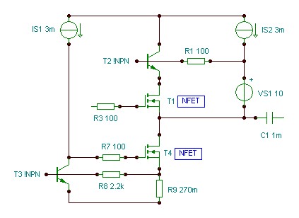

I have made a Class A amp using single mosfet and others using BJT or a Darlington for the only active component.
While it sounds deep and rich...great imaging, transparency and detail...I can't listen long without experiencing listening fatigue...I am not playing at loud volumes. I experience this both when the highs are overpowered by the lows and when the highs are a little bright.
I have been unorthodox in using a switching power supply that switches at a rate well into the GHZ.
Could the switching power supply cause the fatigue?...(the sound of tv's and computer monitors used to drive me crazy)
Or would second order Harmonics play a role in this?
Or both?
I got the THD down to .3% on the simulator ( not the most accurate) and I hear very little distortion...but the ear is not the most accurate for THD...just the most accurate for what sounds right.

Let's see the schematics and the build.

the cure is a decent (big & bulky) power supply.
Regulated or just Bulk caps, and how fast if regulated should the feedback control be for the PSU? any thoughts?
I seriously doubt that listening fatigue is down to the amp itself, unless it oscillates or produces extreme amounts of overtones. Listening fatigue in my experience is usually what happens if you listen to a non flat frequency respons, which is usually caused by room influence, or the speakers themselves. Especially, if you have a peak in the region where the human ear is most sensivite, 2-5 kHz, you are very likely to find it fatiguing, even if this initially might be experienced as "great imaging" and detail.

'Seems from your description to be a frequency response or distortion matter.
Have you simmed the THD100 hz. THD10 kHz distortion? Can you post the plots
with your frequency response plot so that we can see what is actually going on?
BTW, this is your own design but what is the schematic so that comparison can
be made to similar types. The speaker types and other load issues are important
in these elemental designs. Of course, you can't see this by simming a simple
resistive load.

You should take a scope and look at your amp output. My mixer was producing 1 Mhz 1.5 V oscillation out as I was "improving" it, and I really couldn't hear the effect in the short term, but it sure was making the fan on the power amp run like crazy. Who knows what it was doing to distortion, I wasn't running a test quality record, just the FM radio.

Erhm, most poeple above 40 cannot hear 15 kHz anyway.
