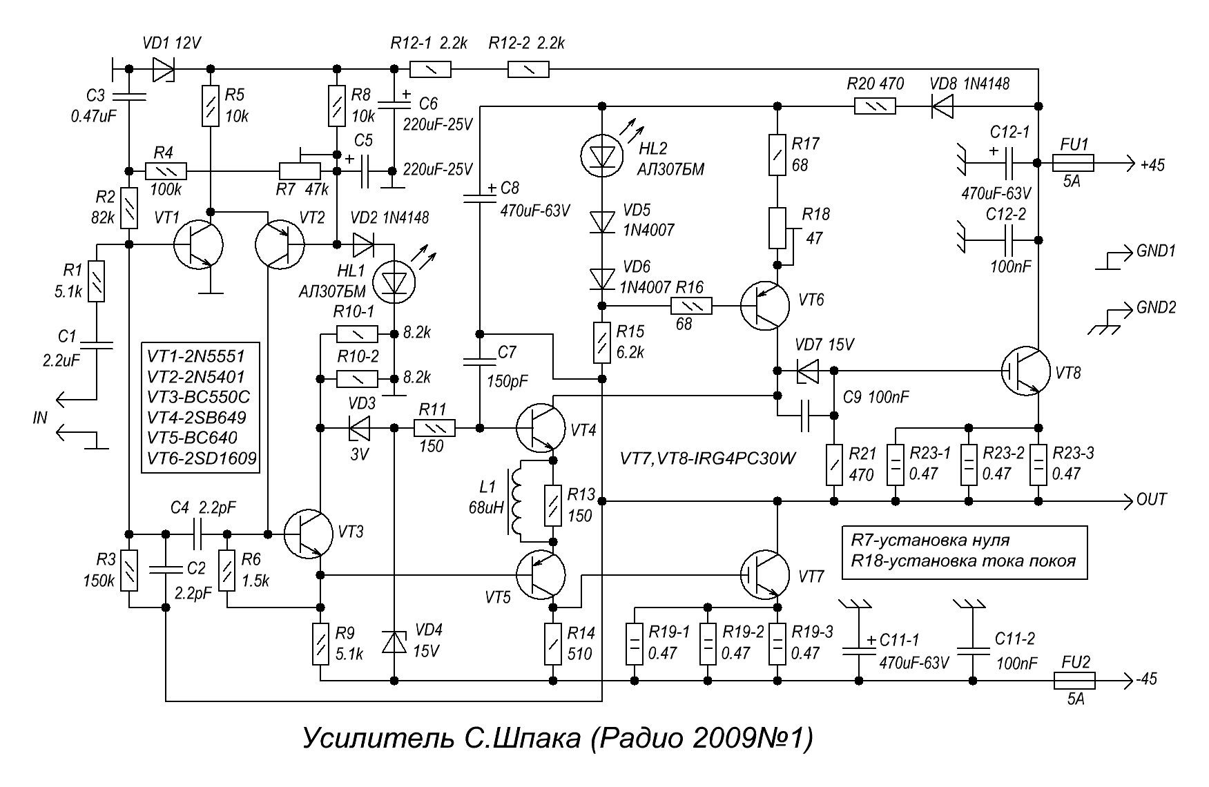

I have now replaced the igbts with mosfets, more exactly IRF3205's.
Schemo:
It seem to sound better now with mosfets, bias current is around 3.6A per channel with an input voltage of about 14V.
