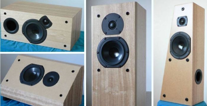

Remember, 300-3000 (or whatever similar range you pick) is just optimal for getting the information across, for intelligibility. Fidelity or tonal quality has little to do with it. I suspect back when they were actively researching the matter, their idea of low distortion was pretty high. Look at the distortion measuring equipment of that era, vs today. No contest. Understanding what a vocalist is singing, vs feeling that the timbre and texture is accurate and satisfying, is miles apart. IMO, even though male vocals tend towards the lower end of the spectrum, the clues that make it real are much higher up. For female vocals, the clues are higher yet, but without the lower registers, reality still suffers. I haven't built speakers in a while, but my experience was that driver quality was everything. No amount of crossover complexity, zobels, phase compensation, little magic dots, or anything else, will turn a bad driver into an excellent one. Maybe improve it, but not to a level I was ever happy with. Unfortunately, really superior drivers have become really expensive these days.
HT speakers IMO don't need the same attention as music speakers as they are usually set to small so don't do below 80Hz, mostly dialogue or steering effects etc.
When designing for HT the main things I consider are:
1. Tonal match of drivers
2. Kind impedance load for the HT amp as these are not flexible beasts for low ohms and their power numbers are over optimistic normally quoting for 2 channels driven and not for 6 channels
3. Run the mid woofer full range so all the main sound is produced by 1 driver which requires a driver with smooth roll offs and no nasties that require corrections
4. Fill in the top with a tweeter
5. Design for location
6. Power handling is lower considering the bass is all done by the LFE through a sub so a large driver is not required
7. If no off-axis viewing then a centre is not required
8. Centre to be a vertical TM
So how does this work in practice? See the pic below (from left centre, fronts, rears, centre rear).
1. All mid woofers are 850488 for the shielded version 850528 (now replaced by 830860 or 832873) but a Vifa P13WH-00-08 would have worked as well.
2. The speakers have an impedance plot from 6R5 to 8R5 which is amp friendly and can be driven by the weakest HT receiver.
3. I run the mid woofers full range and cross over to the tweeter 5000Hz+. This also has a benefit of no xo losses so the SPL is higher than with an xo... less power needed. These have an exceptionally smooth response and roll off so no correction is required.
4. As the tweeter crosses over after 5000Hz with a 2nd order xo, then a cheaper unit is all that is required and I used left overs... SEAS 27TFFC, Vifa D26NC-15-06, Vifa D26NC-55-06, Vifa TC20TD-05-06. All these tweeters have an Fs between 900Hz - 1500Hz (even the D26NC-55-06) so the high xo is beneficial.
5. Each speaker has been designed for the location. Fronts designed to go next to the plasma screen (do not have fronts too wide apart for HT as you need to lock to the screen). Centre fits under the screen and tilts up to the viewing height. Rears sit behind a sofa and fire sideways into walls with gives a null at the listening location and relies on reflected sound. The centre rear fires upwards to the ceiling and back wall relying on reflected sound.
6. No bass to do so a 5" driver is more than adequate. These little suckers can take heaps with an xmax of ±4mm and 110W capacity.
7. I allowed for off-axis viewing by adding a centre but can get away with phantom sitting on-axis.
8. I couldn't quite get a vertical TM due to the height restriction but it's very close.
So there you have my take on good clear sound for HT without breaking the bank.

rabbitz said:1. Tonal match of drivers
This is not to be underestimated... really the front row should be covered by the same drivers thru the critical range.
