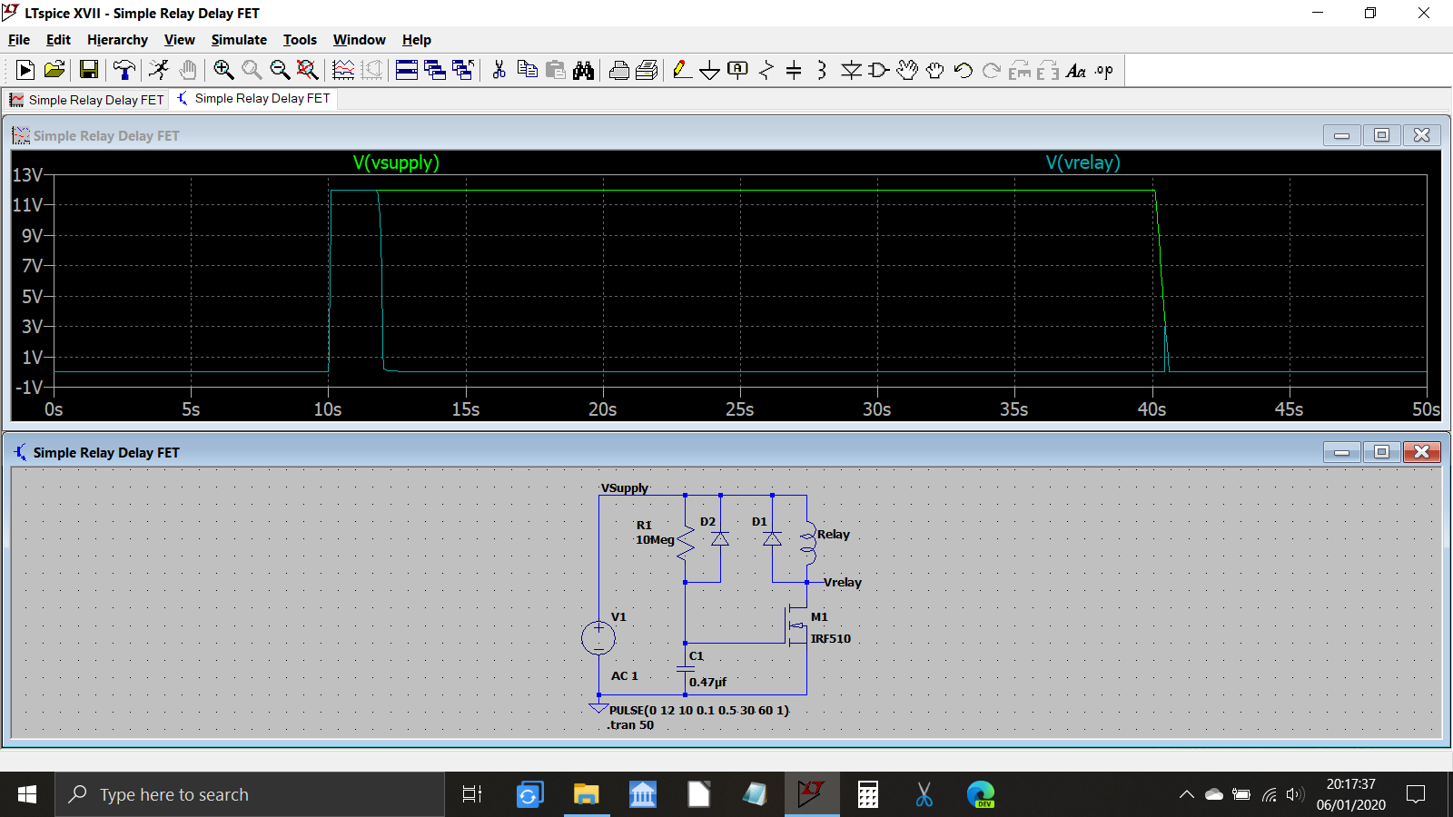

This is a very simple circuit using just one power FET (a small 2N7000 type is ideal as well... its not critical) and the circuit could be powered from the AC heater supply via a bridge or a single half wave rectifier and a small reservoir cap to ensure the relay drops out smartly on power off.
The delay can be set to pretty much any desired value by playing with the time constant of the R/C network. Electrolytics are fine if you ensure R is low enough to swamp any leakage.
The circuit is not ground referenced to anything in the amp and can float. The relay contacts are normally closed and short the audio to ground in the mute condition.
This shows the supply rise and fall and the relay operation.

No. It won't protect from power glitches, it only delays B+ at power on. The protection from power glitches was however not mentioned, it's a second feature.
At power on, it turns on the relay after some delay. The relay is used to short the outputs rather than to switch the supply.
At power off, the relay switches off quickly because the capacitor C10 in parallel with its coil is quite small.
During power glitches, C11 may not discharge fully, so the delay after the power comes back on will be shorter than it usually is. Then again, if it is a short glitch, the tubes will still be warm anyway, so who cares? Note that grid conduction of the ECC81 helps to discharge C11 quicker than it normally discharges, so if you want to reduce the discharge time constant during power dips, reducing R11 and R12 could help.
