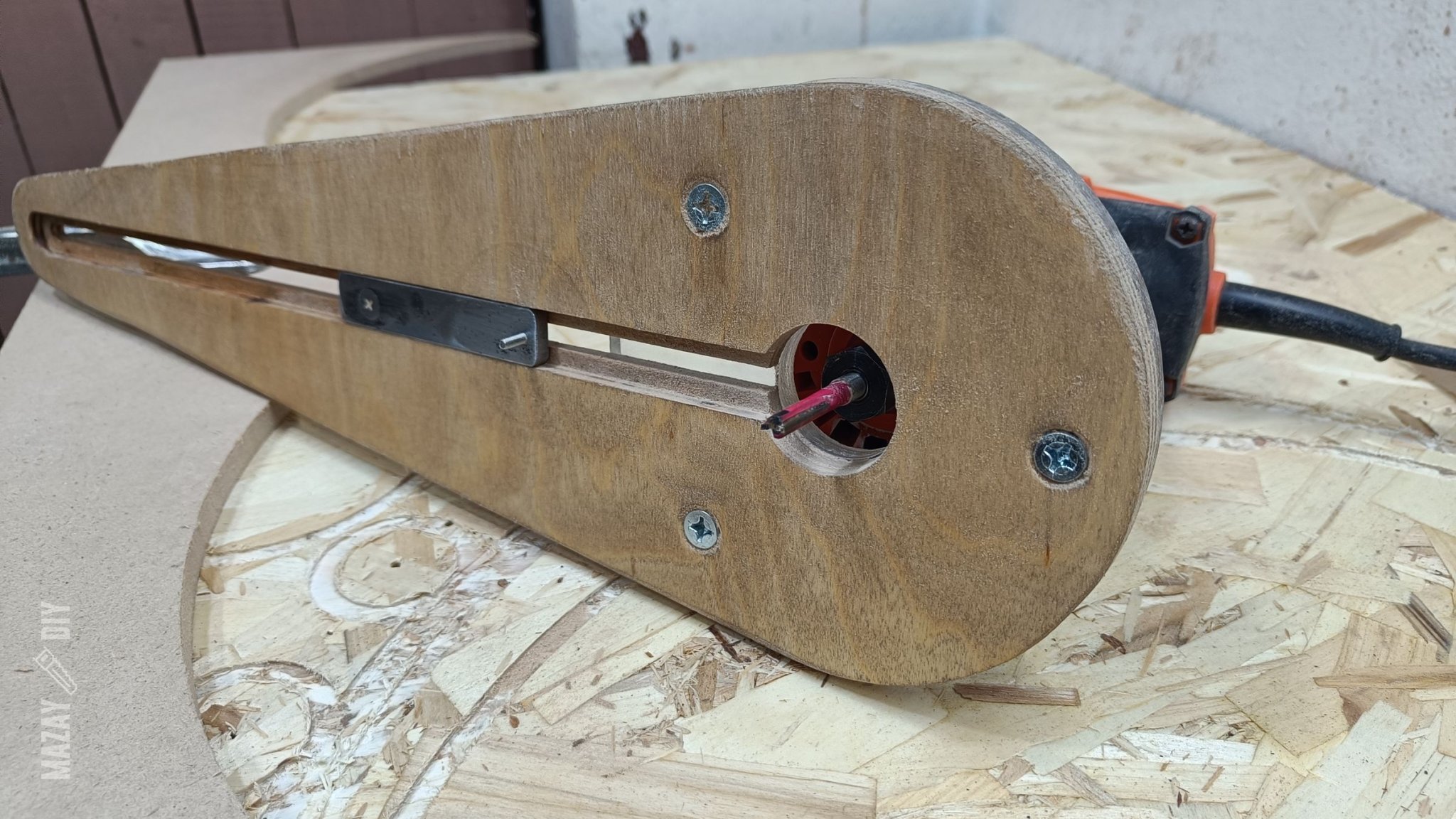

Nothing to do with me but this came up when I was looking for an image of the circle jig I copied for my router.
My jig is similar to this one.
Worth mentioning, do not forget to secure the round piece you are cutting to your workstand with double sided tape for instance, otherwise when you apply the last cut, your jig is not secured any longer and the router will shift outward to dent the circle you just made.
I built something like this long time ago. Never let me down, I get to sub 0,5mm accuracy if I'm not too lazy. The material is ply with phenolic top coat, used for concrete moulds. The one in the link has smart adapters for a routing guide (for copying, don't know the English term) from most bigger brands, you don't have to attach the router to the jig and the router doesn't circle with the jig.
