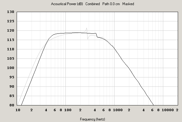

Here is about what you can expect with 80 liters (plus a little more for wood) with a 32Hz Fb (box tuning)
near Xmax:

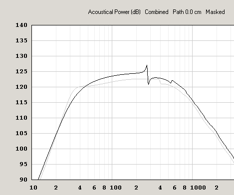

Going to 140 liters gets more bottom with less power (about 522 watts compared to 722watts):

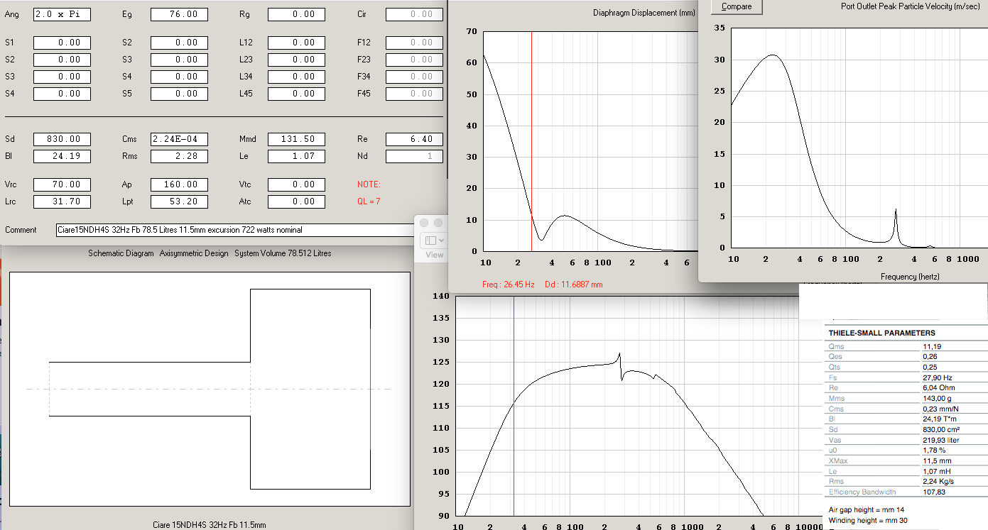

The Hornresp input screen shown in Art's (Weltersys's) post gives you the vent cross sectional area as "Ap" and length as "Lp"; so 160cm^2 = 14.27cm diameter, and 53.2cm long. That will assume "standard" end correction, meaning it's valid for a port having one end flush with the outside of the box and the other end well away from any internal wall or panel inside the box.
As you will find if you do any modelling yourself, tuning a small box low very rapidly results in a port that is long relative to the box dimensions. This may require bending the vent, changing to a corner or shelf style vent or even moving to a passive radiator instead of a vent.

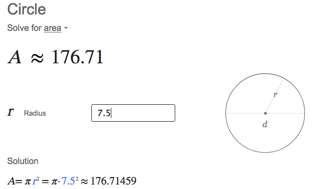

If I calculate 90l/35Hz, with port diameter of 15 cm, I get a length of app 37 cm.
I guess, I just re-calculate the area of the port, and re-calculate the square are of the slot.

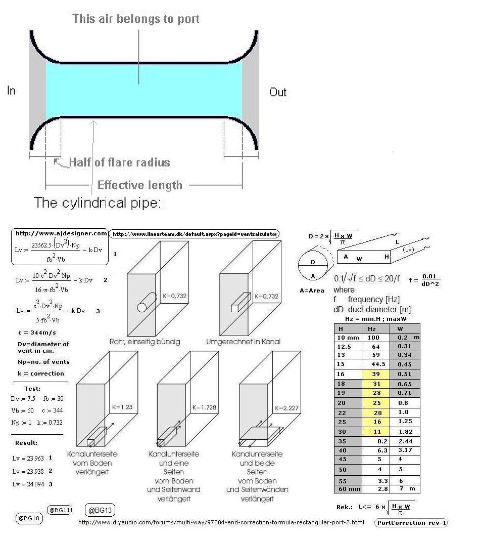

A higher aspect ratio (wide, thin) port will tune a bit lower than a circular port of the same length.

Port end correction factor “K” value increases from a standard value of 0.732 when a port is not located some distance from cabinet side walls. When a side, or sides of an enclosure are used as a port wall in square, rectangular or triangular ports, the port length is effectively made longer by the additional mass of air adjacent to the walls, so a port centered on one wall has a higher “K” value than if it were away from all walls, adjacent to two walls, higher yet, three walls still higher.
