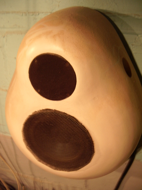

These are about 15 years old. I can't remember the exact model numbers, but the tweeter is a Vifa dome and the woofer is 6.5" Peerless CC. Both are flush mounted, with the curvature of the baffle tangent to the flange edges for zero flat surface, even between the drivers. The tweeter is covered with fabric, the woofer with 1/4" opening wire cloth. Xovers designed by Madisound. Enclosures are built in a manner similar to yours out of stacked cutouts of 3/4" particle board and plywood, with a flat back. The imaging is excellent, with a decent depth of soundstage, even hanging against the wall as shown here. They are ported, but bass rolls off pretty fast below 100hz, so I use a sub with them. These now reside in the workshop: the streaking is sawdust.
I believe diffraction effects from sharp baffle edges play a very large part in making good drivers sound not so good.
