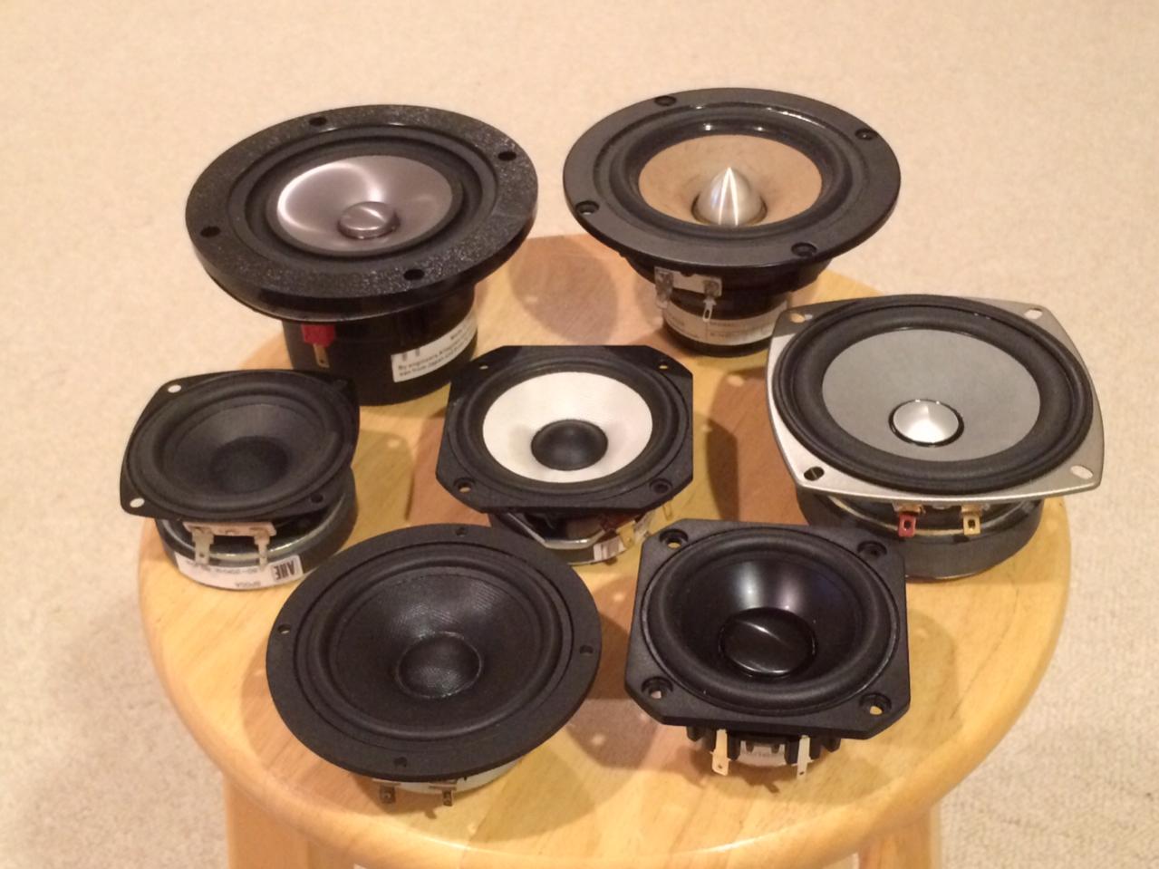

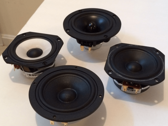

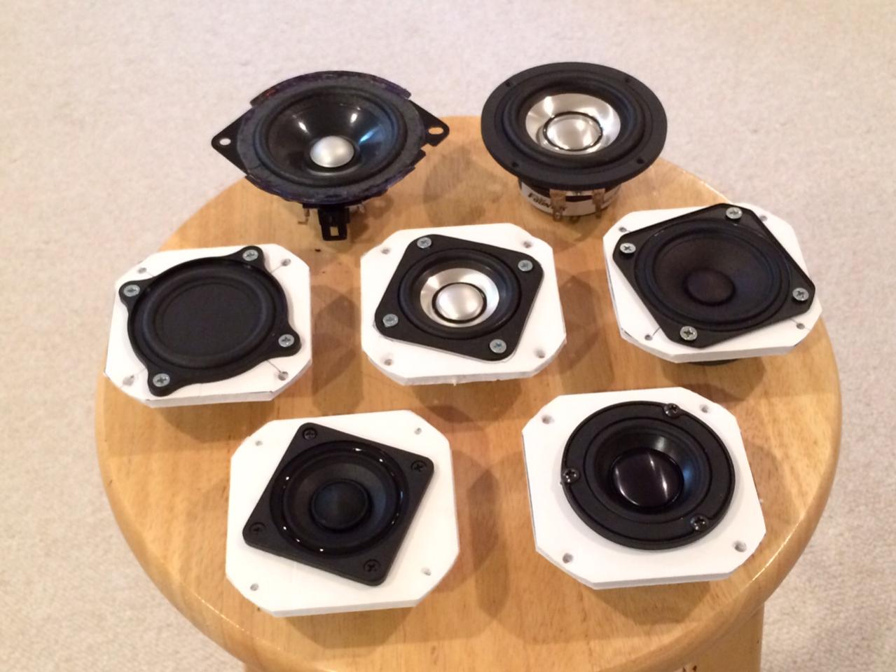

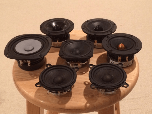

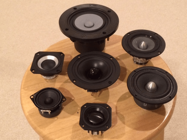

3FE22-8 is also excellent full range. It’s one of many that I tested in a blind virtual audition. B80 and 10F/8424 were also highly rated. A very good budget driver is the TC9FD and its fiberglass brother the TG9FD. A surprise entry that did very well is OEM car driver from Jeep! It’s got a funky bezel meant for a car but many people on DIYA voted for it.
These threads contain sound clips recorded under identical controlled conditions.
