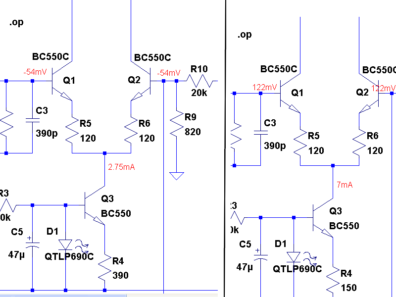

Yes 2ma is a common choice, as higher the current LTP, higher the NFB, but a very high current in LTP more largest DC in base of TRs (BJTs) which increases the noise.
A current mirror doubles the transconductance in LTP, 2ma with a resistor is same as 1ma with current mirror. In my humble opinion, one LTP degenerated into 100 ohms with BC550/560c, max 3,5ma (~50mV on base of TRs).

Hi Andrew
I put an Fig for explain what I was saying, because my English is not good, also forgot to mention that DC is dependent on the impedance of the amp.
The recommendation to keep =<50mV is in the book of D.Self for avoid noise Jhonson (Cap: Small Signal).
