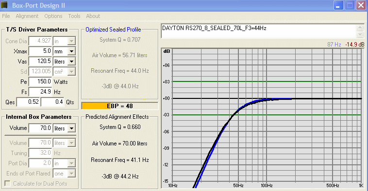

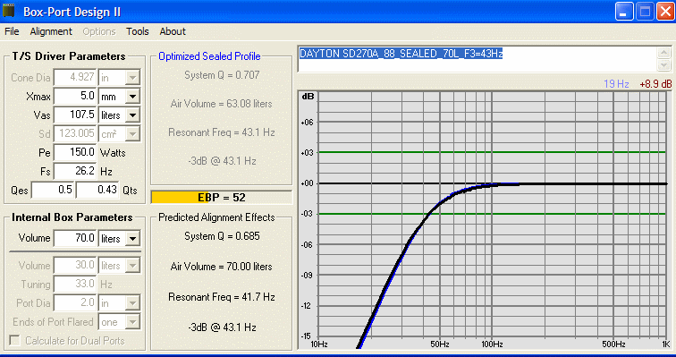

The bass is too slow, so I want to explore the possibility of changing the drivers.
Consider these 10" drivers from Parts Express.
1) Dayton RS270-8 (8 ohm)
2) Dayton SD270A-88 (4 ohm - dual voice coil in parallel)
They will give you the dynamics that is currently lacking. All you need is one unit, do not use "Clampshell" design.
Play some music and adjust your crossover for the best mid-bass and low bass. It should be somewhere between 75Hz to 100Hz.
