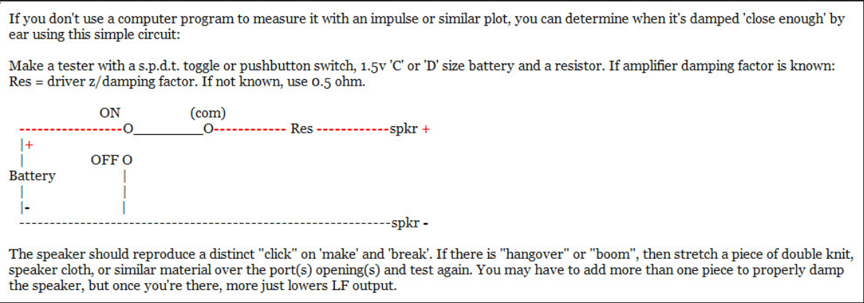

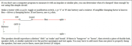

FYI, etc., IME maintaining the net Vb and tuning can/will in theory be a bit higher due to less 14 WL pipe action damping it; if so, then increasing stuffing or better still, critically damping the vent will smooth it back out and then some if doing the latter plus moves it closer to a sealed alignment's superior damping (Qt).I expect this won't be possible, but could the box be made shorter and if so would the port size and length need to change. Sorry don't know the tech to work out if it's viable, hoping Dave or Scott could advise, thank you.

GM means technically you can, providing you maintain the same overall internal volume (Vb). However, because it's a quarter-wave design, shortening the line length will raise the tuning frequency, which will put a peak at the new tuning frequency. This can be fixed by damping the vent: the easiest way of doing that is by using the old click test method he attached, which is still probably the most effective practical way of dialling in an acoustically efficient box load.Wow, could I have that in English please, only got some of that.![]()
